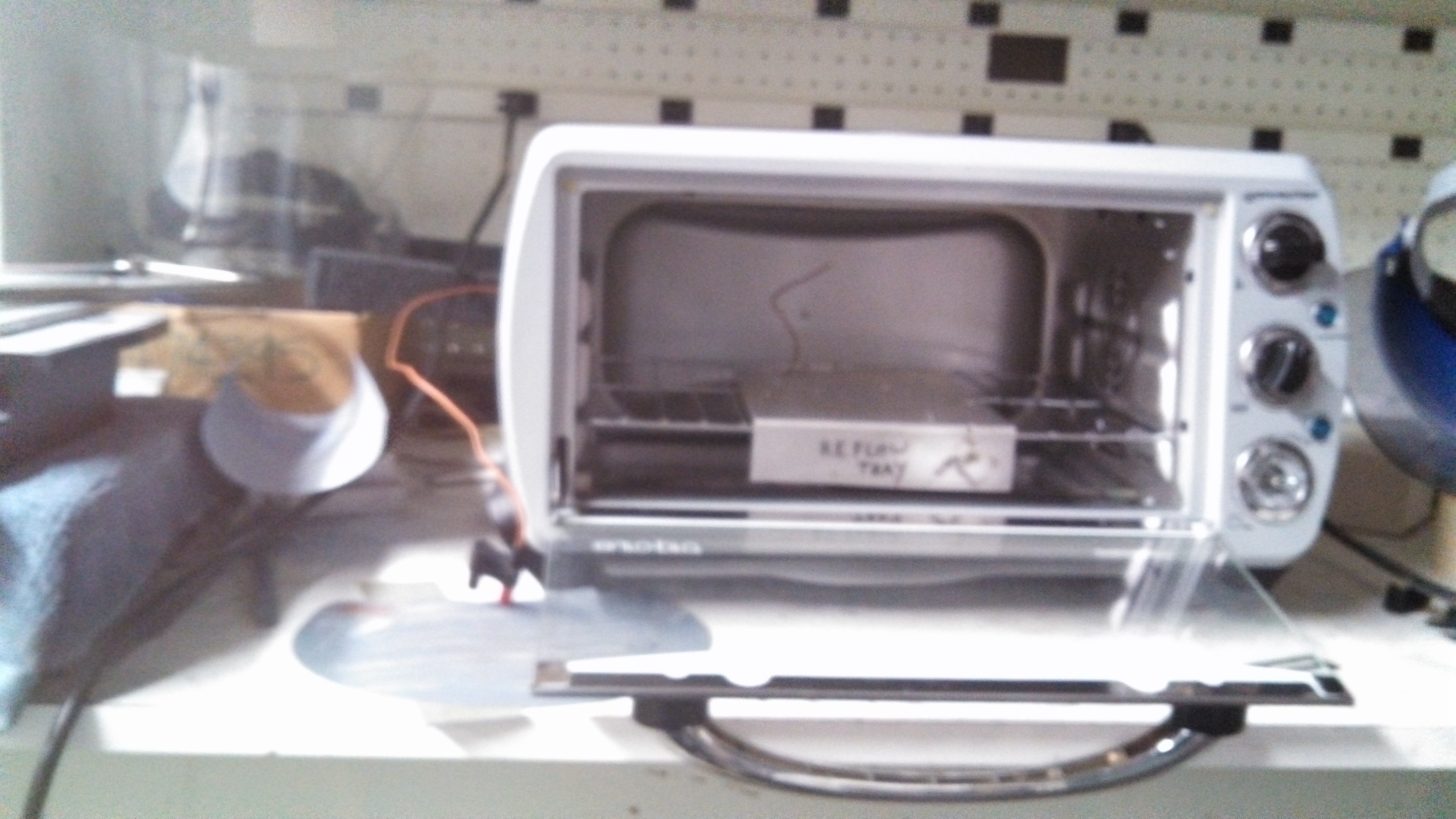

Guest Canyoncruz Posted May 8, 2014 Report Share Posted May 8, 2014 I use a toaster over. In fact i brought it to work because our RF guys need to troubleshoot and swap out parts on the PCB's here. What we did was profile the temp with the setting, We the oven I brought in ($39 during xmas) w set it full on Broil for the soak and then switch to broil and watch a sample next to the PCB, when it gets shiny, we turn it off and slightly open the door. Works like a charm. Good to have some eye balls when syringing the paste. Also, we have found with some of the really dense lead on opamps etc. it is better to solder the device instead of the pcb and then just stick it on. You do have to watch for solder balls, . they need to be scraped off. A dental pick works fine. Now we just do it regardless if needed.I can give to the make and model of the toaster over so you dont have to characterize. Quote Link to comment Share on other sites More sharing options...
Guest Canyoncruz Posted May 8, 2014 Report Share Posted May 8, 2014 If you want to get fancy, there is an Seeduino control. you need to buy an SCR and a thermocoupler. The software is free. and you have to open the oven up Quote Link to comment Share on other sites More sharing options...

Guest Canyoncruz Posted May 9, 2014 Report Share Posted May 9, 2014 Euro-Pro Model TO161 Quote Link to comment Share on other sites More sharing options...
Guest liquibyte Posted May 9, 2014 Report Share Posted May 9, 2014 Only place I found one was on overstock for $42.81. Not too bad really but it was the only place that had stock. Quote Link to comment Share on other sites More sharing options...
Guest Canyoncruz Posted May 9, 2014 Report Share Posted May 9, 2014 we have all the data to operate it poor man's way. It would say you additional time. Or you could go the Arduino / seeduino route and modify it. Quote Link to comment Share on other sites More sharing options...
