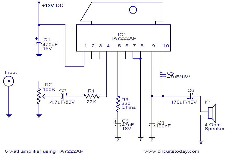

Hi all, haven't been in here for a while. I have built a 12VDC telephone intercom system that works fine. What I'm trying to achieve is connecting a amplifier to the phone service line so that the conversation can be heard without using the phone handheld. I have built a 6w amp from a schematic I downloaded using a TA7222AP amp chip (Schematic Below). I'm a little lost with this: For optimum performance input and output must be separately grounded. How can this be? What am I missing here? How can you have 2 different grounds?

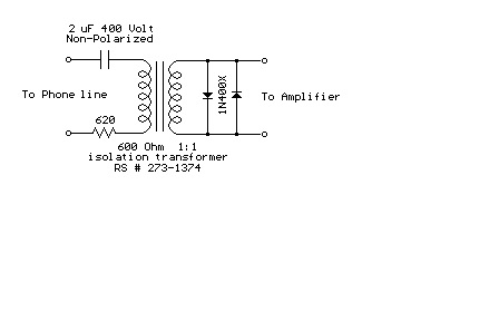

 The input: I tried a 600ohm TA and tried hooking it direct...no go. What am I doing wrong here? Help! Suggestions...!
Thanks,
Cory D
6W amplifier using TA7222AP

  • For optimum performance input and output must be separately grounded.

Of course the input ground pin 7 and the output ground pin 8 both must connect to 0V on the power supply. But if the pins are connected together and a long wire connects them to the power supply then the variable high current from pin 8 in the resistance of the wire affects the 0V on pin 7 which adds distortion and might cause the amplifier to oscillate. Use separate ground wires.

Thank you for responding, Audioguru. So the ground on pin 7 and 8 should be separate to the source 0V? So if both grounds are separate, does the distance still have an effect with distortion and oscillation?

I'm going to try this circuit (Below) to signal the amp from the phone line. I don't have the components yet to build or even try it. I have the 600 ohm TA and the diodes...but the 620K resistor is not in stock at any of the local electronic stores nor the CAP. Both are on order. Do you think this will work. I have 3 other schems that is used for this application. This one has less the components. Your input?
Phone_Line_to_AMP_connection_circuit_01.
