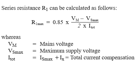

Claudemir2019 Posted September 30, 2019 Report Posted September 30, 2019 I plan to build an engine speed controller, but in my city 127 volt power is provided.http://www.electronics-lab.com/project/ac-motor-speed-controller-using-u2008b/Is it possible to modify this project to 127 volts version?This project would suit me perfectly!Thankful! Quote
admin Posted October 3, 2019 Report Posted October 3, 2019 According to the datasheet you can calculate the series resistance R1 using the formula below. This way you can use your desired voltage on the input. I don' t think you need to alter any other component. Quote
Claudemir2019 Posted October 3, 2019 Author Report Posted October 3, 2019 Thank you very muchI will try. Quote
