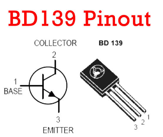

BD139 NPN
A Bipolar NPN transistor like BD139 is available in the SOT-32 plastic package. This kind of transistor is used in different electronic circuits because of less cost and high collector current. This transistor can drive upto 1.5A loads like motors, high-power LEDs, relays, etc.

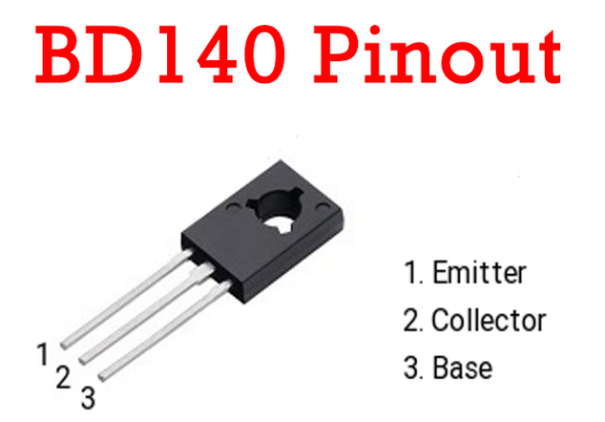

BD140 PNP
The BD140 is a medium-power bipolar junction PNP transistormainly used for audio amplifiers and drivers utilizing complementary or quasi-complementary circuits. It is made up of silicon and comes in the TO-126 package. The PNP types are BD136 and BD140, and the complementary NPN types are BD135 and BD139.
The BD140 can handle current up to 1.5A so that it can drive loads up to 1.5A in electronic circuits like high-power LEDs, relays, motors, etc. The BD140 also has a high collector-emitter and collector-base voltage of 80 V. Its minimum saturation voltage is -0.5V. Moreover, the collector dissipation of BD140 is around 12.5 W hence it is ideal to be used in audio amplifier circuits.

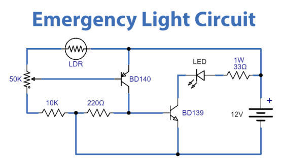

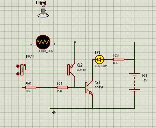

This circuit will turn on a 1 W LED when there is no light on the LDR face. Circuit operation depends on the change of LDR (Light Dependent Resistor) resistance. After completing the circuit, when the LDR is exposed to a sufficient amount of light, its resistance decreases. This then causes the voltage at the base of the PNP transistor to also drop.
When the LDR is exposed to a dark environment, its resistance increases, causing the voltage at the base of the PNP transistor to also increase. This voltage acts as a control signal for the BD139 NPN transistor, which triggers the output LED connected to a 33Ω 1W resistor. The control signal at the bottom of the PNP transistor can be tuned using a 50K potentiometer.
