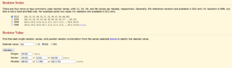

So I drew up a table there are:
19 x AD8657 , 5 quad-op-amps of the same spec in dip package two sets of two, five sets of three
3 x ADA4096-2 , 1 quad-op-amp chip again with the same specs one quad
3 x LT1637 , 1 quad-op-amp chip again with the same specs one quad
5 x LT6015 , 3 dual op-amp chips with the same specs one dual one quad
3 x OP282 , 1 quad-op-amp chip again with the same specs one quad
11 x LT6220 , 3 quad-op-amp chips with same specs three quad 1 dual
I need them all through hole in dip packages!!!

capacitors values and which types to get perhaps I can buy a pack with all of the valuse needed, I really don't want to be mixing values?
all values are in nF
100 x20
91 x2
82 x2
56 x2
62 x2
51 x2
33 x2
39 x2
30 x2
20 x2
18 x2
24 x2
13 x2
15 x2
12 x2
8.2 x2
9.1 x2
6.8 x2
5.1 x2
5.6 x2
4.3 x2
3 x2
3.3 x2
2.7 x2
1.8 x4
2.2 x2
1.5 x2
1.3 x4
1.6 x2
1.2 x4
1.1 x6
1 x6

ok thank you for the tip because it has taken me litteraly hours to get the resistor valuse from E12 mixes I'm hoping that I don't need to mix capacitor values too I need to know which type of capacitor to use do you know what would work this project is big because the doubled up resistors and the capacitor add up to 384 passive componets and thats excluding the buffers and pre-amp and enveloping circuit or the quad amps and lm3914's, it's no bother though, but it is a lot of work!!
