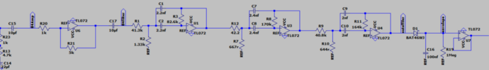

Can I use the same model of the envelope detector, ie, the BAT43 and the 100nF cap and the 1Meg resistor, (just checked 7000Hz and it works like a dream, so I'm nearly done here and I shall build it;
just simulated the highest frequency and changed the variable resistor R23 to 1k also, I'm not sure about this, hence asking, the outoffilter signal is amplified from the B4filter and I thought that there was no gain in this design, whats with that? 1702486685606.png1702485926697.png

wait a minute if I'm not supposed to be changing the R23 resistor because its before the amp and I'm only making one of those but then when run with the 165k the 7000Hz tops out at 10.5V!1702488446323.png

Hello,
Do you still use the attenuator at the source?
The gain at higher frequencies can be caused by in series with R13, the 22 uF capacitor C14.
Also C15 and C17 of the amplifier are frequency dependend.
Try to adjust the 45 Hz version for max output by raising the value of C15 and C17.
Also have a look at the value of C14.
Bertus

So I'm looking at it but not sure what I'm looking at I'll open the 45Hz version like you said and do I raise them in stages of 5 do these two caps C15 C17 have to be equal??

Hello,
Yes, the values of C15 and C17 need to be the same to have the same effect on the frequency.
I see an other solution, Raise R20 to 100K and R21 to 500K and see the effect.
The capacitors would have less prone effect on the frequency in that case.
Bertus

what and then run both the 45Hz and 7000Hz and look at them?

Hello,
Yes, that way you can see the effect on low and high frequency.

actually much much better just need a tiny bit more, needs to come down about another half volt but on the other hand it is NOT clipping so this is goood, no I take that back that was before the filter after the filter there is still massive gain just to clarify this is the setup for all af the filters passband = centre / 4 stopband 2 x centre1702491489484.png

so I have not tried changing the R13 or cap C14 yet any suggestions as to what I should set these at to change the outcome, I tried 1uf and 2200uf and there is no major difference to be honest

They both centre about 0volts the signals are from the signal generators and are in green!!1702494174069.png

the 45Hz one out of the sig gen is at the top 46millivolt the 7000Hz one out of it's sig gen it 76millivolt And I think this is the culprit

what do you mean by in series with (R13 and 22uF, C14)

Hello,
Now you have R13 at 4K7 and R23 at 165K.
Change that to R13 at 27K and R23 to 1Meg and see what happens with 45 Hz and 7000 Hz.
With those values C14 will have a factor of 6 less influence on the frequency dependend gain.
