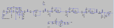

this shows the place where I put the, out of the filters
this shows the ammended resistors

complete circuits yes changed the resistor R20 and R21!!

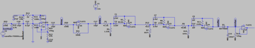

nope not yet still tops out I hope you have not exhausted your ideas:) thanks again for helping this is the last part if we get this running for the lowest frequency and the highest frequency then the middle frequencies should work.1702501313757.png

No but the highest peak now reaches 9 volt instead of the prefered 8.4 so it has adjusted it slightly, I think we're getting somewhere!
I don't know if this helps but I want to remind you that the circuit worked as desired when R13 was 4.7k and R23 was set to 1k but thats not acceptable because I want the one pre-amp and amp for all of the filters!

It's not even dipping look at the time on the 45Hz and when the peaks and troughs there are no troughs on the 7000Hz analysis1702504304446.png

The 7000 Hz file seems to be an older version, I needed to change the following:
C12 = 10 uF
R23 = 15 K
R13 = 27 K
C15 = 10 uF
R20 = 100 K
R21 = 500 K
C17 = 10 uF

simulating this looks good! so now will this pre-amp and amp be good for all the frequency filter I will simulate one in the middle of 45Hz and 7000Hz and see what it's saying thank you very muchly

so it ran and it's really good for the 7000Hz it reaches 8.4v on the envelope detector But for the 45Hz and the 8th filter on the list (474Hz) they both only reach to a maximum of nearly 6.1 volts but at least now they are all showing on the chart now!!! definatly getting somewhere!!1702547298282.png
