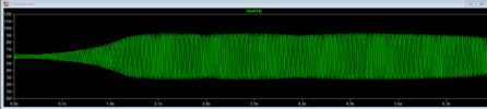

Maglatron
Jul 12, 2023
2,025
Jul 12, 2023
2,025
correct? this is the output so I think I have it wrong again this is the wave output1702325376830.png
Maglatron
Jul 12, 2023
2,025
Jul 12, 2023
2,025
so now its centered about 9v and not 6(I want it centred about 6v
bertus
Nov 8, 2019
3,877
Nov 8, 2019
3,877
Hello,
Now you can adjust the gain of the preamp to get the wanted outout.
Bertus
