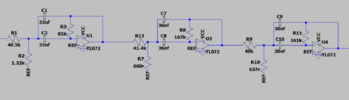

Hello,
I found the failure. In the 7000 Hz filter R12 was 43 Ohms in stead of 43K.
Now R13 can be adjusted to 820K and I get a peak of 7.4 Volts for the 7000 Hz filter:

so you know here there are some arbitrary numbers do I just round them to the nearest whole number of resistor that is in the kit of resistors or sholud I mix the values to arrive at the correct values??? intuition tells me to mix!1702744446667.png

Hello,
Here is an example with E24 resistors for the 7000 Hz filter:
This will reduce the number of values for the resistors.
