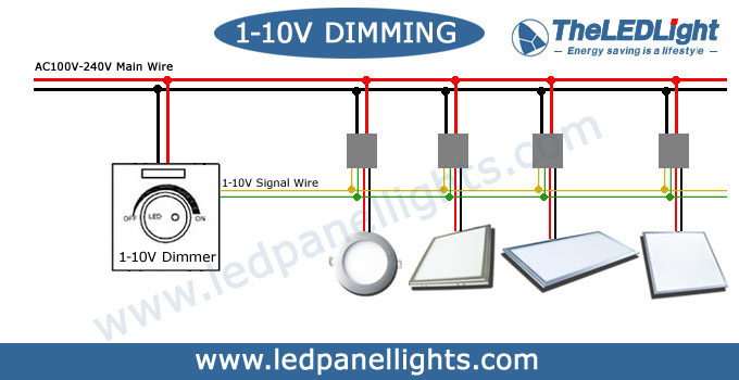

I still don't understand the whole picture... The manufacturer (in China) of the driver uses such scheme:
where potentiometer/dimmer is fully connected to AC (both L and N). Here (above) it is possible to measure 1-10V signal with voltmeter.

I don't see any difference between the Chinese (driver) and German (controller) systems. The Siemens controller simply has the series On/Off switch included, whereas the Chinese driver circuit does not show an On/Off switch. The driver says it can be controlled by 0-10V and the controller says it supplies 0-10V, so there should be no problem.
If the drivers are powered and the controller is not connected to the drivers, they should light the LEDs 100%. Do they?
If the controller is powered and not connected to the drivers, it should supply 0-10V. Does it?
Colin's suggestion to bypass the controller's On/Off switch and try controlling with batteries seems another sensible test.

You comment in the original post that
Siemens potentiometer cant accept N as I know.
and, as you note, it is not clear which standards this equipment complies with. In "E1.3, 0 to 10 V Analog Control Specification." the control signal wires should not be connected to the AC mains. The only circuit I have found for the 5TC8424 is certainly incomplete and may be purely symbolic, but it shows it as a simple switch and variable resistor - in which case it would not output any DC voltage! If it does indeed output a 10V signal, then it must get power from somewhere and the drivers are not generally required to provide power, so I think the N connection for the Siemens controller might be derived via the load circuit (the driver). To obtain a 10V output, you would then need to connect a LED driver module as shown in the Siemens diagram.
In this document http://tsp.plasa.org/tsp/documents/docs/Guide_E1-3.pdf section 6 has a few comments on testing and one suggests that you may need to connect a load of 10 - 100k to the output (0-10V output) when measuring the voltage. Colin's suggestion of using batteries is also mentioned.
I haven't been able to track down any documentation on the CM-40VAHD900C. I wonder if you have any other info? (I did wonder if there are any other markings under that label which is peeling off - perhaps you thought the same!)
I should add that I have no personal experience of these devices and my comments are based simply on what I have gleaned from your documents, others I've found and on basic electrics.

I have "solved" the problem by buying MeanWell LPF-40D-48 power supply which supports "passive" or resistance dimming. The problem was that Chinese power supply needed a real 0-10v while Siemens is just a simple potentiometer which doesn't provide it. It just change the resistance. BTW, MeanWell supports three types of dimming.
I still didn't test Chinese driver with the battery but I will try it one day and I believe it will work then :)
