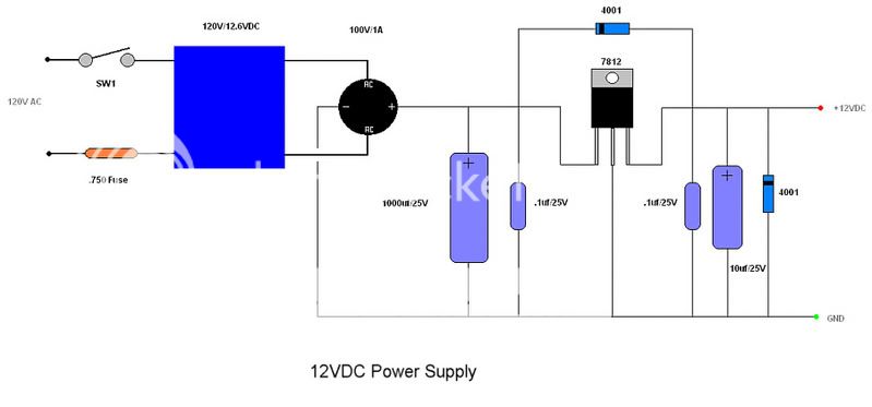

"very quickly" cannot be measured...
I would like to duplicate this feature on the link below.
My digital timer module will not work properly unless i have the "very quickly" feature!
The below link is the supply i am trying to use for a timer circuit but the decay on the output is creating havoc, i tried a 50 ohm shunt across the output it does help but not flawless like the 0-30VDC stabilized supply when adjusted to 12V.
If possible, please be specific as to how it may be performed.
Additionally, i understand if it is not possible etc...
Any help would be appreciated.

The 7812 doesn't have an on and off control. An LM317 voltage regulator could have its ADJ pin grounded by a comparator when you turn off the power which would quickly reduce the output voltage to about 1.3V.

Actually, if i spend the time i can get the posted pic (12VDC) circuit to simulate the clamp as designed on the 0-30V stabilized supply.
I was hoping someone had already designed a working model...
Your theory would not work in my situation since the LM317 would still produce a decay when power is turned-off, the timer circuit i designed will only draw 200mA of current when power is applied.
The latter circuit will also operate slightly below 4V at which time the extremely low current relay disengages.
Circuit current consumtion in today's digital designs are very low.
When a worst case scenario is applied such as power-on/off/on applied at both AC and DC levels digital design can take on a whole new meaning!
Although, i thank you for your concern.
-Omni
