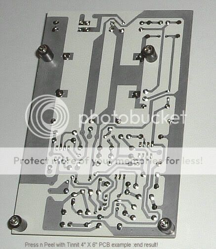

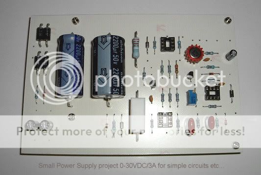

The original design will operate perfectly, i have completely tested the 0-30V supply and feel it is one of the best i have ever used.
I fabricated my own PCB using the internet supplied artwork along with PnP.
The only addition i added was a digital voltage & current meter; link provided.
http://www.hobbytron.com/UK203.html
I ordered all the parts for the supply from Futurlec, their prices are excellent!
The enclosure is a ventilated Bud (champion series).
http://www.budind.com/pdf/hb11202.pdf
Furthermore, the green (stock) 7-segment LEDs were replaced with Red since i fabricated the front panel enclosure out of dark red plexiglass.
However, you could also use a dark green plexiglass and use the stock LEDs.
(the Digital I & V meter uses stock green/yellow LEDs)
Plexiglass can be purchased in very small sizes from ebay, be carefuly when drilling, do not attempt to immediately drill a large hole (.25) above, start very small and work your way up.
Plexi has a tendency to grab the bit and a crack will easily occur (drill very slow), no pressure!
I hope i can get some time to post a few pics; perhaps this weekend.

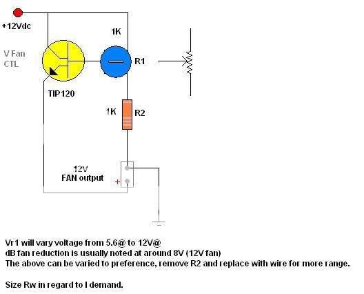

Furthermore, if the output drive transistor is mounted within the case a ventilated design along with a quality DC fan should be used.
Remember, fan noise can be reduced considerable by lowering the fan voltage, a small/simple DC fan control circuit consisting of a voltage divider network along with a transistor is sufficient.
One could also use a darlington (TIP120) if fan current is above average.
