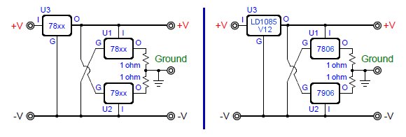

Ok, so I have looked into this a bit further and here are some of the possible aproaches:
  • Create a virtual ground on the input side using resistors. Problems: It's a balancing act between wasing power and still having a fairly low impedance on the ground rail. Especially if you want +/-12V you really can't go below 200Ω or you will have trouble finding resistors that can handle the heat.
  • Create a buffered virtual ground using an opamp. Problems: You can't supply a lot of current anymore because most opamps are made for low current. I found some that can go up to 1 or 2 A but they are extremely expensive (about 13€/~15$ where I found them).
So it sound pretty bad all in all. But on the bottom of the page I posted earlier is a link to another page which shows an interesting aproach.
Take a look at this:
Source: http://www.goldpt.com/virtual_ground_circuit.html
For a more complete circuit (including capacitors and so on) and some notes please visit the site!
In my eyes this compares surprisingly well to the approaches I mentioned above. The regulators now don't actually regulate the input voltage but are used to create the virtual ground.
The out terminals of U1 and U2 now have (theoretically) the same potential. Of course we don't live in a perfect world and the difference here will depend on how precisely you set up the big input regulator U3. But you can easily get away with 1 Ω resistors on the devider here (even less if you get it really precisely set up).
More importantly you don't depend on an expensive opamp in order to supply ample current. The only limiting factor here (apart from U1 and U2) is U3. Since I have a lab supply I don't need a third regulator, so I havent looked into how expensive a 3 A regulator is (my U1 and U2 can each supply 1.5 A hence the 3 A on U3) but I assume it's less expensive than a 1 A opamp.
I tested it and using a lab-supply instead of U3 I got the difference as low as 4 mV.
In the end the circuit drew 8.5 mA at 24.55 V without a load, which equates to 20.8 mW of loss. However I think this power was lost inside the regulators because the divider only wasted about .3 mA.
I haven't tested any other behaiviour of this (noise, stability etc.) but as far as I am able to do so I might do that in future and if so I will post my results here.
I quite like this approach because it seems to vastly outweigh it's drawbacks (i.e. only a third regulator). But I am still a newbie in the field of electronics, so I would like some oppinions of you guys.
What do you think of this circuit?

Ok, first problem found:
Looking at asymetrical loads I found the following problem.
I put a 470 Ω resistor between the + rail and the VGND => everything ist fine.
I put a 470 Ω resistor between the - rail and the VGND => The VGND suddenly shifts massively and the + rail shows 21 V and the - rail shows -3.5 V (both relative to VGND).
470 Ω should only draw about 25 mA which should be a piece of cake for a 1.5 A regulator.
Why does this happen?
Ch33f
May 18, 2015
27
May 18, 2015
27
To elaborate a bit:
If this was a simple resistor based voltage divider I would not have been surprised, because by drawing current asymetrically you basically change the impedance of half of the divider, thus shifting the VGND.
BUT: To my knowledge the two resistors play only a minor part in creating the VGND in this circuit. They basically just even out the 4 mV difference that occures due to imprecisions. I would have expected the regulators to regulate any shifting in the VGND because thats basically theire job: Supllying the same voltage no matter how much current (to a limit of course) is drawn. Since I only draw about 25 mA (in theory; in practise it's much less due to the shift) a 1.5 A regulator should handle that easily, right?
And odly enough it only happens when I place the resistor across - and VGND, not if I place it across + and VGND.
