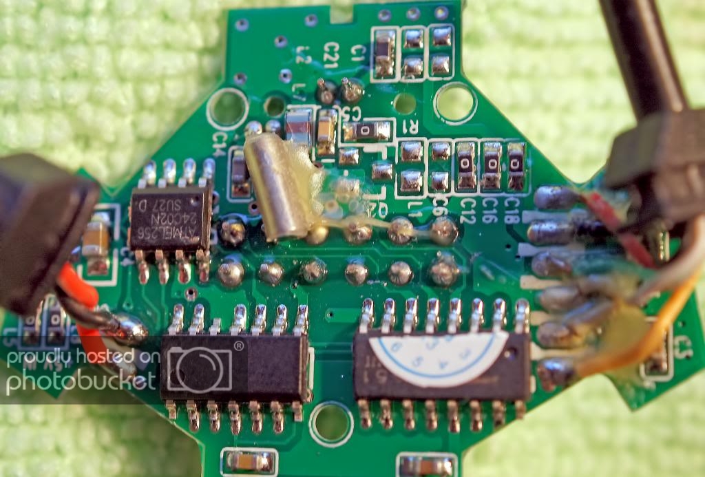

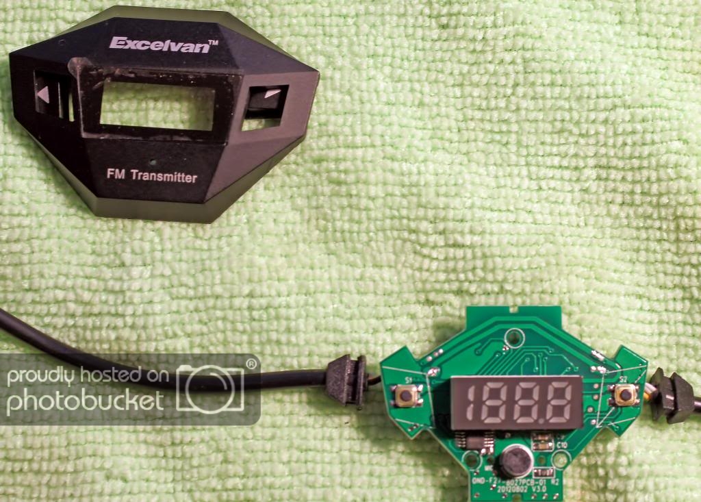

Hi, I was hoping someone can help me decipher where I can attach a copper wire to act as a larger antenna on my FM transmitter, to hopefully increase the sound quality and clarity. I bought a Excelvan aux-in FM transmitter for my work truck, and it gets power via 12vdc cigarette lighter plug. I'm very basic when it comes to electronics, and can handle minor wiring/diagnostic issues when it comes to vehicles, but I don't know small electronics well enough. I'm fully capable of soldering, and testing points on the PCB with my multimeter, but that's about it.
Here's a picture of the transmitter :
Unfortunately, there's no solder point obviously named "ANT" or anything for an amateur like myself, so any help would greatly be appreciated.
Here's a few pics I took of the transmitter after I opened it up.
Thanks for the help, I really appreciate it!

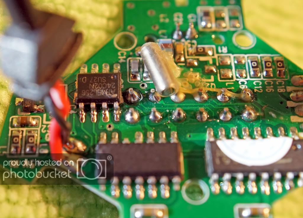

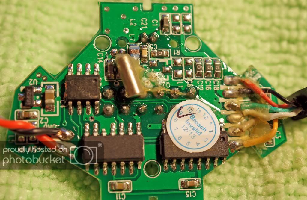

Sorry for the large image size, but I figured that might help! They can be larger if needed.

Well they don't put ANT anywhere as the units are not supposed to be modified ;)
the antenna is likely to be that upper most circuit track the one that ends in 3 solder blobs on the left side
That's not guaranteed, just the most likely
Scrub That
it looks like that's a +5V rail
without a circuit for it, I have no other ideas .... sorry
adding an external probably wont improve sound quality/clarity unless you are already using it at the limits of its range.
Soldering a wire on there isn't going to hurt it so you mite as well try :)

This type of transmitter uses a short piece of wire in one of the attached cables as an antenna (a poor one as you've surmised). It will be connected to the circuit board but not to anything on the other end. You can use an ohmmeter to test the continuity of the wires and connectors to identify the antenna by elimination.
There's also an attenuator between the output pin on the IC and the antenna wire to reduce power so the unit complies with regulations. Unattenuated it's capable of up to 450mW.

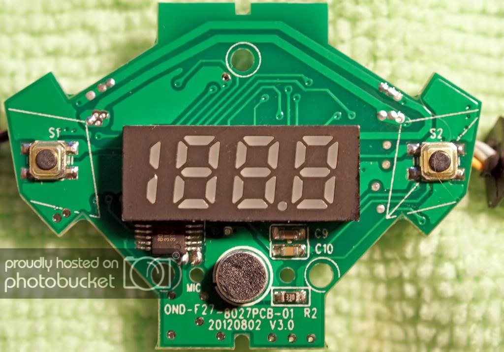

Having a hard time getting continuity tests from most of the board covered in a film. Again, thanks for helping me out, as small electronics like this are a total learning experience to me.
Is the attenuator one of the larger black "chips" in my last three pictures?

I was thinking of that possibility also but when you look at the number of connections between the USB plug and that other 4 contact connector then only 6 wires in that cable I kinda dismissed that idea
eg the red and black most likely the +5 and 0V for the USB, 2 more wires will be data lines for the USB. So that leaves only TWO wires going to a FOUR contact connector plug
let alone another one for an antenna wire
try to figure that one out !! .... I cant without doing some continuity tests
what attenuator ? which IC is the output one ? there's no markings to identify that

I don't see any obvious 3 resistor pii or T network that would indicate an attenuator

OK going some googling on these units I discovered a few things
The USB line is likely to be power only .... it appears to be just just for charging only ( so no data lines)
The 4 contact 3.5mm plug will have microphone, left and right audio and a 0V line Its capable of hands free phone use using the mic in the transmitter unit and connected back to the phone)
The 0V line most likely the black, will be common to both the USB and the 3.5 mm audio plug. The red is most likely the 5V line
2 more for left and right audio and there would be a spare one for an antenna :)
SINCE it already probably has an external to the circuit board, wire antenna, lengthening that wire probably isn't going to make much difference
cheers
Dave
