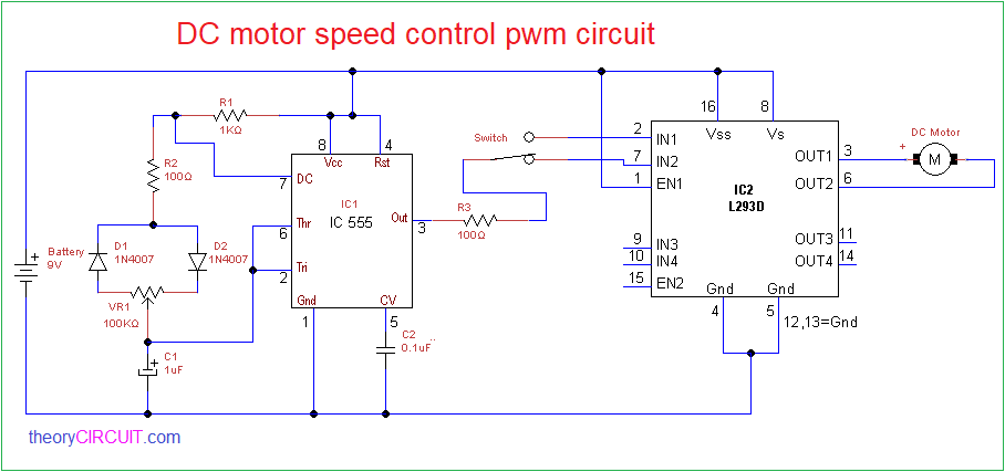

I may have found a workable solution for reducing speed of the dc motors controlling them with PWM by using a NE555 and L293:
I will make this circuit and will let you know the workability.
regards Harry

I have made the drawing, see enclosed, and I wonder if this drawing makes sense? I drew option 1 and option 2 (with different diodes placings).
Looking forward to your suggestions and alterations

Oké, this simple and a very logic explanation. I will try this tomorrow. I am now making a circuit diagram of the circuit previously posted. I have to see the circuit in progress prior to understanding it. (I'm still a rooky and hobbyist and not an electrician)
This is the ultimate extension of the series-diode concept. It is much simpler than your 555 based circuit and your chances of successfully using it are therefore much better.
Frankly, there are so many errors in the 555 schematic you drew that I won't even attempt to correct it.

Good morning CS,
After painting my outdoor windows and doors I am finally able to pickup my hobby. I made the above circuit again and I came to the conclusion that my previous diode circuit was NOT correct. problem The reverse diodes connection . Now the new circuit is using a max of 3 diode pairs for obtaining a reduced speed. Only 1 circuit is needed whereas I said previously that 2 circuits (1 for front rotation and 1 for backward rotation) were needed. But logically the circuit is running from + to - voltage and vice versa so only 1 circuit is needed.
As for the PWM circuit containing the NE555 and the SN754410, I managed to build the circuit and it is functioning well.
