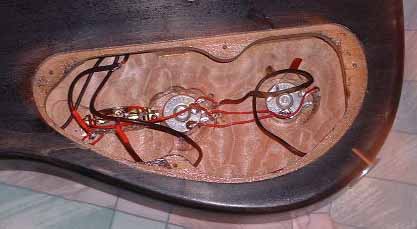

Hey everyone. Im 17 and new to electronics and this is going to be my first real project. I play guitar in a band and I want to install this project in my guitar under the strings, and between the pickups for a little added stage wowing. Here is a picture of a guitar similar to the one I want ot put this in.-->
As I said I want to put it between the two pickups(2" gap), under the strings. I planned on making a back cavity (for those who don't know what that is, it's this)-->
to house the project, and drill holes for the LEDs and pots. Question #1 is, Where can I get all the parts to make this project? #2 Will the project make a hum or buzz in my sound? #3 Any advice? Thanks to any and all responses.

Hi Ibernez,
Welcome to our forum.
I have been making lots of these chasers. I have made some with Ultra-Bright LEDs, and they are really bright, probably more suitable for your guitar project. The Ultra-Bright LEDs need more than 3V so I modified the circuit a bit and use 4 AA alkaline battery cells. I'll post the modified circuit soon as an 6V Ultra-Bright LED Chaser project.
You might have a whine and a buzz in the guitar's sound if the project is mounted so close to the strings and pickups. I suggest mounting the circuit and its LEDs around the bottom edge of the guitar, to avoid interference with its sound and the LEDs would be seen better away from your "strumming" hand anyway.
Since you have AOL you are probably in North America, like me. I buy my stuff on-line from www.newarkinone.com or www.digikey.com since they have almost everything in stock and have pretty good prices. You pay online with a credit card and delivery is by courier the next day.

Thanks for the advice. Im looking forward to the 6V Ultra-Bright LED Chaser. I figured the LEDs would make some kind of hum. The thing is is this is what us guitarists call a "project guitar". It's all hot-rodded with special pickups and stuff. I have broken pieces of mirror all over it and the only parts that aren't covered are the area under the strings and below the two pickups. So I guess I'll put it on the lower horn. Also, I forgot to ask, I'd like to put a on/off push switch in to turn it on and off. Maybe when you make the new mod circuit, you could tell what kind and where to put that in? Thanks.
