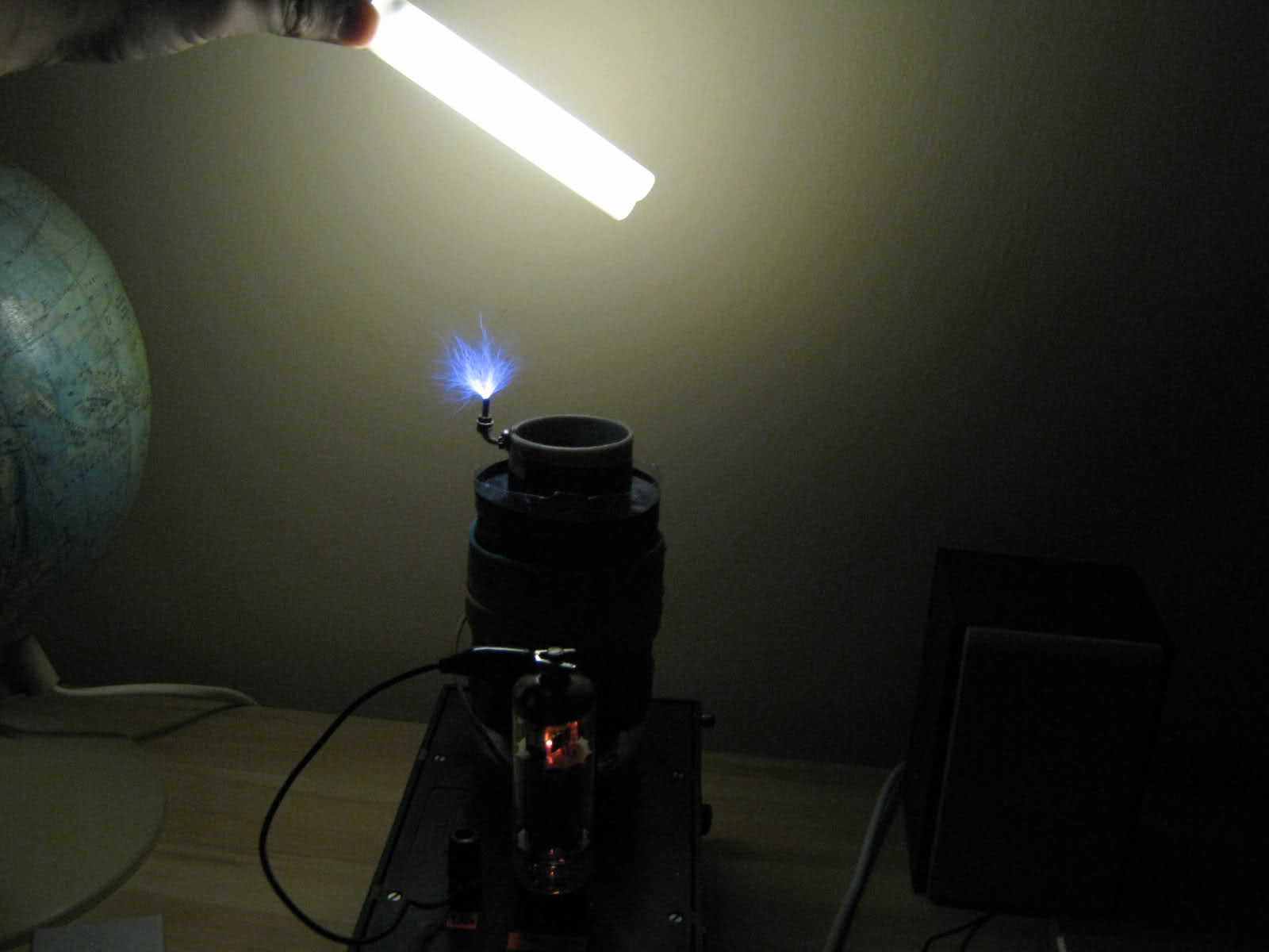

With a horizontal output tube, PL 500, from an old black and white TV. 10cm long secondary, 3.5-4cm free to air streamers.
Also added an interrupting circuit with a SCR/thyristor/whatever you call it. Got 6-7cm free to air streamers this way. Anode voltage comes from mains voltage multiplier, no microwave oven transformers or other trickery (the tube ain't for high power).
Whatdya think? ;)

Other than jamming wireless transmissions and causing interference with sensitive electronics, not much. Might be useful for lighting up neon lights wirelessly. ;)
hahaha yes it will make a bit of noise on other gear
but well done, nice practical display. you should add a fluro light tube to the collection of things to bring near the discharge. it also should light up quitye well.
interesing to note the difference in the discharge between the contineous voltage and the interrupted one. a much cleaner display with the interrupted drive.

@davenn, yup, tried that numerous times with the fluorescent tube, but had none at hand during the camera work. I'll upload the result here just for the lulz :D

Here's the fluorescent tube, lighting up wirelessly near the coil /the interrupter was switched off, ran in constant-wave mode, 3.5cm sparks/ :D
Was lit up till moved 40-50cm away from the breakout point.
