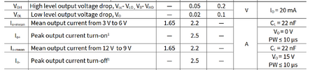

Thank you for reply, but one challenge i am facing is for the Mosfet driver attached i am unable to find the table similar to below
which is used in the calculation
Can you please guide how do i calculate for the driver i have attached. There is an article from Infineon but could not follow
InternalResistance
Thank you in advance.

I think this section of Fig 5 has the information you need :-
Ok, now i get it thank you,
Internal source resistance Calculation
Rs1 Ohm = VCC/IOpk+ = 15 Volts / 2.5 A = 6 Ohm
Rs2 Ohm = Voh / Itest = 0.05 Volts / 0.02 A = 2.5 Ohm
Average = (Rs1 + Rs2) / 2 = (6 Ohm + 2.5 Ohm)/2 = 4.25 Ohm
So, the internal source resistance is 4.25Ohm
Internal Sink Resistance Calculation
Rs1 Ohm = 15 Volts / 2.5 A = 6 Ohm
Rs2 Ohm = Vol volts / I test A = 0.02 Volts / 0.02 A = 1 Ohm
Average = (6 Ohm + 1 Ohm) / 2 = 3.5 Ohm
Sink resistance = 3.5 Ohm
Only one clarification, if i am operating the driver at 12V the calculations remain same or will it change?

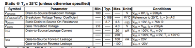

Please help to review and confirm the calculations for the total gate resistance the Mosfet data sheet i have attached, the gate resistance calculations are performed as per the article GateResistance
tsw = 100ns, the way i arrived at 100ns is the switching frequency is 15KHz , time for one cycle = 1/15KHz = 66uSec
for 1% duty the time will 66uSec/100 = 666nSec
Step1: 1770180476331.png
As per the data sheet
Qgs = 35nC
Qgd = 43nC
Iavg A = (35nC + 43nC)/ 100 nS = 0.78 A
Step2: 1770180842876.png
Vcc is turn on gate voltage
Vge gate plateau voltage
Vcc = 12V given to the Mosfet driver
Vge = 5V as per the below diagram from data sheet
RTot Ohm = (12V - 5V)/0.78 A = 8.9 Ohm
RTot Ohm = Rgon Ohm + Rdrp Ohm
Rgon Ohm = RTot Ohm - Rdrp Ohm (Rdrp = 4.25 Ohm from previous post calculations)
= 8.9 Ohm - 4.25 Ohm
Rgon = 4.72 Ohm for 1 Mosfet
Since 2 Mosfets are connected the Rgon will be halved
Hence the Rgon = 2.36 Ohm
Request to please confirm if it is the correct value as per calculations. Thank you in advance for your time.

I am sorry i could not understand completely what you are trying to say, whatever little i can understand is that we cannot completely rely on the calculations, based on testing we have to decide the value, am i correct?
Martaine2005
May 12, 2015
5,318
May 12, 2015
5,318
Yes, that’s correct.
The math may be correct but the real world characteristics and tolerances of components including circuit board traces all affect the final values.
So either a compromise or a slight change of component value can achieve the desired result.
