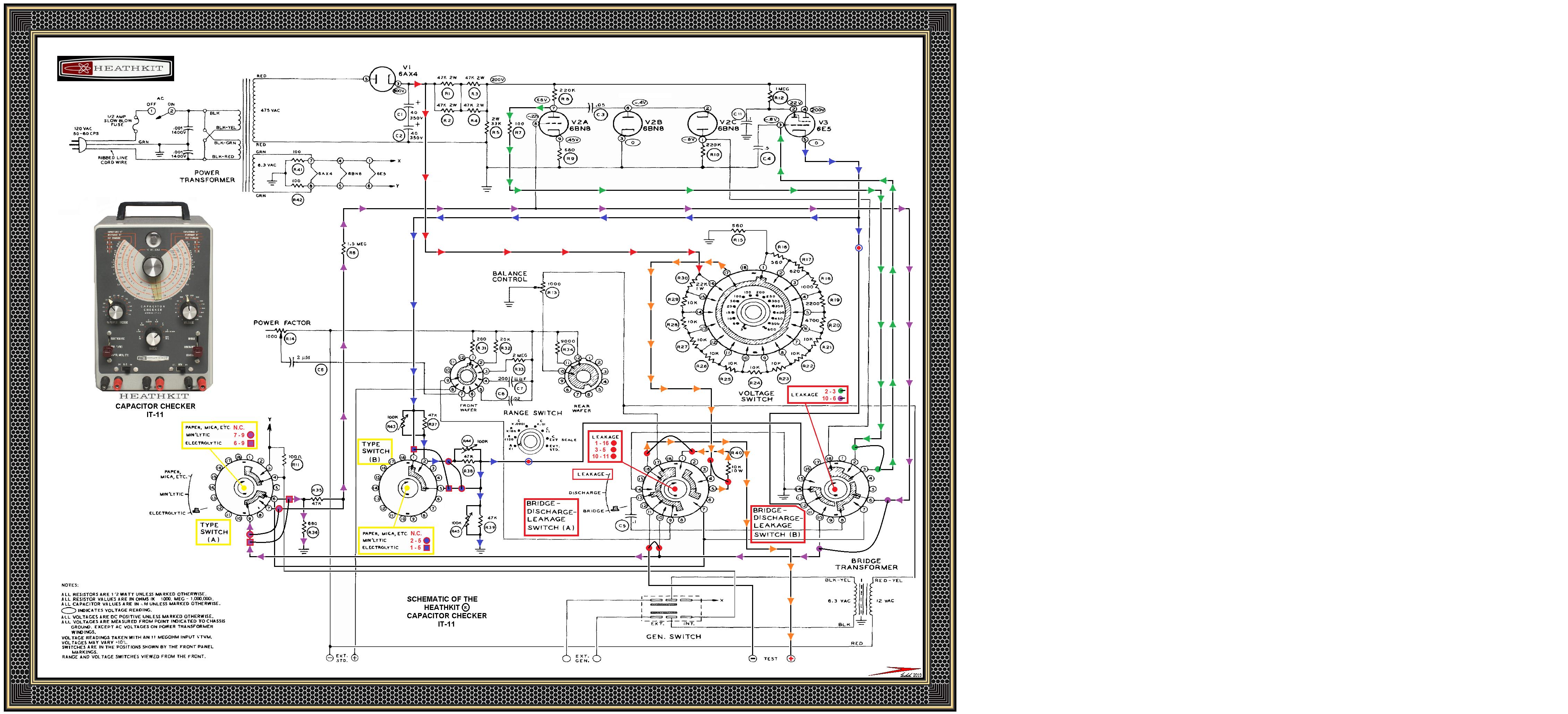

Sir pete geeeeeeeeeeeeeee . . . . .
Considerring that you have already replaced the main electrolytic capacitors in that unit . . . .
To save some time . . . use this procedure given below and tell us the exact points of failure.
Then we can figure what is going on.
http://boatanchorpix.x10host.com/HeathCap.htm
73's de Edd . . . . .

ALL BEHOLD . . . now . . . instead of your units original split up / two piece schematic, you (a tout le monde) now have yourselves a UNITIZED one page version, with my added mark-ups that are being the involved circuitry, flow paths, and switch actions of just your specific . . . CAPACITANCE LEAKAGE . . . . problems that you say are being experienced.
Your voltage readings supplied are indeed way off base. BUT you need an answer for Steve . . . me too . . . ME TOO ! . . . as to what the KNOWN situation on this kit is.
HAS IT EVER BEEN KNOWN BY YOU, TO WORK IN ALL OF ITS TEST FUNCTIONS ?
If not, I INITIALLY suggest to take a .05 or .1 ufd cap and use the bridge function to test the cap and see if you can get good eye opening and closure at the point where you are rotating the units top balance control for the caps reading of value.
That then lets us know that the 6BN8 - 6E5 and their support components are functioning.
Design wise, this is being a superior unit by virtue of the additionall use of a triode amplifier and then a voltage doubling of its output before feedig into the tuning eye display inicator. All the other units just use the triode within the tuing eye tube.
Also they voltage double the filament voltage that is also used for the supply voltage to the bridge test circuitry.
After you have given feed back on the capacitance shakedown test in bridge function, I would then want to confirm the HEAVY

Sir pete geeeeeeeeee . . . . . .(and Sir Steve as an interested spectator up in the 56th tier of the Peanut Gallery )
I'm going to speed you forward a bit . . .with your having said that the working ? unit has developed this situation with time.
At the top you can see the RED - GREEN - BLUE - PURPLE arrow paths . . .Yellow brick roads . . ..
Lets take the RED arrow one first and see it taking all of the B+ that the 6AX4 can hit it with and travelling down and to the right to the R30 end of a daisy chained series of dropping resistors that end up at an offboard R15 to ground. That gives the #17 rotor connection the capability of picking off some selections from ~3Vdc on upwards of 600 Vdc.
The switch selected voltage then routes down the ORANGE arrow path to the RED designated BRIDGE- DISCHARGE - LEAKAGE switch and its A and B sections.
Now, since we are only concerned with the LEAKAGE aspect, only those switches connections made, are being depicted with the RED-BLACK jumpered connections. On the left A section, we can then see that the ORANGE arrow path then connects into an R40 10k/10W resistor and exits and continues down to the front panels + terminal of the RED 5 way binding post connector.
Sooooooooo . . . now we have the tested capacitor between the two posts and we just now have to see what happens to that left negative lead and how it eventually gets grounded, along with its creating voltage metering.
Now . . . . one additional aspect, is that the same A section switch that we just evaluated . . . additionally . . . connected your - terminal of the BLACK 5 way binding post connector into the PURPLE arrow buss up at # 10 and 11 of the same A switch section.
Now that we see that both sections of the test capacitor are connencted in, lets go up to the top of the page and note that we have the 1st grid of a 6BN8, the plate of a 6BN8, the 1st grid of the triode section of the 6E5 and the cathode of the 6E5 that will be receiving remoted connections via the GREEN - PURPLE and BLUE arrow paths.
Lets start at top left corner at the plate of the 6BN8 where its plate takes the supply voltage from the 220K . . .in that time freame, with it probably being a molded carbon composition resistor.
( The vendor probability factors are . . .Ohmite 28% - Stackpole 18% - IRC 24% - Allen Bradley 29% ).
Check its value to see if it hasn't drifted upwards with time. Then move down the GREEN arrow path to the R7 with its probable .0001 % failure rate
Then follow the GREEN arrow path to the right til the drop down to our now familiar switch, but viewing its B section this time and GREEN arrow goes in #2 and out 4 and back up the path justhaving been taken, but this time it is entering into the 1st grid of the 6E5.
Now . . . . . Ladeeeez and Gentlemen . . . what we do seem to be having here . . . . are being a direct / resistively coupled dual amplier stages.
I ask you . . . .doesn't that high and "odd" level of + DC voltage on the grid of the 6E5 seem more normal / equatable now ?
I say yes . . . but not with that cathode of the 6E5 being directly grounded.
So now we can see that the cathode of the 6E5 is being " remoted " via the BLUE arrow path down to a right angle branch to the left and also straight down to . .guess who switch . . . and in its #12 connection to ground.
BUT that is being ONLY if we were in bridge mode, in our case now, we use that left BLUE arrow branch and transverse to the left and drop down to the YELLOW marked up TYPE (of capacitor) switch with its A and B sections and we make connect into the #1 contact.
Now this TYPE switch pair is being different than our far right B-D-L Switch that were checking out, that just always remained in its switch connections, while testing for LEAKAGE.
In its present situation, it has now received the cathode of the 6E5 and is routing three series resistor sets to ground.
Therewith, you now have a variable cathode resistor cluster serving as your 6E5's cathode resistor.
Now you can see the significance of the order in which you adjusted the R43 - 44 - 45 trim pots and their potential interactions with each other.

That was the more in depth aspect, totally being ignored in the HEATH manual expanation of operation.
Now the last one involving the voltage measurement.
You remember . . . . . that we left you with a test cap connected to B+ and the - lead floating and needing a way home to ground, while also being measured with the eye tube.
Go back to the TYPE switch section A and we see that the test capacitors - lead comes in via the PURPLE arrow path and into TYPE switch section A.
These are the flow paths on the A section of the TYPE switch
Move theTYPE switch to the ELECTROLTYIC position . . .
The PURPLE arrow ground path comes across to the left and goes up into #9 and exits 6 and connects into a voltage divider branch of R36 to ground or goes the upper path of R35 which then passes on up to R6 which passes up to the 1st grid of the 6BN8 triode.
( Ignore the # 7-9 path . . . . as its now being open circuit in this switch position).
Move the TYPE switch to the MIN"LYTIC position . . .
The PURPLE arrow ground path goes up into #9 and exits 7 and connects into the R35/R6 voltage divider branch, of which, R6 goes up to the 1st grid of the 6BN8..
( Ignore the #6-9 path . . . . as its now being open circuit in this switch position).
Move the TYPE switch to the PAPER, MICA position . . .
Don't look at the A switch section contacts, cause there is nuttin' happ'nin with them any mo . . . . . instead back track the PURPLE arrow, wannabe "ground" at the bottom.
It will go up into the B-D-L switch B section to #10 and loop thru to #6 and pass up the right extreme side and upwards until it shifts left at the top and it then ties into the 6BN8 1st grid
( I shudda' put a PURPLE arrow up that path) then the arrow path moves to the left to the top of our old friend . . . R6 . . . the top unit of that voltage divider trio.
Subjectively . . . .the top of R6 is your voltage read off point for measuring PAPER MICA CAPS while the lower R6-R35 junction povides the MIN'LYTIC voltage read off and finally the lowest R35 - 36 junction provides the standard ELECTROLYTIC voltage read off.
The selected sample voltages are being fed into that initially mantioned 6BN8 + 6E5 DC coupled gain block to activate the eye tube.
FIO . . . . my designated RED-WHITE-BLUE circles designate a non consequential flow path ending, as they are grounding the cathode of the 6E5 in accordance to two different switched positions functions (in BRIDGE testing)..
Your related " homework " / lab assignment . . . .
Confim R8 220 K as being . . . O.K.
Lift the ground leads of C11 and C4 and re ground with clip leads or temporary use tack soldered soldered jumper wires.
