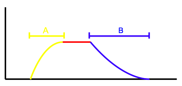

Hello all.
I'm trying to turn this sort of waveform: (essentially a fixed amplitude sine wave, but really it would be a rectified audio signal)
Into this:
Whereby the times for A and B can be independently controlled with different fixed capacitor values. I can easily slip a capacitor in to smooth the whole signal out, but I need to be able to vary A and B independently. I've tried playing with different capacitor arrangements but have't really found anything that truly independently controls A and B – my capacitors seem to interact in strange ways.
Any help is highly appreciated.
Thanks in advance.

First off, that is not a sine wave and is also not what a rectified audio signal will look like.
Assuming you really want to shape a square pulse like that, I don't know any way you could do it with a passive circuit.
Bob

I think he may be talking about changing the envelope.
i.e. to give a non-instantaneous start and stop. I believe this is called attack and decay.
Googling that, I came up with this circuit. It's all discrete, but I think more googling might yield more options.

You need to have two different impedances feeding your load, one for your leading
edge and one for your trailing edge.
This can be done many ways but the easiest way may be to use a PNP transistor
for the pull-up and a NPN transistor for the pull-down. You can use two different
variable resistors in the collector circuits of the transistors for your time constants..

Or you can take the original pulse (if that is what it is) and pass it through a low pass filter.
That'd only smooth the whole signal out. I could do that to convert peak values to RMS though, depending on the capacitor.

Would this still use capacitors charging as the physical mechanism of the delay, or would it be entirely active?

I'm not very good with transistors, it seems to be about the edge of my ability. I've ventured nonetheless into using the drop of the signal's pulse to halt the discharge of the capacitor, which seems to be fairly easy with a transistor.
I came up with something like this suggestion, except both attack and release are NPN transistors. For the attack I fed the signal to both the base and collector, with a resistor/capacitor voltage divider over the base, and then varied that to determine how much signal was fed to the low pass. It just drops once the input signal drops, so I think it doesn't affect the release because the input connection to the base and collector don't allow any signal from the capacitor through base to emitter. It works in simulation at least.
For the attack I've got the emitter going to output and a capacitor to ground, and the output is fed back into the collector. I can't explain why it works in simulation, but I don't have any resistors so I'd switch the capacitor to change the release time.
Again, I'm not very good with transistors, so I have no idea if this is a valid way of doing this. It works in simulation though, but I have no idea what it'd do in real life.
Thanks for the suggestion of using the transistors. I'd have never even thought of it. Cheers.

I was thinking of the capacitor being in parallel with the output. A PNP transistor emitter would be connected to a power supply, maybe 5 volts, and the collector feeding a resistor.
A NPN transistor emitter would be connected to 0 volts and the collector would be feeding a different resistor.
The other ends of the resistor would be feeding one end of the capacitor and the output.
The other end of the capacitor would be connected to 0 volts.
The transistors would be acting as switches, that is being totally on or off.
The transistors are active components but are not being used in their active regions,but as switches.
Now the bases need to be feed with a pulse through separate resistors.
