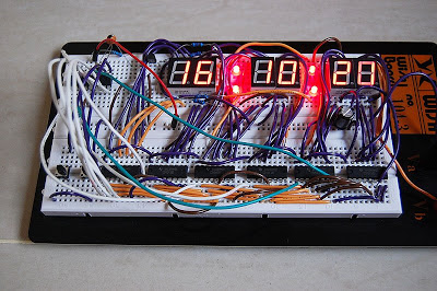

7 segment display basics
Perhaps I should be asking peoples guidance on the actual stages of driving a led segment from the battery to the display circuitry.
I was trying to understand the basics before going into pic controllers
Linked images are indeed impressive, I don't understand how people wont go mad with all those transistors, or loose track of what they are doing, then again, GPUS have billions of transistors, and intel cpus have millions..
but even the most powerful pic is not enough channels
Using Charlieplexing there probably is enough pins, but the refresh rate would almost certainly get out of hand...
The good news is that there are serial controlled 7 segment drivers that will run 100s of LEDs with only a few i/o pins... You can chain together multiples and thus you would only need a handful of pins to control dozens upon dozens of displays... The Maxim MAX7219/MAX7221 is one such chip, it's a little costly and although I sampled a few recently I have not acutaly used them, but it will do 64 segments (eight 7 segment displays)... The MAX6955 will do 128 segments (sixteen 7 segment displays)... There are others out there as well from other manufactures that will do more segments, but I don't have the chips numbers handy...
But, again I asked why the need to stick to 7 segment displays?
Also you can can possibly cheat on this by hard wiring the location names and thus not needing any control over them...
