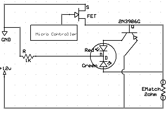

ok so I have a microcontroller sending low voltage signal
That is connected to an N channel Mosfet (IRF9910PBFCT-ND)
That's what should drive power to the EMatch setting it off.
But I also wanted a Continuity LED (Green) so when the ematch is connected I get a green light.
Then when the unit is actively firing I wanted the Red LED to be on so I have another Mosfet P channel driven off the first to basically just reverse the power signal into a positive to drive the Red LED.
Then I'm not sure about the diode on the right, I think I needed something to prevent backflow when not activley firing the FETs.
Does this look right or am I way out in left field?

The circuit seems to do the job intended (although it's hard to read a diagram that's upside-down of ordinary conventions).
The diode is backwards but I don't think it's needed anyway.
The green led will be exposed to 10V in reverse when firing though. They usually survive that even if it's over ordinary spec's but you may want to do someting about it.

How is the Green getting 10V backwards?
Both the anode and cathode should be both pushed to ground durring firing?
So it's not a bad thing to back feed Fets with reverse voltage on the gates?

I too do not see why the diode "D" is used. The net shared by the anode of "D" the PFET gate and the NFET drain is blocked off from ever seeing a positive DC voltage, so I don't see the state of the PFET ever changing.
**Edit** Sorry. I need to read more carefully.
So the diode on the right does have to come out or your ematch will never fire. Right now the only time you draw current through the ematch is when the green diode is on which you said is when you do not want it to ignite.
If you have a microcontroller to drive the gate of the N MOSFET I would use it to drive the LEDs as well. This would eliminate the PFET and would also make the circuit function without running current through the ematch when it is not supposed to ignite. I understand that it is a very small current but if I have fireworks/model rocket attached to the igniter then I want 0A current running though the igniter until its go time.

OK So I have updated the picture (May need to refresh to see the change)
OK so the green LED is for continuity, I have to run some very minimal current through the match to make sure it's good. I have this setup on my mechanical firing system, the LED does not draw anywhere near what it takes to ignite an ematch.
So that's the green,
then the red is for active firing, and I can not draw this from the microcontroller directly, because I have this schematic x10 for each channel on the box.
And if I fire all at once, the LEDS current draw would be too much for the microcontroller, so I have to switch them seperately so as not to overload the microcontroller.
But since the Neg is common on the red/green LED I can't use that to control when the LEDs come on, I'm using Neg control for the firing of the match. but then needed a second Gate to control the pos of the red LED
Did that make any sense? :)

Ok many channels makes a great argument for not driving it by uC. So now lets talk subtleties.
(1) Do both sides of the Dual LED draw the same current? If not then you may consider tying the joined cathode to ground and bringing the current limiting resistor to each sided anode. Then you can control the current through each side independently. I find that the red is almost always brighter for the same current thus I prefer different resistors to equalize brightness.
(2) I like the NFET you chose but have you read the datasheet to make sure that driving the gate with a logic level signal will give you enough current throughput(see attached pic). I am guessing that if the ematch is 2ohms and wants a 12 supply that it is counting on seeing about 6A to ignite. For that driving the Vgs at 3V is borderline and may cause the device to overheat. It may not be necessary but I would drive a cheap FET/transistor with logic and use that to drive the second with 12Vgs(see attached). Like I said you picked a good FET so you may not need to do this but I would.
(3) What are you using for the PFET? P type MOSFETS usually require a negative voltage to turn on. ie 0Vgs is not enough. You could either replace the PFET with a buffer that comes off the uC line or you could look into JFET's which can conduct at 0Vgs but beware they can also have a high Rds on.
More or less, It really won't matter. They both look good with that resistor common'ed.
BUT since I should never really "see" the red ones except for testing hahah, I really don't care. I'm not going to be anywhere near that box when it's actually firing, hance the wireless operation.
They actually only need 1 amp to ignite, and a AAA battery does just fine with igniting them. And the pulse is for 1/2 second. I doubt I will be able to over heat them in 500ms once every month or so :)
Also, the fets I chose for that were listed at TTL Logic Gates, So I assume it will be enough from the Controller?
Hmm, well then I may just go with my tried and true radio shack special PNP Transistors, and drive the Gate with the 0VG from the main mosfet to get positive switching for the LED?
Ok.
Indeed it is a logic gate device but most of the performance plots are given for a Vgs of 10V. 500ms at 1A is plenty of time to kill a lesser MOSFET(they can be impressive fast blow fuses). That said, I looked over the datasheet again and I think yours will be just fine with a Vgs of 3.3V and Ids of 1A.
Sure, I am partial to the 2N3906 but whatever you find at the shack will probably work.

Yikes now you have me worried about those Fet.... Sometimes matches dead short after firing, is there any way to protect the Fets then?
Also how many matches do you think can be fired on a single channel of the Fet?
OK I have updated the Schematic above then would that work as designed?

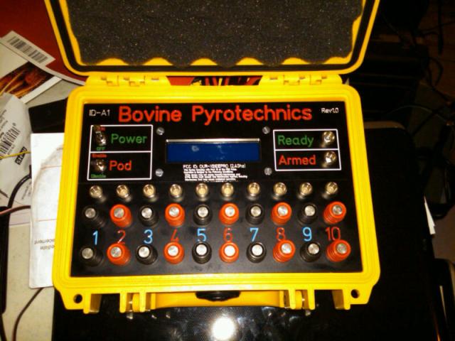

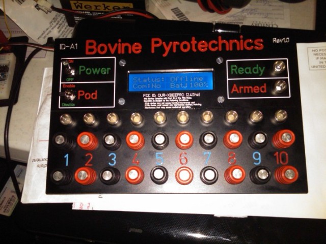

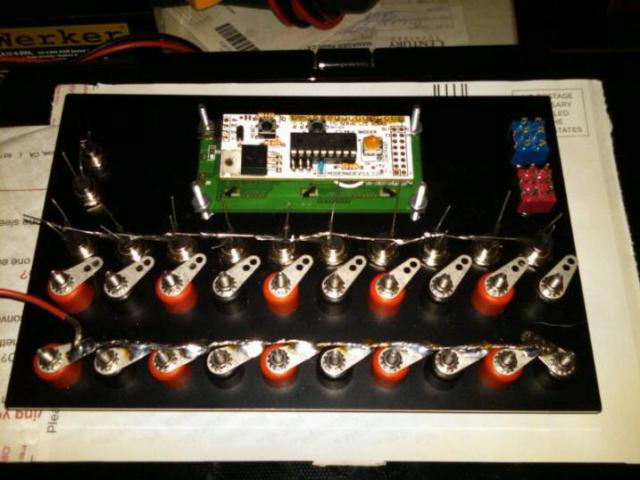

Here are some pics of the project so far,
I have a video of it in action if you are interested, I have 90% or so of the software written for the module, It's working awesome on breadboard even wirelessly (With LEDs showing firing rather than fets just yet)

Dead short, yikes. The way I would protect against that is by having a current sense resistor inline and a comparator hanging off it that has the ability to throttle the NFET gate low if the current goes to high. You could feed the output of the comparator and the uC into an AND gate as long as you configure the comparator to switch low when current spikes. Then of course you would drive the FET with the output of the AND gate.
I will throw a schematic together later.
How many matches were you planning on firing off one FET? And are you using both FETS from a single package at the same time for different channels?

Along those same lines, I'd be looking at foldback current limiting

In the first diagram; you can't replace the original p-fet with a pnp just like that, it'll need a base resistor at least.

Steve- He hasn't said so but what if his power supply is nothing more than just a SLA battery? Also with multiple loads all drawing heavy current do you think it would be difficult for the power supply to distinguish between one load over currenting and 10 loads running normally(call it grand finale).
Resqueline- Good catch, I missed that.
I was thinking that you'd put foldback current limiting on each "channel"
It could be as simple as a polyswitch.
