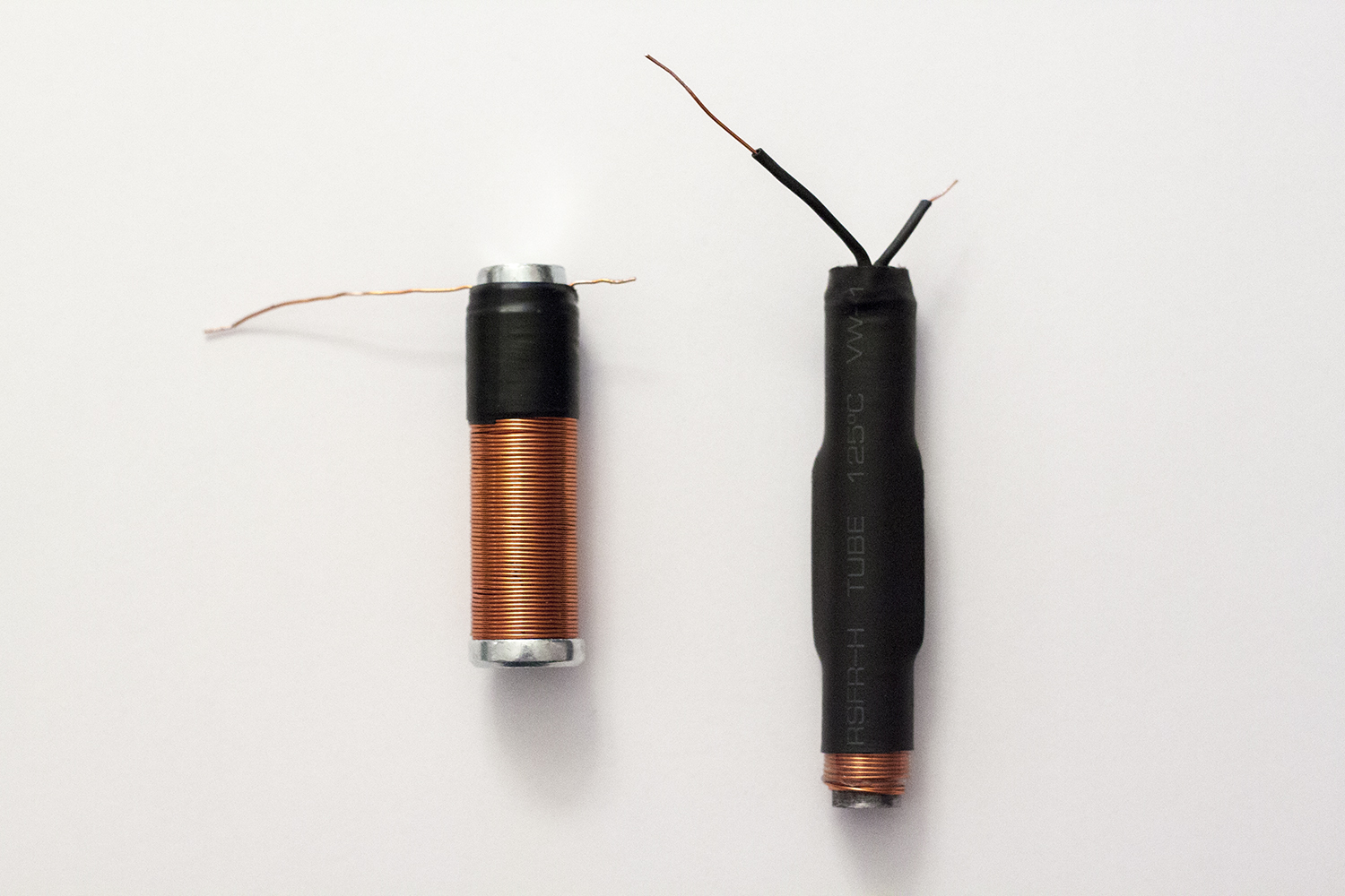

The first part of this update is that I started following online tutorials to make electromagnets. All in all, I wound 5 or 6, playing with different shapes and number of windings etc. Here is a picture of the two most successful I made. These work well, but they exhibit some issues which I'll describe below:
Two hand-made electromagnets, each wound once down and then once back (two layers of windings). The core on the left one is a stainless (I think) trailer hitch bolt. It's perforated along its length for cotter pins, which makes stringing the loose wires through the end a rather convenient operation. The core on the right is an iron (I think) bar, cut to ~ 3" length with a hacksaw. The wire is 24 gauge copper mag wire. The seal on the left is electrical tape, and the one on the right uses clear tape and heat shrink (which was left unshrunk in the middle for visual appeal).

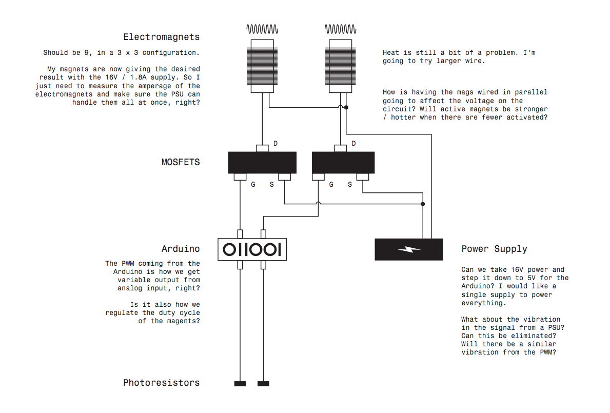

The second part of this update is that I spoke with some advisers and they convinced me that the best way to proceed is to start with the Arduino in play. This is because I'm going to have to compensate for the properties of the electromagnets and figure out how to integrate them with other electronics either way. So with this in mind, I've put together this rough sketch of what I'm looking at. Here is my diagram (I know it's not a proper schematic):
A quick diagram of the planned approach to the circuit. As noted in the diagram, the two electromagnets will need to expand to a bank of nine. Note that while two electromagnets are shown here, and two are also pictured above, this is a coincidence. The magnets have only been hooked up individually, and the diagram includes multiple magnets only in order to show my plan for wiring the eventual nine in parallel. The questions in the diagram are somewhat outdated; please see below for current questions.

So far I have tested each electromagnet (individually only; I haven't hooked up more than one) with three power supplies:
  • A standard 9-volt battery.
    • Produces a relatively weak magnetic force, capable of picking up only one or two 0.75" washers.
    • Barely any effect on ferrofluid.
  • A bank of 6 AA cells (so, 9 volts in total).
    • Stronger magnetic force, capable of picking up a few 0.75" washers.
  • A power supply.
    • Class 2
    • Model SY-13180
    • Input: 120V AC
    • Output: 13.5V DC : 1800mA (measured at 15.9V DC)
    • Produced a very nice magnetic force, capable of picking up many washers, and more importantly...
    • Made a fat and spiky bump in the ferrofluid.
    • However, made the magnets warm after just a few seconds, and also
    • Got rather warm itself.
Also, I took some measurements with my multi-meter while running on the power supply and have these specs:
  • Circuit runs at 16 volts
  • Circuit draws ~ 5 – 6 amps
    • Note that this exceeds the PSU spec of 1800 mA.
  • I also measured the current while on 9V battery and was around 0.3 A.
  • Resistance across the electromagnet wires (measured unhooked from the circuit) is ~ 1.4 ohms
That's where I'm at so far.
Questions
What I need to know is what to look at when designing this circuit. What other components do I have to introduce and what specs do I need to look for in them?
  1. Can I use these numbers to calculate what voltage and amperage I'll need in the power supply?
    • How will the strength of the magnets be affected by having multiple magnets attached?
  2. How do I control this circuit so it doesn't get out of control and dangerous?
  3. How is it possible that I'm drawing ~ 5 – 6 amps from a 1800 mA PSU?
  4. How does wattage come into this?
    • Is it simply a matter of saying: (5 amps) x (16 volts) = 80 watts?
    • Do I therefore have an 80-watt electromagnet?
      • Can I then say that to wire up 9 of these would give me a 720 watt device?
        • Can I then say that drawing 720 watts on 16 volts will try to draw 45 amps (and 'splode my power supply)?
        • This seems like a lot. How can I change this?
          • Is the introduction of a resistor between the magnets and the power supply (not shown in the diagram above) the answer?
            • How would I calculate the values for such a resistor?
  5. Can I use larger wire (I have 16 gauge also) to help with the heat?
    • Is the magnetic force solely dependent on the # of turns?
      • Will I have to wrap the same number of times (more layers) to get the same magnetic force?

The strength of the field will be proportional to the current times the number of turns.
The power required will be inversely proportional to the amount of copper. You can use a lot of thin wire and a high voltage with little current or thick wire with low voltage and high current.
The resistance of various gauges of wire is available in tables. Remember that the area of the wire is proportional to the square of the diameter.
You should match the load on the power supply so that it is not asked to supply more than it is designed for.
Thanks, Duke37. Looking back at my post from last night, I can see that I'm starting to get an understanding of how these factors work together in design.
It sounds like what you're saying in the above quoted message is that the power (watts) can be held constant while adjusting the voltage and amperage in opposite directions. This seems reasonable since watts are potential multiplied by current. But does the strength of the field also follow the same pattern with regard to changing wire gauge? If I use a common size core, does lowering the resistance by using larger wire increase the current such that the strength of the field remains the same even though I make fewer turns (because of the larger wire) over the same length?
I'm also going to explore the idea of sourcing the electromagnets instead of building my own. I've ordered a couple which will arrive later today (being 1 am already... where did that time go?). If one of these works well, my consideration will be finding one that gives me the desired result in the ferrofluid and then planning out how to power an array of them. But in case they don't work out, I'd also like to continue thinking through the hand-made solution. Thanks!
