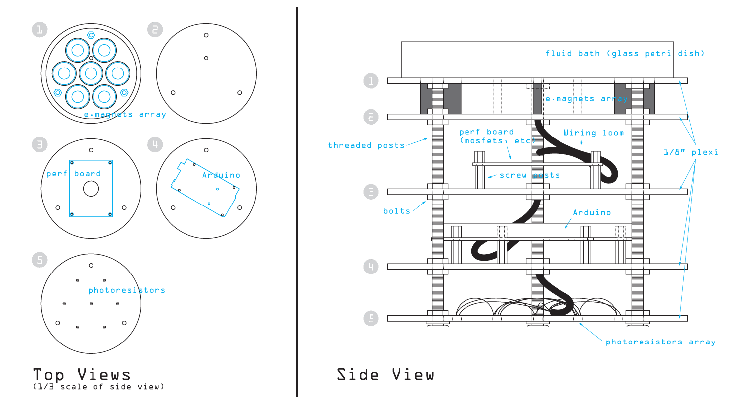

This morning I've decided I'm going to go ahead and finish the project (the deadline is in two weeks) with the store-bought magnets. I'll probably try to wind some others as well, but that will be outside the scope of this iteration. Also, I dropped the number down to 7, as shown in the plans I'm working on. I love drawing plans:
For installation, the unit will be suspended with metal rope (airplane wire). I'll have a light panel sitting underneath it and people will be able to wave their hands across its bottom surface to interact with the photoresistors and, of course, the fluid.

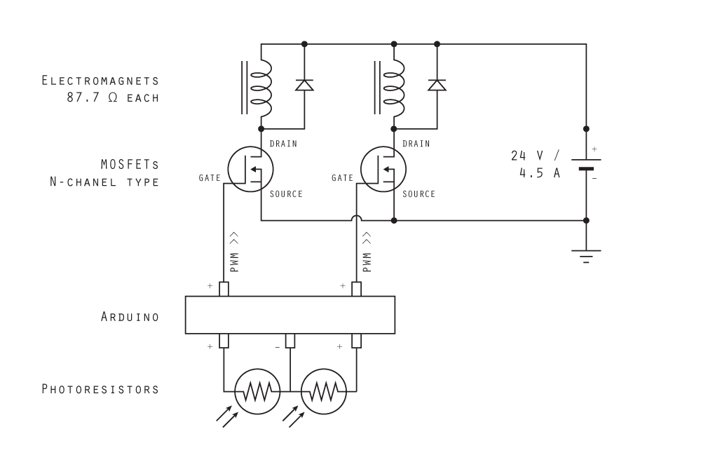

I'm going to shift gears here and start talking about power management. I spent some time last night reading about MOSFETs and voltage regulators, and how to spec the parts. This is what I want to do
Parts I need to source are the MOSFETs and the voltage regulator. I already have photoresistors, and the Arduino makes them pretty easy to use (although I haven't done it, someone else in my class has).
I spend some time last night learning about MOSFETs, and came up with this part:
In specifying the MOSFET, I'm looking at:
  • Drain Source Breakdown Voltage
    • 60 V
      • I'm thinking this is higher than 24 Volts, so my power is within its limit. Is this the right way to use this spec?
  • Drain-Source Resistance
    • 9 mOhms
      • I'm thinking this is the resistance the MOSFET will have when it's activated. Here I was just looking for a value negligible in comparison with what the other load (the coil) will have.
  • Gate-Source Threshold Voltage
    • 4 V
      • I'm assuming this is the voltage required to completely connect Source to Drain. Is that right?
      • I'll be hitting the Gate with 5 V, so I wanted to get something slightly below to make sure it's fully open.
  • Power Disspipation
    • 71 Watts
      • Assuming this is the limit on the product of the resistance and voltage in the circuit that connecting the Source and Drain will complete.
      • On 24 Volts, 87.7 Ω coils only pull 6.56 watts, so I'm within tolerance.
Am I looking at these correctly? Are there other criteria I should be paying attention to? There probably are...
I'll ask about the voltage regulator once I'm set on the MOSFET.
THANKS!

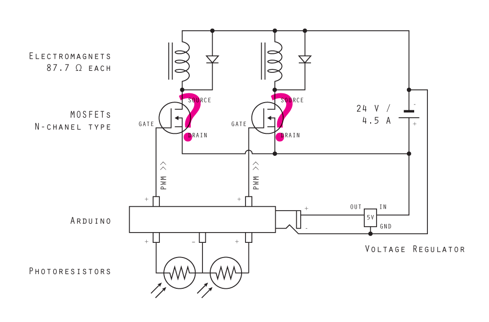

For the MOSFET you have selected, the gate-to-source threshold voltage is too high for use with a 5 V gate drive. The gate-to-source threshold voltage is the voltage required to just barely turn the MOSFET on. Your device is specified with 10 V gate-to-source drive to obtain full-on conduction. Instead look for a power MOSFET specified for TTL (5 V) gate switching levels, such as this one. Or visit this Google result page.

Nice drawings.

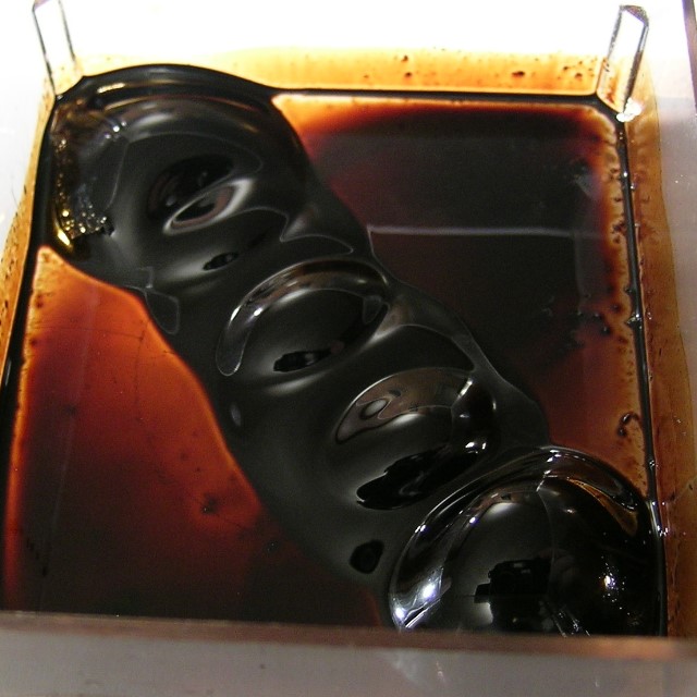

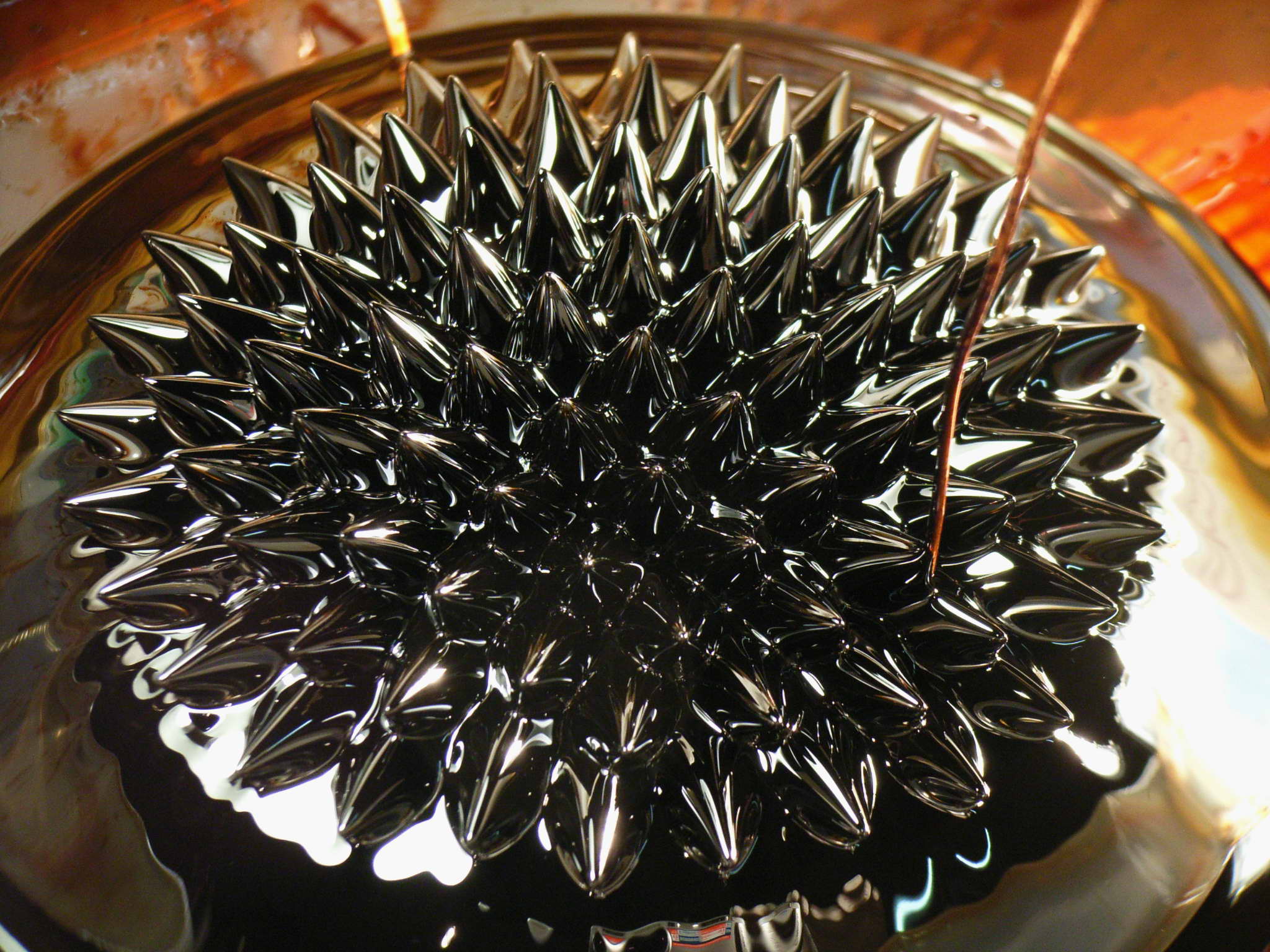

I did test the magnet under the fluid and it made an effect that I can live with. It created a bulge in the fluid above it. But I think we're on the same page, as the one reservation I have about this magnet is that it doesn't give any spikes in the fluid like I often see when looking at ferrofluid demos. Your explanation makes it clear as to why. The hand-wound ones look a lot more like this:
... but with more, smaller spikes.
My result (albeit with only one bulge, since I've only tested one electromagnet so far) looks more like this:
As far as the effect is concerned, I think this is fine. It might even be preferable, since what I'm going for is a kind of shadow of whatever's under the unit. With only 7 magnets, it won't really be a shadow, more of a proof of concept.

Nice drawings.
Thanks!

Your N-channel MOSFETs need a positive voltage on their drains. Reverse the polarity on the 24 V DC supply and reverse the diodes across the coils. Ground the negative terminal of the 24 V DC supply.
Don't power the 3-terminal 5 V regulator from the 24 V DC power supply. It will drop 19 V across the 5 V regulator and waste too much power. Use a separate power supply and provide only about 8 V to 9 V to the regulator input. Provide a heat sink for the regulator.
The power dissipated in the MOSFETs should be almost zero if they are either fully on with virtually no voltage drop from drain to source, or fully off with no current from drain to source. In either instance, the power is either dissipated in the coil or no power at all is dissipated.
Your 24 V 4.5 A power supply should easily provide enough current for nine of the commercial coils or nine hand-wound coils with 0.5 A per coil in the case of hand-wound coils, or about 0.27 A per coil for the commercial coils.
I think I'll just get a proper supply for the Arduino then. Thanks!
One other thing, can you give me some clues about how to spec these diodes? I haven't delved into it learning them yet, but it might be good if I have something to keep in mind as I read.

The common diodes are 1N4001 to 1N4007. These are 1A diodes an any one in the series will do. I got a lot of 1N4007 since they can stand 1000V and will do for any project I have.
Sweet, the components selection I recently bought just happens to have some 1N4001s. Thanks!

Yet still, I like the way you think. I'm gonna get some wire and have a backup plan. It will arrive mid-week, so I can settle on a final design next weekend, and work on mastering the PWM and stuff this week.
If you can find some threaded bolts of appropriate diameter, perhaps made of mild steel (iron would be better) you can heat them with a blow torch to incandescent red temperature and then allow them to slowly cool. This will "temper" and soften the steel, possibly making it more permeable to the magnetic flux. It would certainly work with low-carbon iron bolts, but you have to worry about the iron oxidizing when it is heated because that oxidation will form a scale that is difficult to remove. Or you could visit the florist and get some soft iron wire. With threaded bolts, you can use a cardboard or plastic sleeve as a coil form and screw the exposed end of the bolt into the heat sink. With a bundle of soft iron wires as the core it becomes a little more difficult to attach the bundle to a heat sink, but you sound like a pretty ingenuous person.:D
The diodes need a peak-inverse-voltage (PIV) somewhat greater than the power supply voltage applied to the coils. When the MOSFET turns off, whatever the current is in the coil at that moment will be transferred to the diode, so the peak current capacity of the diode needs to be at least as large as the coil current. 1N400x series diodes work well for this, even the lower PIV-rated 1N4001 diodes.
