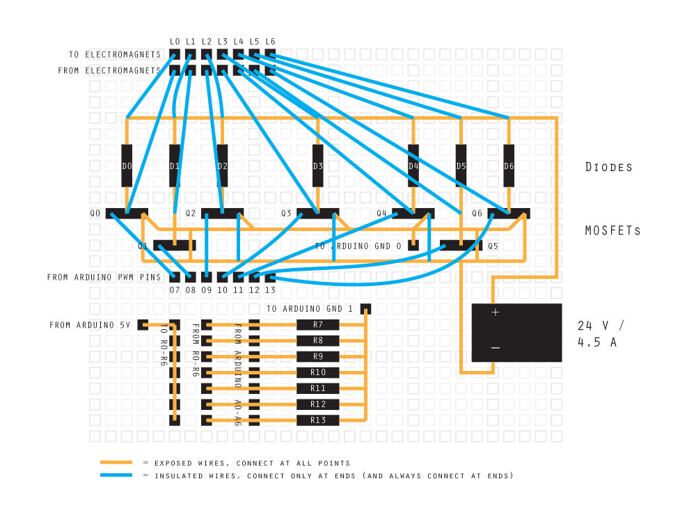

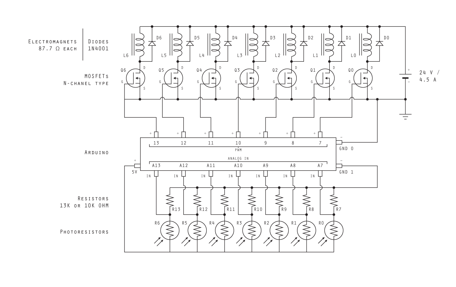

You can run longish 24 AWG stranded wires from the Arduino common to the MOSFET source terminals and from the Arduino output to the gates of the MOSFETs. These wires will carry the current required to charge and discharge the gate capacitance when you turn the MOSFETs on and off. When you wire up the coils, connect their power supply's negative ("ground" or common) lead also to the source terminals of the MOSFETs. That way, gate drive currents flow in the wires going to the Arduino and coil currents flow in the wires connecting the coil power supply to the MOSFET source terminals. If you so desire, the MOSFET sources can also connect to a non-current carrying "ground" such as the "green wire" power-line ground. This can sometimes help to reduce electrical noise on the "grounds". This type of ground connection is called a "star" connection because all the grounds are referenced back to a single circuit node: the source terminals of all the MOSFETs.
And, yes, it's all about the wire resistance that the "ground" currents flow through. By choosing a common ground point, the source terminals of the MOSFETs, and providing separate "ground" wires for the Arduino gate driver connections versus the "ground" wires for the coil power supply, you avoid injecting spurious voltage transient signals into the gate drive signals.
For example, let's say you connect a wire from the negative terminal of the coil power supply to all the MOSFET source terminals (seven of them I believe in your latest iteratiion). There will be a small voltage drop on this "ground" wire whenever one or more coils is conducting current. So, you would NOT want to connect the Arduino ground at the negative terminal of the coil power supply, because then the gate current drive would share a wire (and the resistance of that wire) with the coil currents. Instead, connect the Arduino "ground" near the MOSFET source terminals, separate from the coil power supply "ground" that is also connected to those same terminals.

Hey guys, tonight was an eventful one. I made a new schematic, this time with all the parts. I looked back at an earlier schematic and realized I had the circuit between the Arduino 5V pin, the photoresistor, and the Arduino analog-in pin misrepresented — I was missing the resistor that sits in that circuit (it was there when I was testing, I just forgot to draw it). This error in the diagram cost me some time, as when I tried to construct the circuit with multiple photoresistors, I pursued a misguided attempt at allowing them all (tonight's testing was geared toward making sure I could work with multiple inputs/outputs) to share the same static resistor. That didn't work well (they all got the same reading), and I had to re-evaluate it. Here's where I'm at right now. I tested it with three photoresistors driving three LEDs. I don't have multiple electromagnets yet, so I used LEDs as surrogates. It works.
I also considered giving the electromagnets a common diode, but realized that would have the same problem as I encountered when doing the similar thing with the photoresistors: they would not be isolated. I think the rule here is that independent components can often share one lead but never both...?
I also planned out my perf board layout. This is where I most need feedback if someone has a minute to look it over:
The components will be on top, with traces and wires on the bottom. This was revised at the last minute when reading over @hevans1944's notes about isolating the PWM grounding wires from the power supply. Thanks again for those specific instructions!

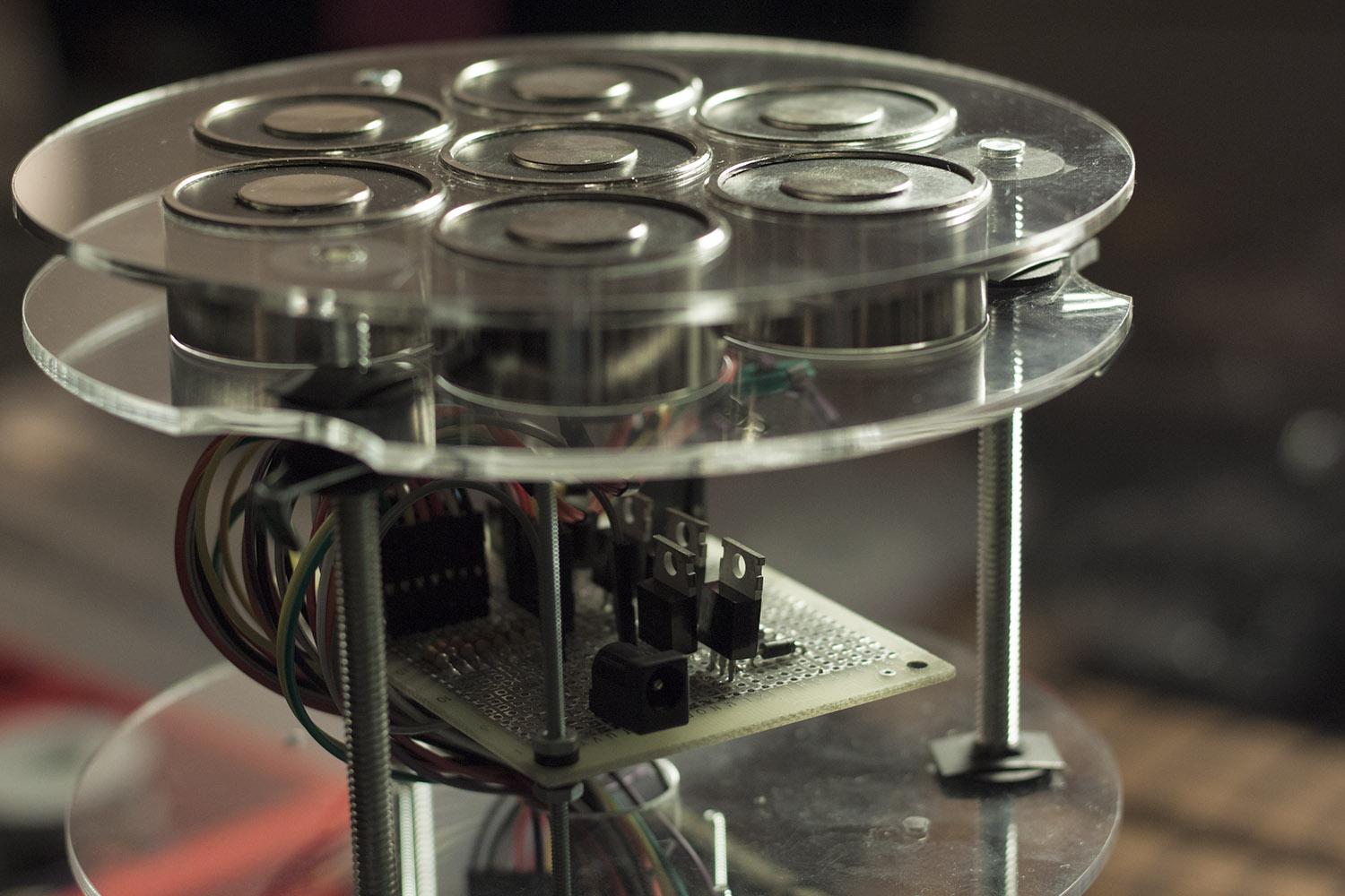

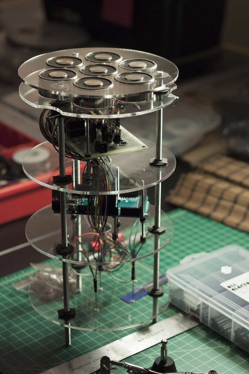

Well, the first draft is done, and it works flawlessly. Tomorrow will be the first crit, so I'm sure I'll get some feedback. and have some other things to try. I'll probably have to introduce some weights to get it to sit exactly level (which is what it will need). Overall, though, I'm quite surprised how well the production phase went. Particularly the electronics, which were completely flawless right off the bat... Never had that happen before, even building from a kit!
I'll make some videos over the next week or so, and I'll be sure to upload some photos of the install. To everyone who commented, and especially @hevans1944 and @duke37, I very gratefully say thanks! It's an rare community that's willing to engage with people at all levels of learning with such knowing and patient expertise, and that's exactly what you have here. Thank you very much!

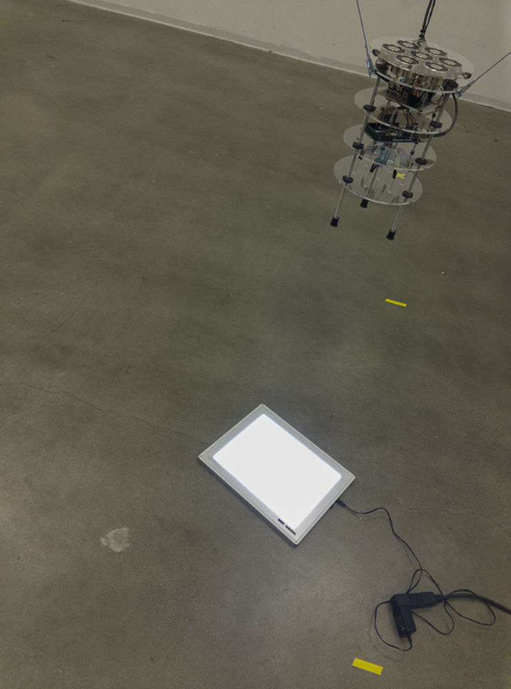

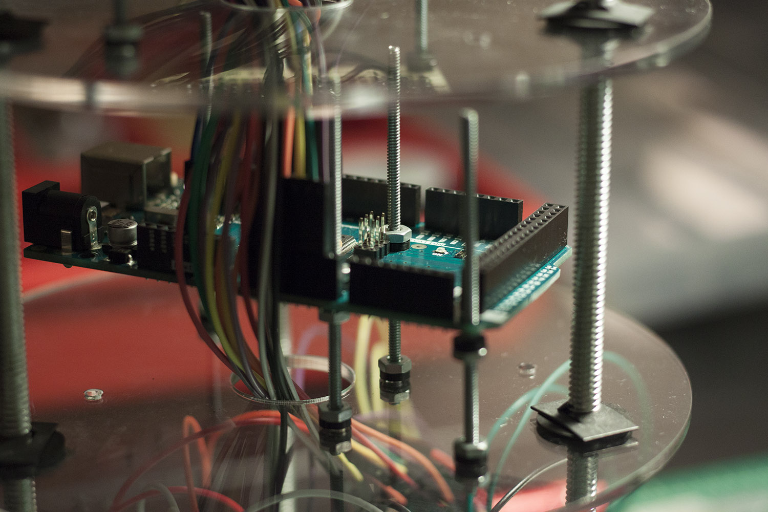

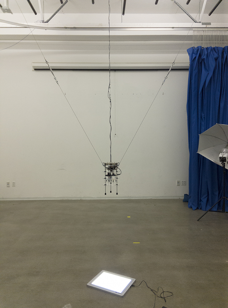

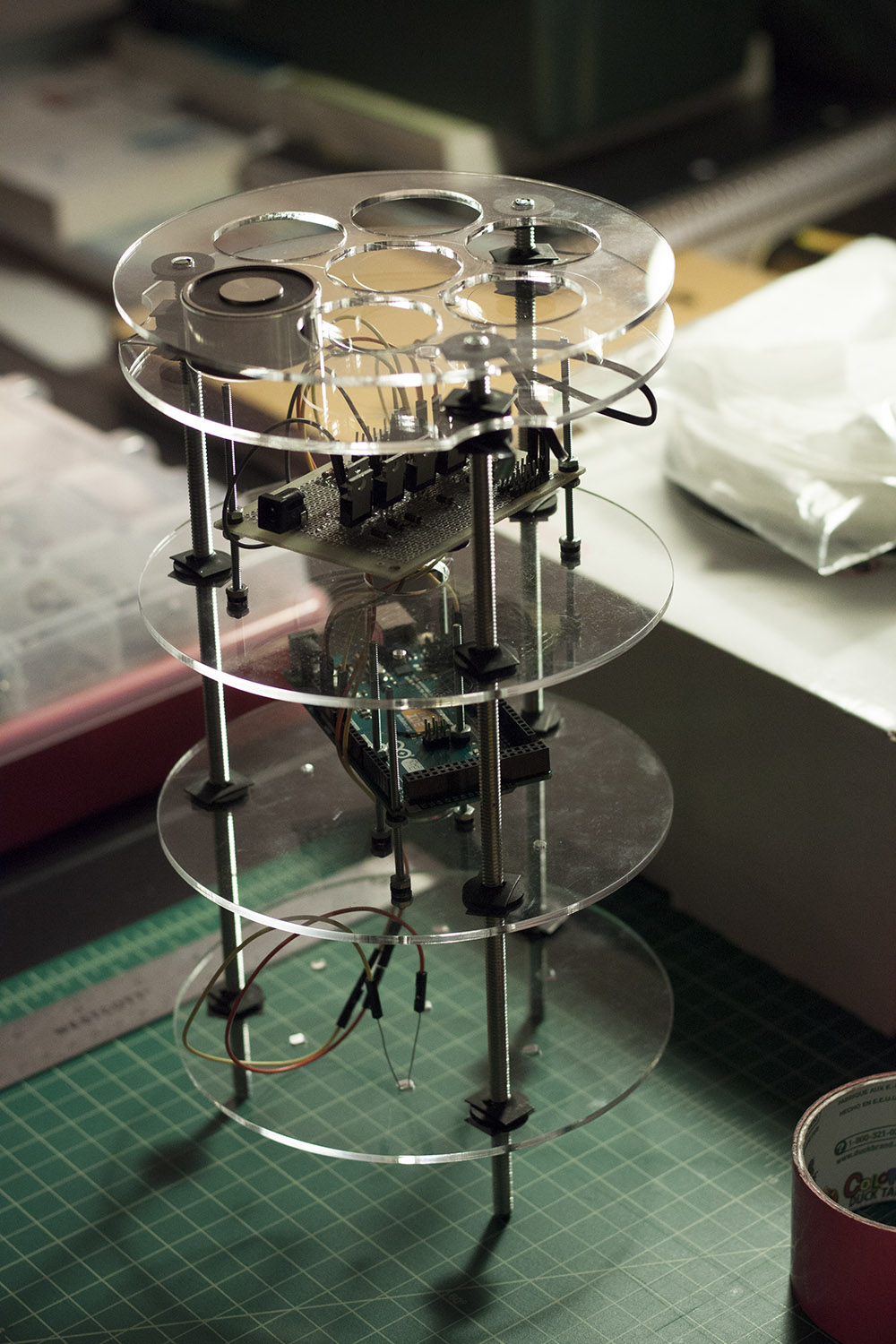

Hey guys, to close out this project, I thought I'd share some documentation materials. Here are some photos:
And here is the video I put together for documentation.
Again: Thanks to @hevans1944 and @duke37!

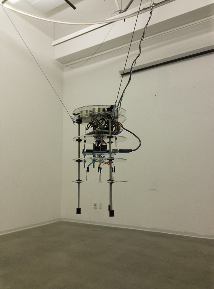

Wow! You didn't tell us this was ART! What a wunnerful display of imagination! Kudos to you!
This reminds me of a (obviously) CGI display of an interactive topographic map, now common in recent motion pictures, but that I saw most recently while watching an old DVD of X-Men a few nights ago.
Nice job suspending with three cables and turnbuckles for leveling.
