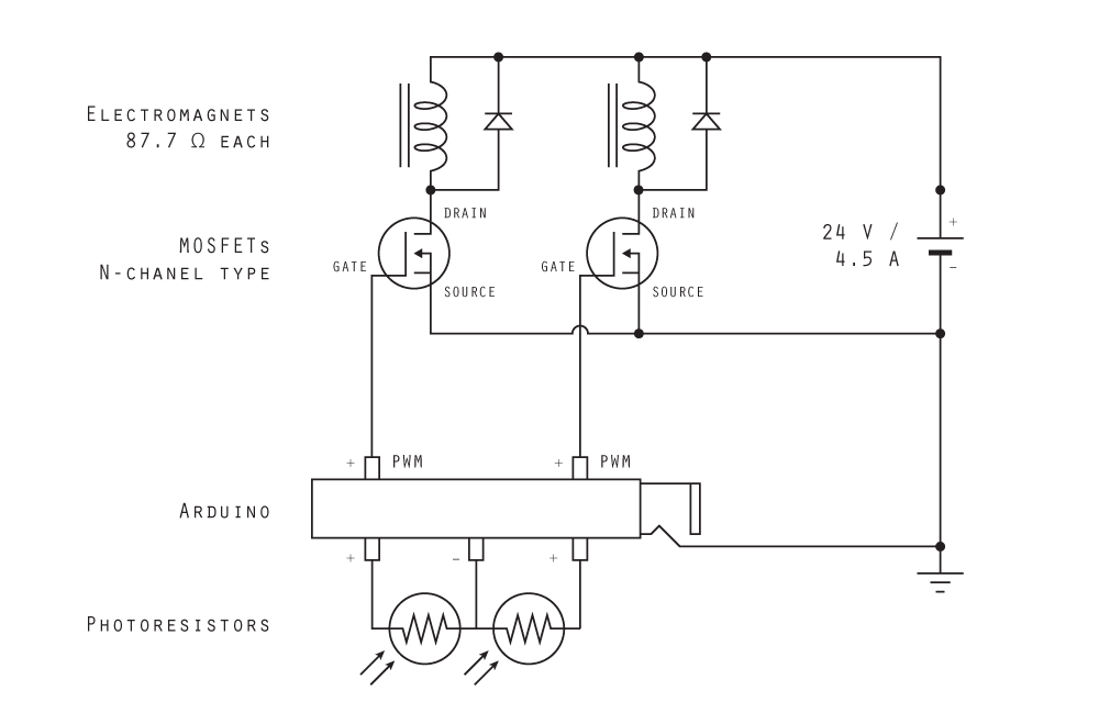

Dang, that's a problem. Or is it? Reading around, I find that it sounds pretty simple, but I can't figure out which would be the best way to approach it:
Diagram showing a connection between the ground wire of the Arduino's power supply and the 24 V power supply driving the electromagnets circuit. Would it be necessary to place a resistor in the connection from the Arduino power jack and the common ground (to isolate them?)

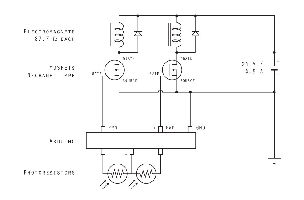

Or would this be just as good? Certainly it would simpler, because I could take care of all of this on the perf board and Arduino pins rather than having to mess with the power supplies directly.
Schematic showing a connection between a ground pin on the Arduino and the ground of the 24 V power supply. Would I need a resistor here to isolate the two power circuits?
Regarding this 'isolation business,' the Arduino forum and this article about power supplies both seem to suggest this isn't necessary. The thing I'm worried about is the effect of the current in the Vds circuit heading into the Arduino. Would this not happen? Why not?

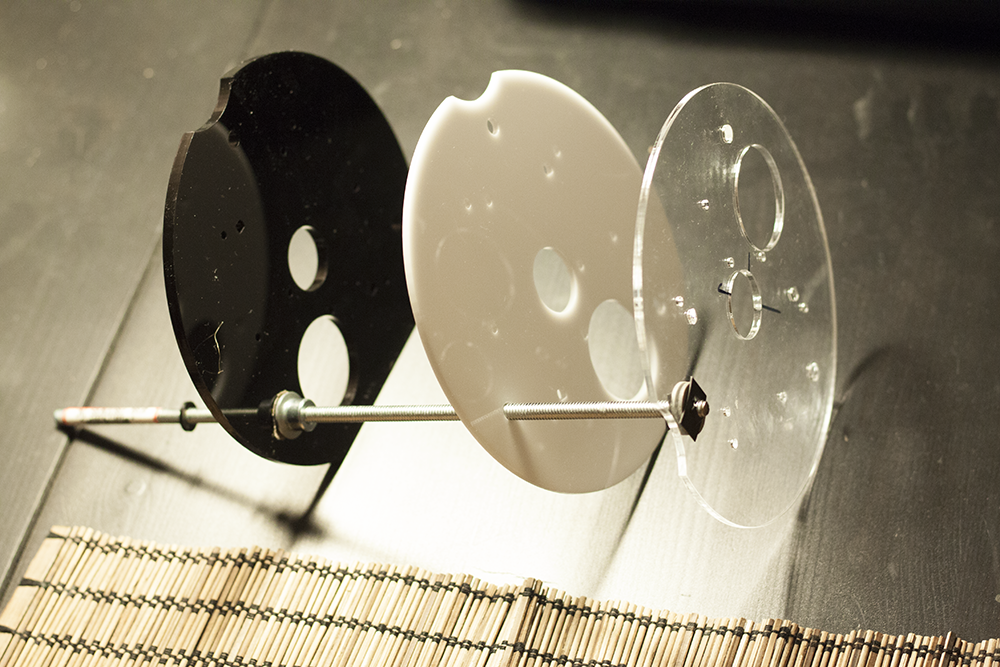

Success! I put the circuit together tonight in the second configuration above, but without the resistor, like this:
Actually, I only had one magnet and one photoresistor going. But, no resistors necessary in the ground circuit!
It works beautifully. The electromagnet is strong and variably-actuated. The MOSFET stays cool! I made a video, available here.
And I took a pic of the materials and cutting samples I had made at the fab lab today. I'm deciding on what color plexi to use. I'm thinking clear with gold etching. Haven't decided what to etch yet...
The speed nuts (the black metal thingamabob at the right end of the thread post) are pretty cool looking fasteners.
Completely thrilled! Thanks you guys!

The proof of concept video was pretty cool! Congratulations! OTOH, the ferromagnetic "speed nuts" should probably be avoided. I would recommend using all aluminum hardware, or nylon all-thread with nylon nuts. From what I've read on Amazon, the ferrofluid will be "attracted" to any ferrous material that happens to become magnetized, and since you will have some relatively strong magnetic fields near those fasteners and the support rods, they will become magnetized.
Good job figuring out the Arduino and 24 V coil supply grounds do not interact. Just avoid placing the Arduino ground in the return path from the MOSFET source terminals to the 24 V supply. The Arduino ground should attach near the MOSFET source terminals and can be 24 AWG insulated wire. The common or return lead for the 24 V supply should be a somewhat larger gauge and also attach near the MOSFET source terminals. Think of the water pipe analogy: you don't want the coil currents to appear on the same wire as the gate drive current from the Arduino
Is this nearness literally about length? Does the distance from the junction where the wire leading the Arduino's ground terminal need to be smaller than the distance from this same terminal to the power supply's ground?
...or is it about resistance, with the larger wire giving the coil currents a clearer path, and so directing them, back to the PSU's circuit?
About grounding, is it sufficient to connect the grounding circuits to the negative wires on the power supplies, or should I be running a connection from these to a separate grounding circuit?
