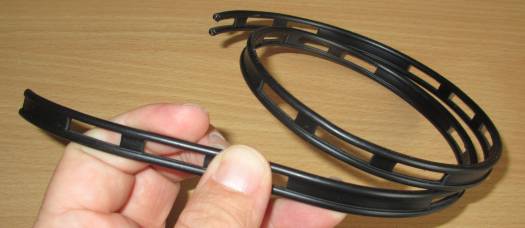

The aerial is close to the window which, I think has a metal spacer separating the glass.
The aerial is fed at a corner so the sensitivity will be maximum at 45 degrees to the horizontal. Try with the feed at the bottom or side. What polarisation does the transmitter use?
A reflector could be added to make a cubical quad which will have a drive impedance of about 50Ω.
The feed impedance of the loop will be about 300Ω. You can use 300Ω balanced feeder and then a balun to match the radio. Baluns were often used to match loops to portable TVs, I found one in the garden which seems to work on band II. I do not think that this will make a lot of difference.

A quarter wave vertical as used on a car should be fed against an 'earth' which is the car roof.
For a simple earial, I use a vertical dipole, fed in the centre. This will have a gain not a lot different to your loop.
The verticle is made from 300Ω ribbon cable. Take a piece 60 inches long and put a short 4.5 inches from each end. Cut the centre of one side of the loop and connect any length of 300Ω feeder. I hang it in the loft with a drawing pin but it could be taped to a bamboo cane. A balun will help.
The folded dipole is supposed to give a wider bandwidth than a centre fed rod but i have no means of measuring this.

This is just a folded dipole, the short is due to to the velocity factor of the ribbon cable

I'm really not impressed with your lack of response !! :(
But since I am a nice guy, I will still try and help you
@duke37 , you don't really need to do a short in from the ends like that just do the shorts right at the end of the line at the right length :)
to calculate a 1/2 wave dipole .......
300 / 105MHz = 2.858m ( full wavelength)
2.858 / 2 = 1.43m ( 1/2 wavelength)
hat then needs to be converted to an electrical 1/2 wavelength
1.43 x .95 ( .95 is the approx. Velocity Factor) = 1.358m
So get some 300 Ω ladder line as Duke suggested ( sometimes the plastic is solid all the way in the middle .... it makes no difference )
Dave
@davenn
The idea of the short is that the overall length of the aerial is half a wavelength and the short is placed where the line is resonant, taking into account the velocity factor. The value I have for Vf is 0.85, this is presumably for the solid plasic type, the ladder line will have a higher Vf, you have used 0.95 so the short can be right at the end.
If you read my post, you will see I have already taken Vf into account ...... my style is just the standard folded dipole
either way works .... mine is just easier ;)
The FM band is quite wide so the dimensions will be a compromise.
not really, anything cut for mid band will work well right across the band .... after all it is receive only :)

Thanks for the drawing, will have a try at it sometime, Obviously the aerial is the weak point in my setup. Deigh
