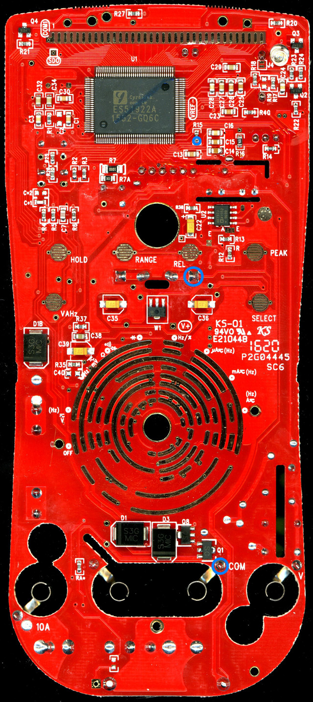

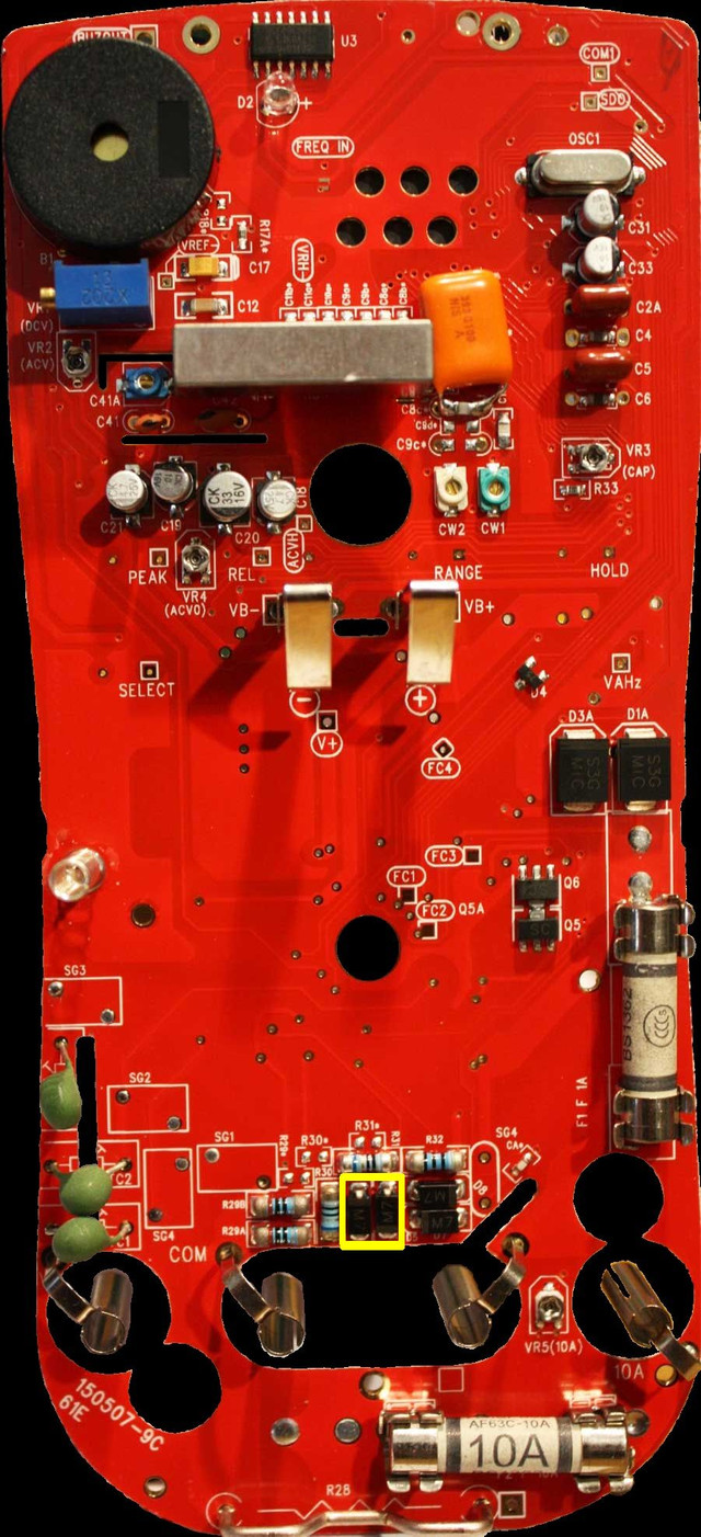

ok it will be so difficult to do such measurement since it's on the U1 side of the board connected to R15 and to have any access to it i need to flip the board which won't allow me to have the key to turn the multi-meter on, and it have no check point to measure it on the back
i also notice something the D5, D6 i put in yellow rectangle are shorted but it's not the diode it's on the circuit, cause i took the diode out to measure and they were fine , is that normal?
Solder two wi
You need to learn how to read a schematic diagram. There is a 9 Ω resistor in parallel to D5 and D6 which is what you measure as a short circuit. Measuring components while in

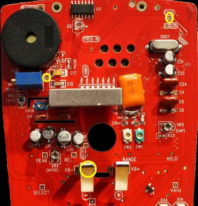

You measure between the Vref pin of U1 and ground (0 V).
ok the Vref is pin 38 not 37 i checked on the pcb, and it have a check point on the back of the pcb
and those are the messurments
Vref , com1 = 1.38 V
Vref , vb- battery = 2.91 V
[Edited]
i also removed R6 which is connected to pin 20 "OVH" i think it's the detecting voltage, correct me if i'm wrong about that
so after i removed the R6 the beeping still exist which mean the mcu is gone, also correct me if i'm wrong
According to the datasheet, pge 3 Vref = Pin 37 - that is the output where a stable reference voltage of 1.23 V should be measured.
Pin 38 is an input and is the Vref divided by R15, R16 and VR1. The voltage on pin 38 should thus be less than Vref.
Your measurement of 1.38 V on pin 38 indicates that Vref is too high (or maybe oscillating, which you cannot identify well with a voltmeter).
A wrong reference voltage indicates a defect of the chip U1. A new chip is available for ~ 20 $. That's about 1/4 of a new multimeter. Might be worth a try if you feel your solderingskills are up to the task of replacing this chip.

pin 37, com = 1.2
That looks good.
Honestly, I'm lost.
One more thing you could check: The input voltages at all the different measurement inputs of U1: pins 17 ... 29 (datasheet). Again measured vs. gnd/common.
Measure with the input terminals of the pcb shorted to avoid noise from open inputs.
These voltages should all be ~ 0 V.
