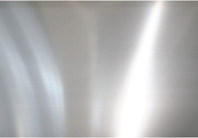

I'm building a kinetic lamp, not only do I want it to move but also be touch activated, hence the whole exterior structure of the lamp will be made of aluminum. (First question here; Will aluminum work for touch switch?) Aluminum I'm using is thin sheet aluminum from Home Depot:
http://www.homedepot.com/p/MD-Build...lain-Aluminum-Sheet-in-Silver-56064/202091748
