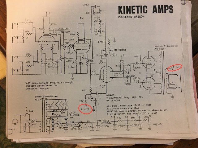

This amp was built in the 70's and I need to replace the output transformer. Here is a schematic of the Amp. My issue is that I dont think the transformer is hooked up correctly now! Red is 16 ohm, Grey is 8 ohm, black is 4 ohm, brn is common. 8 ohm doesnt seem to be hooked up to anything. Just confused. Tell me what is wrong or if its just fine.
Amp pics: https://ibb.co/kU6NBQ
https://ibb.co/iP6NBQ
https://ibb.co/iKhJkk
Schematic: https://ibb.co/fWFXBQ
On the schematic is shows the 4 ohm and 8 ohm wires and two more un labeled with a little triangle in them then going to that like with the 2 black triangles on them. What are the triangles and what is the line?

doesn't make much sense .... I see 4, 8, 16 on the output for the speaker connections
but I don't see black triangles there

OK I screen dumped and cropped the image from the your image site
not being able to download the image is a pain
so you are referring to the output I have circled in red ?

yes. I am quite sorry about that I have no idea what is wrong. But here my worries. The 8 ohm(grey) goes to nothing really, the red wire(16ohm) goes off away from the speaker jack. The only wires actually going to the jack's are com and 4ohm. The speaker jacks however are labeled 16 and 8 ohm.
OK
incorrect
the 4 Ω output goes to the lower connector
if you follow the wiring diagram, you will see that the 8 Ω output ALSO goes through the 4 Ω socket connector,
it gets shorted out when the 4 Ω socket is in use (that is, when a speaker plug is plugged into the 4 Ω socket)
the 16 Ω output doesn't go to the same style of socket, the schematic indicates that it has a different termination .... maybe a screw terminal

So let me get this all straight. When i plug into the 16 ohm jack i have 16 ohms, when I plug into the 8 ohm jack I have 8 ohms. Which one also acts as the 4 ohm then? there is only two jacks

Oh i understand! so to get my jacks to truly be 16 and 8 ohm i need to replace the 4 ohm wire with the 16 ohm wire
the 4 Ω socket ..... are they not labelled on the back of the amp ?
the schematic shows only 2 sockets .... one for the 4 and one for the 8

They are labeled but the sockets are labeled 16 and 8 ohm not and 8 and 4.

It has been modified from its original but I want to return it to stock. Someone who is good with schematics please do tell. I am trying to wire the output transformer back to how it is supposed to be. What wires need to go where. I have one output jack with 2 terminals and one with 3. I am assuming that com goes on the 3. Note that red goes to a feedback thing and I know that the red one is fine. I just need to know where the black, grey, and brown wires go. also, right now the com is going to the output jack and it says it needs to go to ground. For the other three wires to go to the jack that will need to go elsewhere, where? Thanks!

You don't say anything about how the two output connectors functioned when they were "stock". It looks like one is connected to the 8 ohm tap through a switch in the other that also connects to the 4 ohm tap. How are the two connectors labeled on the outside of the unit, and is there anything in the manual about what is supposed to happen if both connectors are used.
Also, not the best schematic symbol for the connectors. It is not clear which are the tip, ring, and switch contacts. Photos of the connectors?
Finally, how are things connected in the non-stock configuration?

The two connectors are oddly enough labeled 16 and 8, and I would like to get it back to stock so whatever the schematic says. the jack that is labeled 16 ohms has two connectors on it, and has the 4 ohm wire going to it and then the other connector has a wire going to the 8 ohm labeled output jack. the jack labeled 16 ohms however has com going to it, the wire bridging the two jacks, a wire going to where the 16 ohm is conencted shown in picture and thats it. 16 ohm is going to FB 11 which is a part of a feedback thing and 8 ohm is sitting by itself on a terminal with nothing connected to it. Red is 16 ohm, grey is 8 ohm, brown is 4 ohm, com is black. I am not sure what this switch you are telling me is about.

In your first photo, the jack o the upper right is similar to this:
20pcs-lot-3-5mm-Mono-Headphone-Connector-Jack-3-5-Mono-Audio-Female-Jack-with-Switch.jpg
The hole is the sleeve contact. Notice to the right that the tip contact has an extra piece of metal touching it. That is the switch pin. The tip and switch are a normally-closed SPST switch. When you insert the plug it moves the tip contact away from the switch pin, opening the switch. This is a very common part, often used to divert an audio signal from the speakers when you plug in headphones. In your case it is doing something to manage two output impedances and the way they interact with the speaker. The problem is that the schematic symbol is not at all clear about which part of the connector is which.

What is my amp wired to do right now? The 16 ohm is where is should be I think but what is it doing now with the 8 ohm connected by it self to one terminal, 4 ohm going to one, and a wire going off the 16 ohm to the other jack. Both jacks are connected to eachother. Just a bit confused. How can I test to see the current impedance of each jack

You need to feed a high current signal into the wires on the output transformer to calculate the impedance which is difficult. Instead simply measure the resistance to ground of each output. 4 ohms will be the lowest and 16 ohms will be the highest.
Here are schematics and terminals of switched jacks:

So how do I hook it up like the original schematic. I already know red is 16 ohms grey is 8 brown is 4. Red is already where it should be.

The schematic shows where the wires should be connected. The switch on the jack is shown when no plug is inserted thyen the top jack is 8 ohms. When a plug is inserted into the bottom jack then it becomes 4 ohms and the top jack is disconnected.
