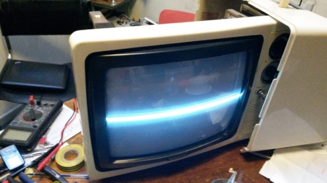

Hi,
I am trying to make something influenced by these projects:
http://www.instructables.com/id/Fully-Functional-Television-Oscilloscope/
http://www.crackedraytube.com/pdfs/oscillographic_tv_tutorial.pdf
the idea of the project is to put a signal into the horizontal and vertical deflector coils on the CRT in order to create a visualisation of that signal
the TV i have found for it is an old HMV A3301
I have isolated the 4 wires that connect to the two coils and if i disconnect the vertical coil control wires (brown and grey) i can get a horizontal beam across the screen.. then when i connect my signal to the those wires i can get it to slightly deflect up and down with the change in signal.
according to the instructable i linked to, the horizontal scanning frequency is way too fast for the signal and the coils need to be swapped so that the 60Hz vertical wires from the board are running the horizontal coil
the only problem is that when i disconnect the red and white wires that are the horizontal coil wires, the TV wont turn on any more
it works fine when i run it with the vertical control wires not connected, but not horizontal.
the pdf that i linked to suggests that some TVs don't work unless you use a "dummy coil" to trick it into thinking that the wires are still connected so i tested the wires for their impedance and i got the following information:
brown/grey - Vertical: 56.5 Ohms
red/white - Horizontal: 3.5 Ohms
I put a 3.9 Ohm 10W wire wound resistor in to try and replicate the coil, but when i try to turn on the TV it doesnt work and the fuse next to the big capacitor keeps blowing
Is it strange that there is such a large difference in impedance beween the two coils?
could it be that i need a higher power resistor to act as the coil?
Is there anything that anyone can suggest i do that might solve this problem?
