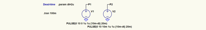

thank you I've figured it, now I need to know is gate capacitance the same as input capacitance, output capacitance or feedback capacitance and also I need to know how to setup an anti-phase signal

Here's an example of generating anti-phase signals with dead-time defined by the dt parameter:-

Okay so that means abolutely nothing to me but thanks for the answer also do you recon the transformer I have (300watt 230v transformer) will be in micro or milli henrys and I see something about dead time. what does .tran 100m mean. I aso am still trying to determine if, is gate capacitance the same as input capacitance, output capacitance or feedback capacitance?
by the way I'm very greatfull for the help. sorry if I come across a bit ignorant im new to this. could you talk me through making the anti-phase hook-up
I think it has something to do with the spice directive
also I want it to be square wave, probably important
