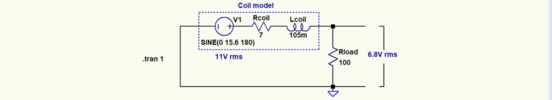

By my reckoning, that indicates a coil inductance of ~105mH, if the coil resistance is 7 Ohms.

That should increase the output voltage of the coil, since the magnetic flux change will be greater as a magnet passes the coil. Somewhere on line I read that generator efficiency varied as the inverse fourth power of the air gap; but the coil involved was a pancake type in a different magnetic circuit configuration, so that figure may not apply to your coil design.
This is how I'm simulating your coil:

so what are the 15.6 and 180 for?

like this?? surely the frequency is 600rpm / 60 for rev/sec =10 times by norths =9 10* 9 = 90Hz or is it the amplitude which I don't get because it reads 11 but that may be because of the 11 being RMS and 15.6 is peak to peak? and I don't understand why it's 180 degrees out of phase??!!??1707585907294.png
I was working on the basis that each pole, whether N or S, produces both a +ve peak and a -ve peak in the coil signal because the coil's bolt diameter is much less than the magnet diameter and there were gaps between poles. That means one signal cycle per magnet, making the signal frequency 600/60 x 18 = 180Hz. If you have access to an oscilloscope you could verify if that is correct.
11 V rms has +- peaks of 11 x root 2 = 11 x 1.414 = 15.5V. Spice sine-wave amplitudes are specified by the peak values.

If you use 90Hz as the sine frequency, then the coil inductance to give 6.8V rms across the 100 Ohm load would be twice as much, i.e. 210mH.
