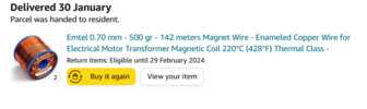

I think there are 28 layers = (20mm / 0.7mm)
Looks right. I was thinking 14 per cm but omitted the 2cm. My bad. Guestimate re-called from this thread.
With 2800 neat turns, average diam 3cm, turn circumf = pi*3 cm, wire length = pi*3*2800 = 264 metres. Doesn't sound right.
If 264 metres, with copper density 8.94g/cc, that would weigh 909gm. So we're out by a factor of nearly 2.

ok now I have the magnets stuck and will upload picutes after 6, its dinner in 15mins and I actually do have that information didn't think to check1707410692540.png

so I might add that they are not the neatest wound coils in the world but I think they shall suffice to be fair!

does look rather good perhaps combining the information that it does give with core dimensions for instance we can find a better number more realistic to that of real life, thanks
