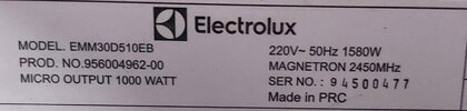

Hi Guys,
I am trying to fault find a Microwave PCB so i am testing components to see which are faulty...:rolleyes:

Hi Guys,
I was just teasing it out of you. (pun intended).
Make,model,of microwave please.
I will see if I can't grab a schematic for you.

Now you're teasing me,that info would be nice, while I'm looking for the schematic can take another photo thank you

The Microwave stopped working as nothing happened when we pressed any of the buttons. I opened it and found that most of the buttons needed replacing. After that when pressing start the magnetron did not operate, I checked all the door switches and they where fine, it appeared that the board was not supplying voltage to the magnetron. I found the EE16transformer not working, and I am awaiting the new part arriving. So i decided to check through the rest of the board for other faults.
