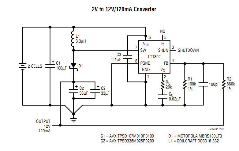

i've seen this diagram on LT1302 from LT datasheet and tried to adapt it randomly to my needs.
(http://cds.linear.com/docs/Datasheet/lt1302.pdf)
My goal is to get 5V out of that IC, but I failing big time. Any sugestions of a design that lets me have 5V and a max of 500mA or more from it?
