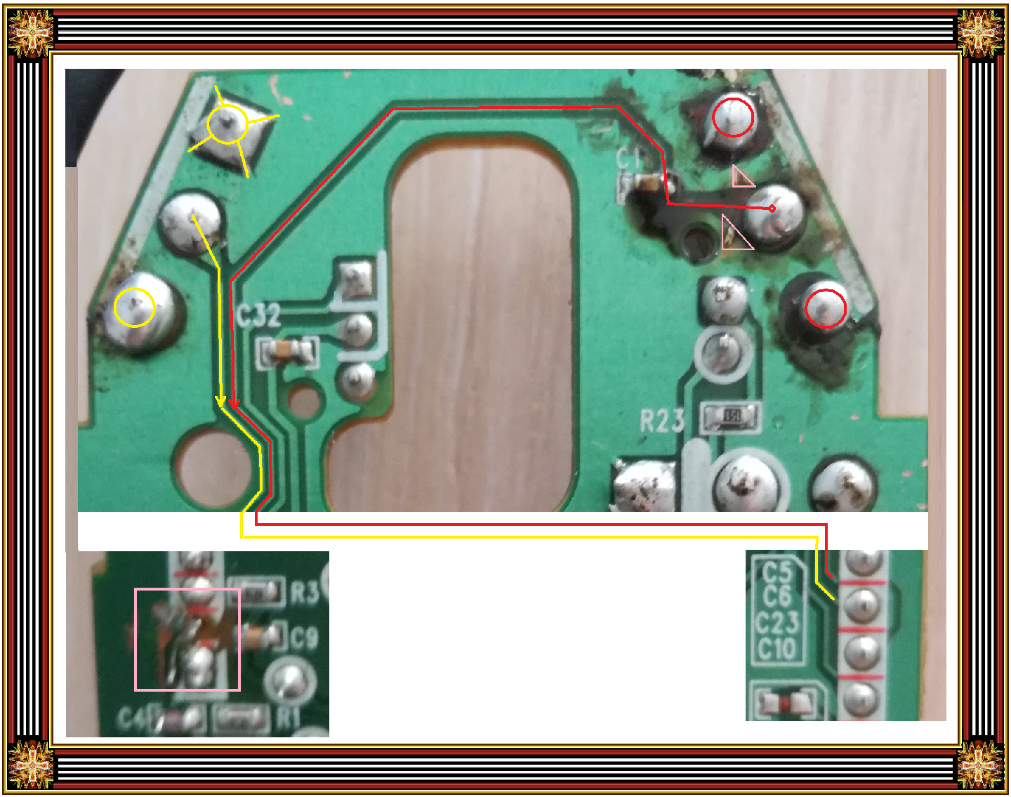

Hello guys, so on my Logitech G100s left click started to double click and I wanted to solder it out and put new microswitch in place.
I did this many times, changed right click it was working perfectly but left click isn't working at all.
I tested microswitch itself its working properly.
My opinion is that there was a break on circuit board, so I scrapped it with scalpel and tried to connect it with one small wire. This didn't worked properly, whats worse even mouse movement itself wasn't working properly after this, I probably connected it wrong and I don't know what to do now. Mouse movement is functioning, right click is working but I don't have left click. Pictures links are below!
https://ibb.co/m0ZhR7T
https://ibb.co/Xp9kPwc
https://ibb.co/3k7ZrbT
https://ibb.co/ZJK6Ldt

Sir Sikorsky . . . . . . . . .(Luv your choppers )
Well, I can initially see that you are NOT the one to be replacing the unit being shown in your avatar.
Check my sections being referenced and use your eyes to confirm . . . . . as you have the board in hand to PRECISELY examine . . . I don't.
You can see that on the left . . .YELLOW MARK UP . . .of your unit that the YELLOW circuit connections both MECHANICALLY MOUNT that micro/tact switch and electrically make one ends connection to the board ground plane thru its 4 radials.
Pull out your ohmmeter and place in lowest ohms scale and connect one probe to the center electrical connection of the switches drawn in YELLOW connecting line and trace it on down to the encoder chip, and see which terminal it ends up connecting to . The ohmmeter should tell you with its near zero reading. Its being hidden from MY view by the solder resist coating on the top..
The connection that is just above it will be the one associateted with your "PROBLEM" RED electrical connection line.
So o o o o o trace that RED line back to your other RED marked up area and it end up at the center of that switch, just as it was treated on the other side, except for them adding that C1 block monilithic ceramic bypass capacitor C1. Note that I didn't show the RED radials on this switch, because i couldn't see them, but they have to be there . . or at least 1 of them.
Don't know what's going on at the PINK traingle areas . . . . . but the only connection to the switch center is the RED foil line.
Look up solder wicks purpose and use and then use it at your excess solder blob areas to end up with the equal amount of solder on a connection as you see around the rest of the untouched areas of the board.
PLUS . . . . clean all of the EXCESS fluckin flux off the board, with a stiff small brush and some alcohol that you purloined from Granny Goodknockers medicine cabinet. Or, some denatured alcohol from her fondue heater .
That flux residue looks like OATEYS plumbers flux*** . . . . . try using some rosin based flux.
If it is *** get it TOTALLY cleaned off, or you won't have any board foil present in that affected area aftter about a year.
Its being really too much out of focus-es-es-es . . . . .but . . . . .
Else where, in the bottom left quadrant of the board, looks like you might have used a bare Cu jumper wire on a foil trace bypassing / repair , along with some " melt and drip " soldering.
So o o o o o o o . . . . .initially. confirm the continuity of that RED lines run and we proceed from there, if that isn't being all of your problem.

BOARD PHOTO . . . MARK UP AREAS . . . . . .

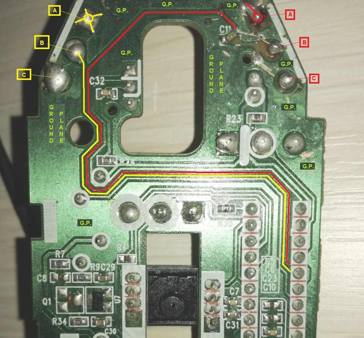

Hello!! Thank you for your answers, I didn't know someone would be willing to help me with this one! I was expecting someone would say "Time for new mouse" or something among those lines, but no! I was wrong!
Now that I was looking at your pictures, I tested yellow line with multimeter and it was indeed on C6 line.
Red line above didn't had connection on left click. Two pink triangles is what I cut with razor blade, because while i was soldering there the two lines kinda got chopped out... its very fragile..
The other pink square at bottom left is few years old when I tried to remove cable and it rip out portion from board, so I went for electronic store to repair it.. I would go now too, but its closed and I really wanted to try everything in my power to be able to save it before monday... But one thing I learned from you now that I can trace where electronics are going! And with this I can fix my mouse for sure.. anyways.... I found on youtube exact same mouse and its clean fresh unscratched board! So I will link it here too

You say . . .
So now my question would be, do I connect middle left mouse switch to C11 from one side and to other side of C11?
You can see on his photo that the foil path is leavingthe center of the micro switch and routing to C11 where it makes connection and then continuing its circuitous path down " The RED brick road " . . . .
The other half of C11 connects to the ground plane foil mass.
I also marked the RED circle where the radials extend on out to the ground plane.
C5 is located W a a a a y on down, MANY pins lower than your two involved lines, and is not even being involved with your two circuit paths..
I can see now that your flux deposit covered up half of C11 and thereby made my C1 read that way.
I'm not even sure what C11 is for
It's being used to bypass that RED circuit line to that ground plane.
Somehow they don't look to be bypassing the YELLOW line, but they are using C32 for bypassing the detector phototransistor outputt, associated with your center roller wheel, that disrupts that optical interruptor pair..

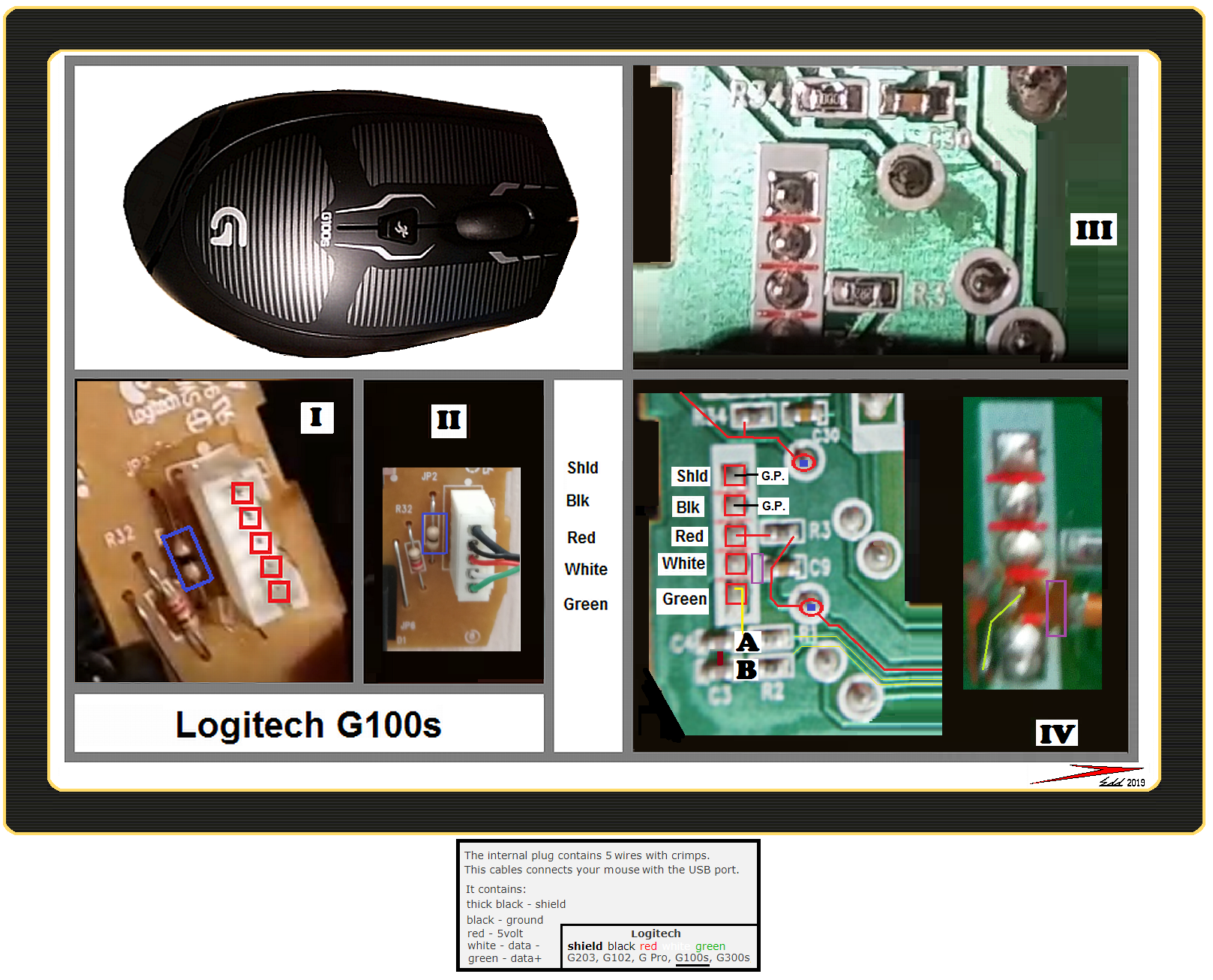

I managed to solve left click by brushing more on top contact of switch to connect it to ground, then I lost C11 SMP component, so I unsoldered same one from one dead gpu card that I keep in drawer since 2009, never knew what it would be good for but today came the day to use it :p
After I somehow managed to solder C11 to ground and I made new scratch carefully onto red track.... and I soldered wire and other side of SMP together and then connected wire with middle contact of left switch, it worked like charm, but I didn't clean contacts yet I wanted to test first if its working... It did, but then I screwed up my flux spray sprayed all over the PCB and I was after cleaning with alcohol, and this is where I scratched Data- cable that was soldered before... And I tried to solder it back but mouse still didn't worked, this is where I got checkmated I don't know what else I can do...
Left and right clicks are working properly now.... After spending like 10 hours with mouse and watching additional tutorials and everything i finally made it work, but now issue is this area
https://ibb.co/6JhxV1K
This is not current state, I tried to repair it... And kinda messed it up.... I will take picture of it how it is now...
When I plugin mouse, mouse arrow doesn't show and I don't see red infrared light turning on either, basically mouse is dead
I just hear beep boop USB sounds... :( Such a mistake to touch it with brush after i applied flux. I should apply it only on ones that i was soldering not this one, lession learned to never touch anything thats working already :(
https://ibb.co/j6wjqQZ
https://ibb.co/VWNQWRN
https://ibb.co/JyH4qmD
https://ibb.co/KmfgJMq
I found old picture on PC from few years ago, when I was asking how to unsolder these... But you can see factory new Data- Data+ 5v and Grounds hope it will help you to at least see how it was before I screwed everything up..
https://ibb.co/x1Dcwdf
Took few pictures hopefully at least one will show it well :/ this is how it looks like currently... Is Data- connected to ground? If it is, that would be easy fix :S I couldn't find what to connect it to
I tried to find what is Data+ connected to, but I couldn't find any contact either, and I'm sure that one is working properly, so I had no clue where to connect Data-
Lession learned definitely not to touch what's working... I hope I will be able to repair this with your help..
Also, thank you for helping me so much already, I hope we gonna pull this off XD

Lets initially do some analytical LOW ohm testing.
Your YELLOW area has too large of solder blobs built up at Yellow B and Yellow C.
If YELLOW C has accidentally connected to the GROUND PLANE surround, it could simulate a continual activation of that switch, even though it has not been pressed down IF that switch is being a SPDT type.
Also that condition over rides any other switches action . . . . .first come first served . . .until released.
TEST A . . . . .
Since your RED A-B-C areas have more normal solder joints lets see if we can test them first.
Stabbing ohmmeter probes into RED A and RED B should show an open circuit, then if you click that microswitch button, a short circuit should show with the metering . . . thus, all is well . . so far..
TEST B . . . . .
To now confirm the microswitch type . . . . ohmmeter probes are placed across RED B to RED C, see if it shows a short and then click the switch to see if it changes to an open circuit.
RESULTS . . . . .
If the test of RED A to RED B agrees with the above, all is well with that switch.
If the test between RED B to RED C agrees with the above then we have a Single Pole Single Throw type of switch configuration.
If the tests of RED B to RED C agree with the above, we have a Single Pole Double Throw type of switch.
In which case, the RED B connection normally rests on RED C connection, but upon button activation, it swings over to make contact with RED A connection, for the time of activation.
If RED B to RED C connection always remains an open circuit, irregardless of switch activation, we have a SPST switch and the RED / YELLOW C connection is of no relevance on either RED or YELLOW switches..
Sooooooooo the aforementioned YELLOW C solder blob shorting to ground plane would not create a fake switch on condition.
FURTHER TESTING . . . . .
Move back to YELLOW A to YELLOW B with the meter probes and that should be readingas an open circuit. Activate the microswith button and a short should develop for the pressed time period.
Repeating that test with RED A to RED B should give the same results.
One question now is being relevantt to the the C11 block ceramic surface mount unit.
I can see the left side being OK with its connection to the massive ground plane at its connection point.
Then am I correct that the original fine foil trace is good from the 45 deg bend at the top ( within marked in fine GREEN circle) down until it connects to the right half of that cap ?
Then I see your fine cu wire add on to reach over to the RED C connection..
From my mere 2D viewing perspective, that right C11 connection seems AWFULLY close to that ground plane mass, just to the right, beside it.
If there is a connection created it will be equivalent to a closed switch condition.
A surgical scalpel or #11 Exacto blade in its handle would permit cutting and peeling off, some of the adjunct ground plane for greater clearance / proximity of that right C11 connection.
AL FIN . . . . .
Place one meter probe toYELLOW B and look down to your encoder chip and I have that YELLOW foil path maked . . . UP TO . . . the point where it disappears underneath the white silk screen coating / resist. Using the other probe to each of those nearby I.C. pins should show a short to the one that the YELLOW foil is connected to . Keep that probe on that connection and take the prior connection of the other probe to Yellow B and move it up to YELLOW A. Now if that microswitch button is presssed, it should show a short, indicating all is well through the switch to the decoder pin connection, then as the switch is deactivated, an open circuit should be present.
Repeat the same test sequence for your twin RED switch and its path of the RED marked up section.
On that one search, at the decoder IC you might suspect that the required pin will be one pin up higher, just judging by the lay of the YELLOW and RED foil paths..

BOARD REFERENCING . . . . .
https://i.ibb.co/rspV4Ln/Optical-Mouse-Circuit-Trail-II.jpg

But but... problem is there in this part, Mouse was working until I moved that soldered wire..... and now as you can see it looks like bomb fell on it. I don't know where to connect this Data- Pin on board ....
0YZRWxg
https://ibb.co/s5GpX4Q
as you can see before it had wire connecting it... but now that wire fell down and i tried to scrape with screwdriver to seek for connection there but I couldn't find where to connect it to....
As I say Mouse was fully functional with clicks, both clicks are working perfectly..
Only issue is this Data- part, because of it mouse cursor don't even appear on screen when I plug mouse in

I digitally dithered and mean averaged the info into a higher pixel count image in order to get the enhanced inset display at the very top photo enhancement. There, I can then see that there is a surface mount 000 ohm resistor / jumper used to jump transfer +5 Vdc power across, at the top path of the mouses power supply line.
Also down at the RED lines +5Vdc input there is an R3 . . . 2R2 ohm . . . leaded resistor that then immediately gets bypassed to ground with a C9 monolithic block ceramic SM cap of probably a 0.1 ufd value.
That series resistor is assuredly being there to protect the DC USB supply of the host computer in case of a dead short occuring in the mouse power circuitry. That would hold loading down by a short to only ~1/2 amp.
INTERCONNECTIONS . . . . REFERENCING . . . . .
The first photo ONE reveals the use of 5 connections, with their color coding and layout .
BLACK Heat shrink covered wire . . .should go to the ground plane.
BLACK insulated wire is power negative and should also go to that ground plane
RED insulated wire is being the +5 Vdc line that passes thru a 2.2 ohm resistor, and gets bypassed to ground with ceramic cap C9 and then passes down a foil path downward.
The first two BLACK shield and ground connections should be a given, with them not having been tampered with.
Lets trace out the RED pin,next, by having no power to the unit and initially ohmming out from the RED connector pin to the left side of that R3 . . .2.2 ohm SM resistor and then read the other side of the resistor where you should read that 2.2 ohms of added resistance. A foil trace from there, slants down to the left to connect to the left side of a 0.1 ufd SM ceramic capacitor for bypassing the power line to ground with its other half connecting to the ground plane.
My VIOLET rectangles signify that there is adequate dead space between the left side of C9 and the adjunct WHITE pin to its left.
This is also marked on your photo to the right, where you had scraped off some white silk screen ink / resist . That further confirmed it.
The power path foil then passes further down and takes a turn to the right to connect to the round foil land of a resistor ( Zero ohms jumper - JP2) .
This is being a branch out point where the RED foil path connects power to the RED foil path that further extends on at a downward slope to the right to supply power to that board area down there.
The other path is the BLUE square connection of that earlier marked BLUE rectangle JP2 / 0 ohm resistor that passes upward to be the connection to that round foil circle at the opposite end. That then has power going upward / left on a foil path to connect to a R34- 000 ohm SM jumper and the RED foil path then extending on up above R34. That foil path gets power to the top of the circuit board.
Confirm that all of that is allright, with no grounding out.
That now leaves the two, side by side, fine YELLOW lines coming up from the bottom right corner from the encoder chip.
Tracing those foil pairs, upwards and to the left, finds the top one mating into R1 and the bottom one into R2. Being like value resistors with the left sides of the resistors connectig into companion C4 and C3 for bypassing of those data lines to ground.
NOW . . . . your two data connection points will be the BOLD A and B junctions.
See if there is a foil path sgoing traight down from GREEN pin via the YELLOW path to BOLD A junction.
An ohmming out will reveal such a connection.
If so, all of that connective foil path is original and intact.
The sole floating connection now would be from WHITE pin and down to the BOLD B junction.
AND on my provided photo I can plainly make out a thin foil trace that is where my short BROWN mark in is.
Seems like the trace would originate at the WHITE pin and drop down and pass thru the dead space between the end caps of the C4 and C3 ceramic capacitors and then re-route sharply to the right, to connect into the C3 / R2 junction.
BUT this trace is being MOSTLY hidden by the WHITE ink overlay at the start of the trace.
By your photo over to the right, it seems like my LIME GREEN line is where you added in a piece of CAT-5 wire to make a soldered trace interconnect.
I would also use a short length of WHITE insulated CAT-5 wire, with a fashioned bare copper end loop around the WHITE pin and dress hat wire to the left to make a right angle bend downwards in it, to then route down and make another right angle bend into the BOLD B junction with a bared wire tip.
If you initially found a WHITE pin to BOLD A direct connection, that should be answering about BOLD B's connective situation.

" Also down at the RED lines +5Vdc input there is an R3 . . . 2R2 ohm . . . ( leaded ) SM resistor that . . . . . ."
Additionally . . . . .
" AND
on my provided photo I can plainly make out a thin foil trace that is where my short BROWN mark in is."
Digital processing induced a color shift,such that the resultant BROWN, came out transitioned into a short and wide RED mark in.
I checked this everything is connected as you told, but when I test it says 500 on ground while doing continuity test, meanwhile on Ohm test it shows 1, no continuity, so I guess that's okay.
This part was okay too
There is no connection between GREEN pin to BOLD A and GREEN pin to BOLD B, ohm meter shows 1 its open circuit, no connection at all
Thaaaaaaassssssit . . . . .
There is no connection between WHITE PIN to C4, C3, R1, R2... No connection at all with white pin, same as no connection at all with green PIN.
Only connection is further C4 right with R1 left
C3 right with R2 left
_______________________________________
So issue is that White and Green pins are not connected to R1, R2, C4, C3,
Without having these DATA+ and DATA- connected, mouse doesn't work...
We found where problem is, now what do I do next, what to solder onto what?
Can you post me photo of where to solder wire from WHITE Pin onto where?
And Green PIN onto where? Not sure if it goes to R1, R2, C4, C3 also both of them have left and right connections, not sure where at all...
You say . . .
So go to that very small BROWN (RED) run of foil that I marked up on the drawing and place one meter probe in its center and rotate to be sure that contact with the copper is made by piercing any insulative resist covering .
Use the other meter probe to confirm if any continuity is made to the four above points.
If just one connection is confirmed, then I believe that a gentle scraping off of the white resist paint will let you find the original foil paths hidden underneath the paint up close to the left side of the 5 pin connector..
That then confirms as being as . . . . .
You are saying . . .
Your connecting point will be at my mentioned A and B points with the interconnecting GREEN and White wires from the 5 pin connector.
