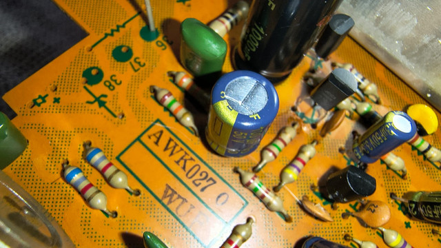

Hello,
I have Pioneer LX-424, but I see it is almost the same as SX-424.
So 10 days ago, the left channel started to produce boom boom sound even though nothing was playing.
So a friend of mine suggested that I change all the electrolytic capacitors and transistors on the amplifier board, because it's about 50 years old.
Therefore I did it, on AWK-027 board I changed it all: electrolytic capacitors, transistors, resistors at output transistors, and few small capacitor.
but I also changed the diodes, capacitors, and transistors on the power supply (AWR-041), but I did not
changed zener diode on because I forgot to buy it.
after that I put everything back together, turned on the device. and the left channel that was causing problems, now works perfectly. however the right channel that worked before, now doesn't work at all. absolutely nothing, no noise or anything.
The first thing I checked with a multimeter was the output transistors in multimeter continuity mode, Does the metal housing of the transistors touch the heat sink?
After checking, I found that they don't touch.
Also I don't know if this is normal, I have put one probe on GND, and the other one I touched the emitter pin of the output transistor Q17, and in multimeter continuity mode,
multimeter produces sound. Same situation is with output transistor Q18.
The fuses didn't blow, nothing exploded, nothing smelled of burning or anything like that.
I tested the speakers in A, B, and A+B, but in all modes right channel does not work.
Also I have multimeter TOOLTOP ET2010A which has 1MHz Oscilloscope mode.
Please help me, where did I go wrong? and what can I check now and how?

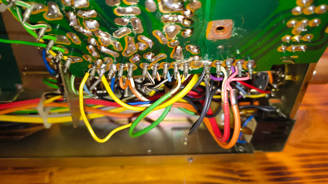

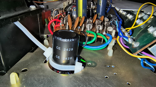

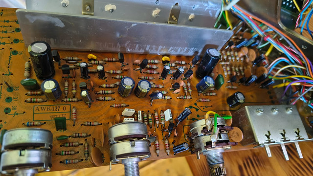

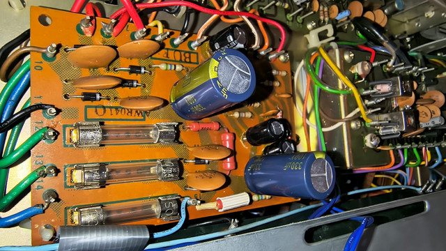

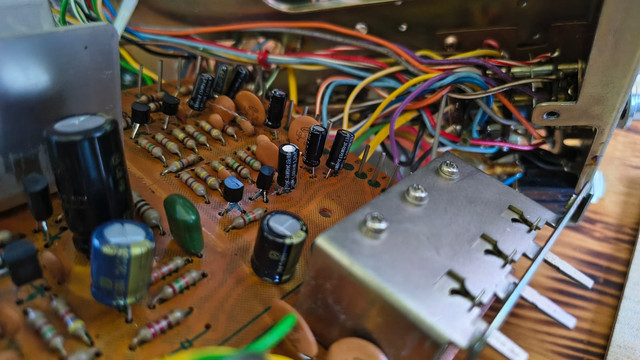

Hi,
can you download the schematic from here: https://elektrotanya.com/pioneer_sx-424_am-fm_stereo_receiver.pdf/download.html
I downloaded it from here too.

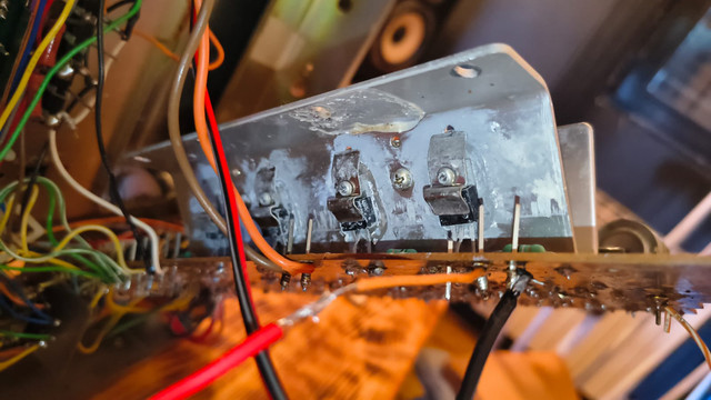

Yes, I have appplied the insulation between transistors and heatsink.

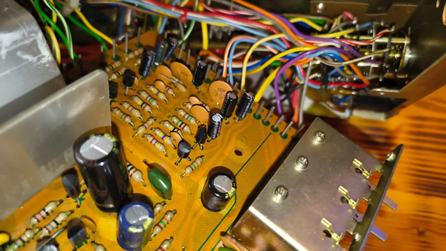

I also cleaned everything before I put the new one in. Additionally, I put a thin layer of thermal paste on the heatsink, then I put insulation on it, and then I put a thin layer of thermal paste on the transistor, and that's how I pressed everything in.
I used a multimeter with continuity mode to measure whether the transistor was touching the heat sink, by touching the heat sink, and with the other probe I touched the metal housing of the transistor. Neither one rang.
I checked several times, and I believe I put everything in the right way.. wouldn't the capacitor explode if it was turned the wrong way?
After looking at the schematic, can you tell me exactly where and how to measure voltage of the power supply?
and what else can I do ?
on the power supply board, connected c11 capacitor. instead of 220 uf, I put 330 uf. could that be a problem? I put the others of the same capacity.
also you can take a look some images:
Thank you

Hi, it look like the pream is OK since the headphone have both channels.
The emitter of Q17 is at 0.5 ohms (R77) from ground, that may be direct enough to trigger a continuty signal from some multimeter.
But it didn't look like a problem, unless it's really measuring less than 0.5 ohms on the resistance reading.
The power supply connector may be separate for the test.
On an unloaded PS confirm the 25.5v dc on pin 4 of the Power Supply connector...
The 13 v dc on pin 1, the 36v on pin 7, there should also be an unspecified voltage on pin 2 for the S1-1r selector and pin 15 for the dial lamp.
That's i would check...

Hi,
Unfortunately I didn't explain it well.
the left speaker worked normally, the right did not work at all. After that, I plugged in the headphones, then the headphones worked, but I wanted to find out if both channels worked on the headphones. So instead of the headphones, I plugged in a cable that has a 3.5mm connector on both sides. And then I found out that the right channel still did not work. A few minutes later, the left channel stoped to work also..

Hi,
i have tested, and i receive 25.6 volts and 13.8 volts.
But I dont receive 40 volts.
for some reason both fuses are blown in box 1.2 A x 2 from schematic.

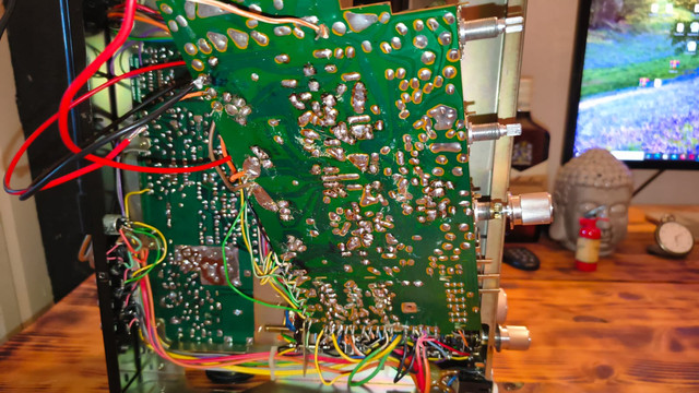

I managed to solve the problem, the problem was in the switch where I select a, b, or a+b... now everything works, because I bypassed the switch, and connected the speakers directly. and now everything works. However, now I have a problem that when I turn on the receiver, I can hear pop in speakrs....
What can I do to stop it from happening? Because I'm afraid to open the switch, and I doubt the switch can be repaired? What are my options?
