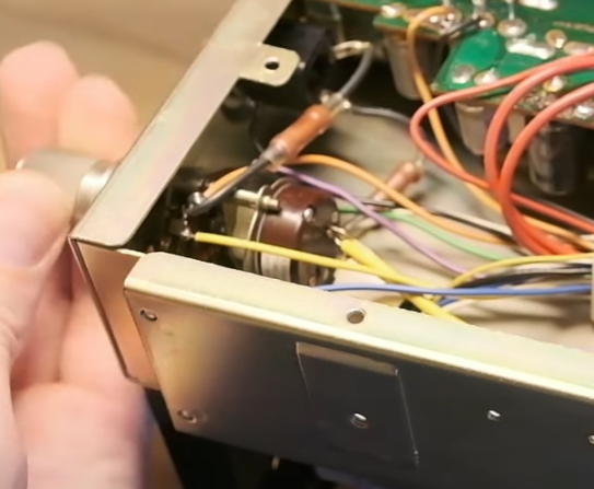

switch that I bypassed A, B, A+B, I think it does not have any circuitry on it
it looks like this:

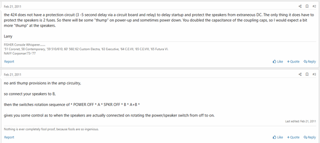

also on other forum i found this:
