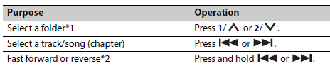

I have a Pioneer DEH-S2700BHS car cd player. The player has a forward and fast-forward (as well as backward) for moving fastly through a track or skipping to next track. I've recently ripped my CD collection on to a thumbdrive. Plays fine, however, the forward/backward functions remain as though I'm playing a single CD (i.e. I can't skip to a different folder or different ripped CD). My ripped CDs are grouped via subfolders by individual CDs. Is there a way I can organize my USB folder structure so the forward/backward player button moves by song within sub-folder and the fast forward/backward moves by sub-folder (i.e. by ripped individual CD)?

It seems this is not a matter or the files' organization. FF or FR are not meant to be used in this way. See the manual pages 11/12.
(more on page 12).
