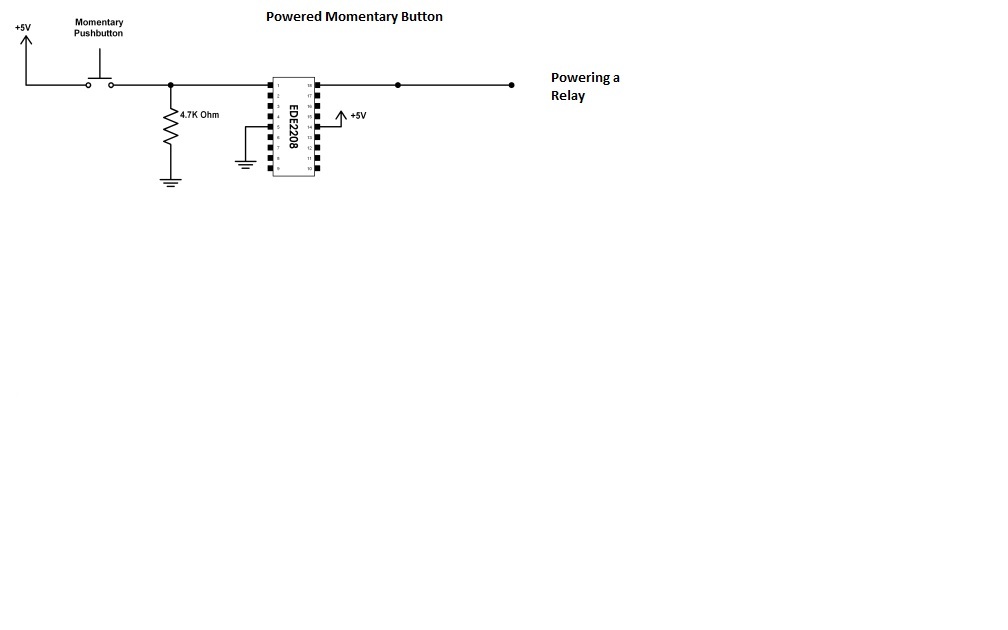

I'm using a EDE2208 turn a momentary button into a latched. I was able to get the IC to work normally using a 5V powered momentary button like in the diagram below.
I want to try to get this IC to be able to also operate using a momentary button that provides a switched ground signal. I tried supplying the input with a steady 5V and then having the switched ground button change the signal slightly when pushed. This worked fine, however upon startup the 5V input to the IC triggers it to output the 5V. I want to be able to have the startup output the 0V untill the button is pressed.
Is there anyway I could pre-process the signal from the switched ground button, so that at startup the IC wont send out the 5V?

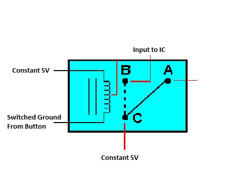

I'm currently using a 16.7 mA relay on the output, which operates fine with the IC. Unless I missed something in your response, my big question is how would I go about having a switched ground momentary button as an input.
Ive come up with an idea to use an unlatched relay for this situation on the input side of the IC. When the switched ground button is pushed, it will trigger the relay to ouput the 5V to the IC. At startup the IC will not see any voltage and revert to its low (0V) state output.
I'm going to be making this board in Eagle, so the more relays I have to add to worse off I am. The board is getting big and the component prices are adding up.
I'm a Mech E, so that is why I reverted to using a more mechanical approach. Is there any "prettier/more simple" approaches that I could take?

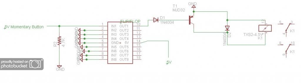

So, I got everything working on my breadboard. I sent the eagle file to OSH park and now the flip/flop isn't functioning properly. When ever i press the Momentary button the circuit actives, however when pressing the button again sometimes the flip/flop reverts back to 0V and other times it just stays at 5V. I disconnected the relay and the flip/ functions normally, so i'm assuming the relay is the culprit.
I measured the current the relay is drawing from the flip/flop to be 20mA, which is below the Max of 25mA for each output pin. So I tried using the transistor like you had mentioned, the only way I could get it to function was to wire it up like in the picture below. The problem persists though, the flip/flop doesn't always revert back to 0V on the second push of the momentary button.
(*steve*)
¡sǝpodᴉʇuɐ ǝɥʇ ɹɐǝɥd
Jan 21, 2010
25,510
Jan 21, 2010
25,510
You show ground is up and +5V is down.
Are you from Australia?
Also you show no +5 to the relay.
Check your wiring carefully and compare it to what you used on the breadboard.

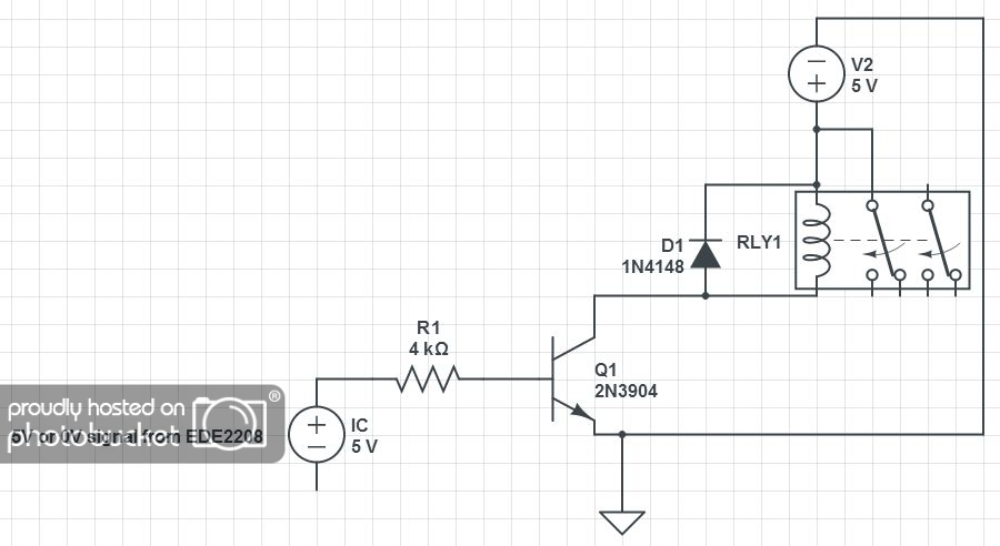

I did some research on NPN transistors last night and I think I've figured it out. My only question is in the schematic below:
a) Is this correctly wired?
b) How does the relay coil get grounded, it seems like the collector would be outputting a voltage signal not a ground signal?
Also would a PN2222A transistor work for this application?
I really appreciate all the help Steve.
(*steve*)
Jan 21, 2010
25,510
Jan 21, 2010
25,510
Well I knew one of us was from Australia! :D
That looks much better. You don't show the -ve of your left voltage source connected to ground, but I trust that is an oversight.

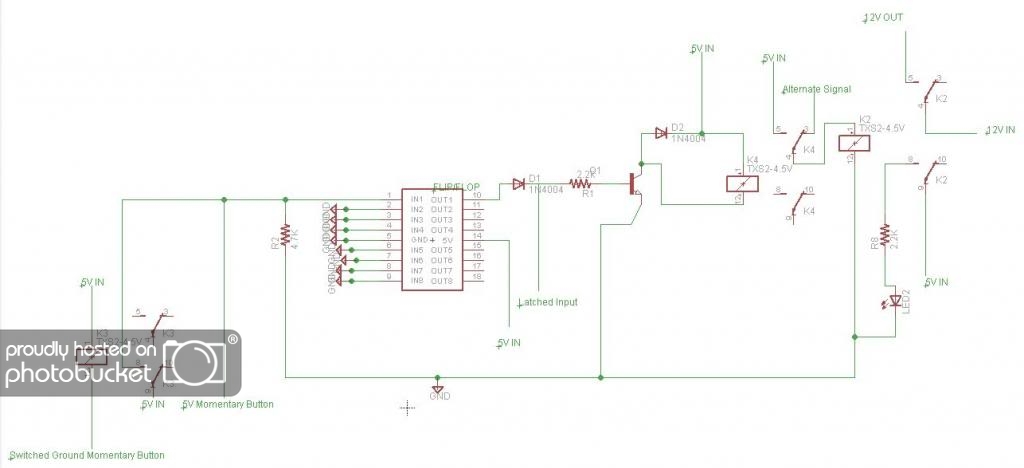

I feel like this would be easier than trying to take a picture of the small PCB. This is a section of the eagle file I made.
