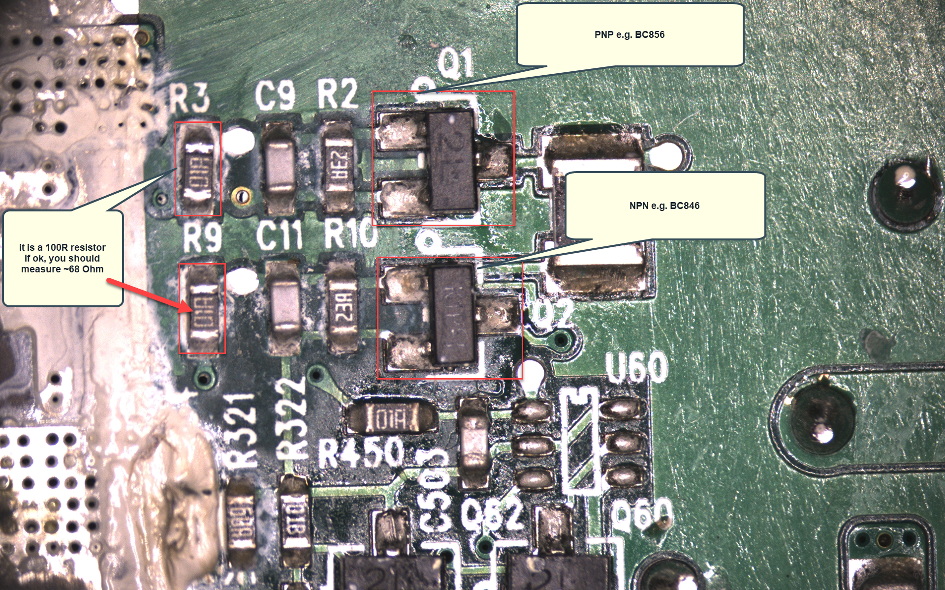

I had a 2nd XL amplifier board on my work bench which had burned MOSFETs and 0,047 Ohm resistors on all 6 output channels. In addition some small transistors and 100 Ohm resistors on the other side of the PCB were broken as well. The following picture shows the componets in question:
Beside to the Power MOSFETS all these components are part of the current sense circuitry.
You should check all these resistors and transistors (4 per channel) and replace them if they are broken! If you just replace the MOSFETs and current sense resistors (0,047 R) they might blow-up again as long as the current sensing and thus limitation doesn't work properly.
Finally I got my amplified back to live but it took a lot of (micro) soldering work. Unfortunately the 7414/7415 MOSFETs are currently not available (i still got some on eBay in February) but I think you can find compatible types (>= 60V Uds, <100mOhm Rds and ~5-6 Ads).
