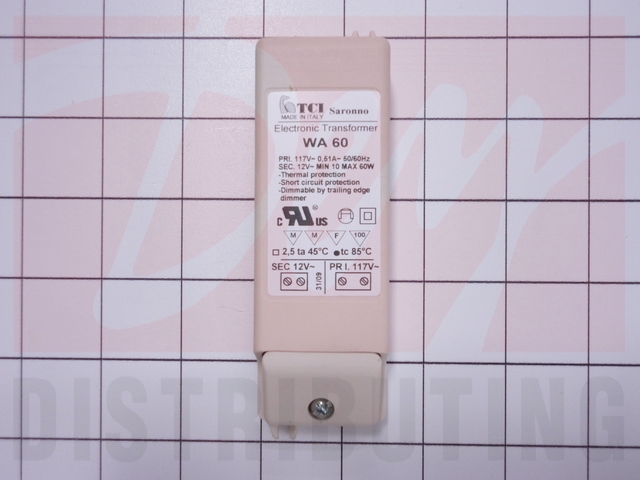

Transformer on range hood died, so that the two 12 V halogens quit working. Fan unaffected, still works. My question is whether I can replace this original:
480
with this much less expensive transformer, also from a range hood, different brand:
If not, why not? I ask here, rather than on an appliance repair site, because I trust that here I can get a real satisfactory, explanatory electronicsy answer, rather than a perfunctory, "No, is difrent. Want burn down hoose? lolz."
hope the pics provide needed info. FWIW, the lights on the range hood do not dim. Simple on and off switch.

If I read it correctly (it is a bit fuzzy) I see the original is 12V 60W which is 5A and the replacement you want to use is 4A. So, no you need a slightly higher power one.

In addition to Bob's answer above, you could use the replacement if you also replaced the lamps with 2 x 20W.

The original has thermal and short circuit protection. Do you want to lose these facilities?
Try repair if you can get inside.

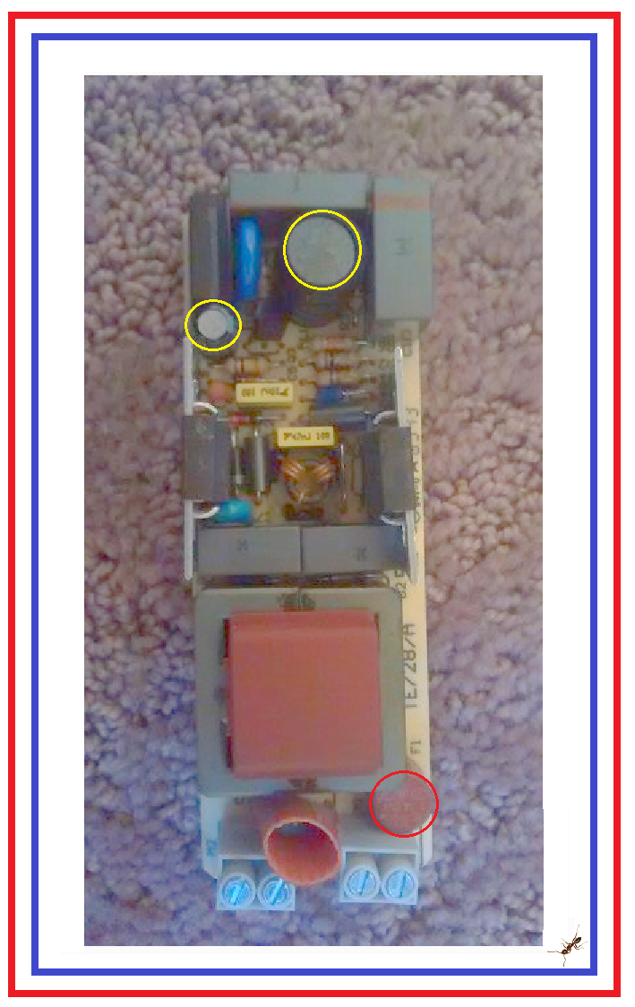

Thanks, guys. I guess this isn't a viable replacement. The original (no continuity) shows signs of heat on the backside of what I understand is the transformer. I think I'm going to go ahead and order the pricey replacement. But here's pics of the original's internals:

Sir Samaja . . . . . . .
Those photos should have been taken outdoors . . . . in subdued sunlight.
However . . . . . with my applying a little "NASSER" pixel dithering and time averaging enhancement, I can still come up with:
NOW I can see that the unit applies its created Hi Freq AC directly, as its output to the lamps.
Also you have a round, reddish brown special fuse as the F1 in the primary circuit of the unit, . . . see RED CIRCLE markup . . . .about 1 inch up from its AC power input terminals.
Is it good ?
If it is good, then possibly you have merely experienced a "soft failure" . . . with a time/use related warming up of the two YELLOW circled electrolytic capacitors and their slow degradation of their capacitance on down to a gradual non operational state / threshold.
Its worth a mere couple of bux . .to confirm that . . . . with their replacement . . . .use 105 deg C temp rated units for longevity..
