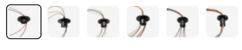

please explain the different number of channels what does it mean i found slip ring motors and hollow center etc but what is 4/6/12 wires?

what is the difference. sorry i am learning something new. what applications can be done with 2/4/6/12 channel/wire motors
what ditfference does the number of wires make? can i connect more lights etc?

Yes you can.
They are different circuits. However, depending on the overall current requirements, you may get away with a single circuit.

its anx mas tree base, big and bulky and i cannot design the crowns lights thats why i wanted to create one all on my own
now i am struggling to understand the # of wires on the motor. what do they do and how do i connect my lights etc to them

can someone explain what menas 4/6/12 etc wirs
what can i do with them

post 25 isnt an naswer i dont understand
i have the motor
one end all 4/6/12 etc ar all connected to one plug
all the rest on the ring that turns
lets say 12 wires, i can add 12 electic led strips or 6 because each connection needs 2 wires?

That is where the data sheet for your motor is very important.
You need to know the primary voltage and the secondary voltages. And if it shares a common ground. It may have secondary taps at different voltages too.
Can you share the link for your motor?.
Also, what LEDs are you wanting to use?. Voltage? Current? How many?.

correct i am a hobbyist and the most electronics I know is 12v strips, lights motors and fountains.
it seemed to work well till now
for the Holidays I built a lighted crown that hangs from the ceiling that slowly spins. I made it 7 branched for the 7 sheepherds (7 days of the week) to get it to slowly rotate between 1-20 rpm I used a rotating xmas tree holder however i hung it form the ceiling in an upsidedown fashion
it works well however a- its really bulky and takes up extra space, b- its the wrong voltage its 110 and I really need 220 c- it now turns ccw so my words kind of rotate backwards
i want to design a newer fancier better lit crown but was wondering if i myself can make the motor and holder so it better suits my need
since its foam core plus fabric it doesnt weigh more than 10-15lbs

i am sorry
i am coming back to this
i have my crown, 2 feet x 2 feet
lit with led lights rgb strips and individual mini lamps
all 12v maybe 10 pounds weight at most
i would like it to revolve
please advise what i need with motor and slip rings
i need it to be cost effective
please advise

hi
i am still trying to do this and not succeeding
my hut is a sukkah. i do all the decorations on my own.
i made a new crown, it weighs between 5-7 lbs
i wired it with 12v lights it has an adaptor to 220v
i need this crown to revolve
please help me design a "DIY rotating tree stand 220v" using slip rings and motors that are reasonable priced (till $50) using slip ring and motor
thanks
the ready made tree stands are too big and bulky
