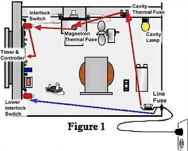

The wired circuitry, less the timer board, basically relates to these interconnects.
Basic AMANA problem spots:
