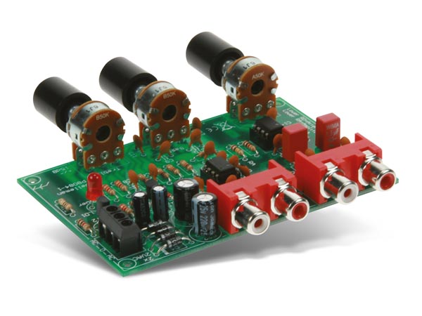

That's my project for october :)
I built a K4003 (click to enlarge) last month:
As you can see the volume control for the cd-player is fixed on a breadboard.
I don't like that so this week I am going to build the K8084 to make a proper volumecontrol.
http://www.velleman.eu/products/view/?id=369464
I want to put them on the same transformer, so I don't have to buy a second one.

Ok, this is the end-result :
(click)
And not to my surprise there was a big hum audible, so I was thinking, ****, I really am going to need a metal casing. Then I picked up the pre-amp and just by luck the hum disappeared so I figured the device needed some grounding.
In the second picture at the right upper corner you can see I attached a clipwire to the mounting hole and the other side of the clipwire is now connected with the metal table-leg and everything is working fine. I am glad with that because I don't want to spent money for casings and such, this is only to experiment before I start with bigger amplifiers.
There is another thing that came as a little surprise; in the manual it is advised to first put power on the pre-amp and then on the amp. That caused some trouble because I am using one trafo for both.
In lack of a proper switch I took another clipwire and connected it between Va and the trafo so I just needed to unclip it and then the power would be disconnected.
Well, that didn't happen, even with Va disconnected the music was still playing ??!!!
:confused:
It must have been running on one phase or something.
Here's a picture that shows Va of the amplifier:
