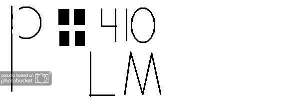

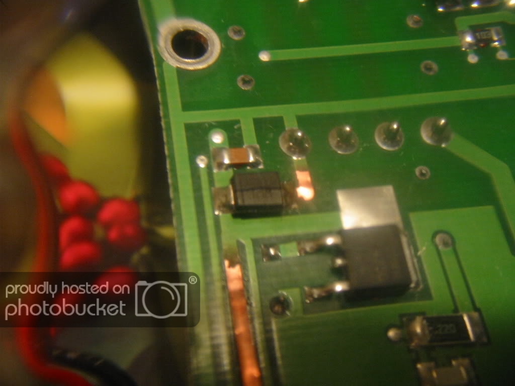

Hello all, I am in a bind with a pcb that got fried the other day.... I have identified several trouble spots that need repair: burnt out buck regulator :)eek: LM2673s adj - cant understand how that happened since its thermally protected), lifted trace off of pcb from heat and a cracked smd diode.
The diode is what I am having a hard time i.d.' ing can you help me out on this:
That is the best shot I could get with a magnifier, but I drew the markings from the chip:
Thanks in advance!

It could be an SMBJ15A Transient Voltage Suppressor (15V).
But you'll have to evaluate yourself if this could be correct.
Damage could be due to lightning or incorrect psu voltage.
(If the 4 pins in the pic is a rectifier I'd check it for shorts.)

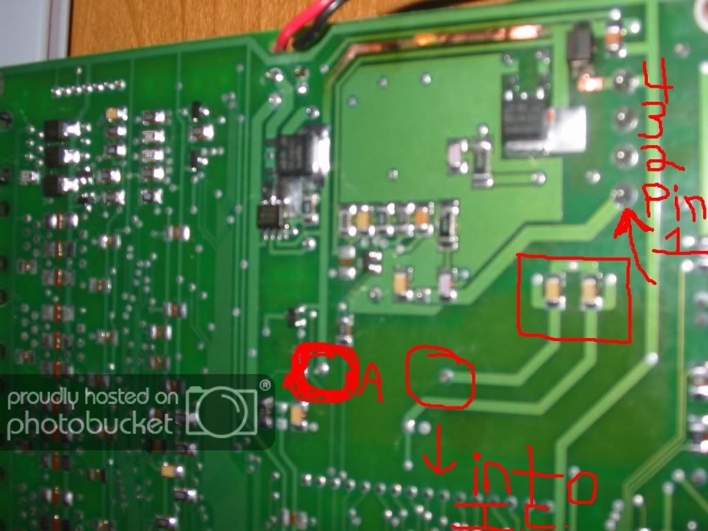

There's modesty for you ;P You must have some extensive background... I have very little and am honestly in over my head, but have great need to fix this device and to try and figure out what caused it!
As for experience, time and patience.... I only have the latter two...
I will answer the cathode question in the next post since I will post pictures to help illustrate the answer.
More pinouts for the rectifier:
pins 2 & 3 show 1940 mv in both directions? Can I assume that this is correct due to the rectifier's nature at the center of the bridge?
pin 2 and 4 (-) 1850mv forward and reverse - neg lead on 2 post lead on 4 500mv
pin 3 and 4 1865mv forward and 508mv reverse
As for the diode, I just wasn't sure that I could substitute it without altering the function of the board, but you make a good point, the only purpose is to act as a one way valve and to prevent backflow, so I guess it would be safe to use a higher rated part.
Thanks again :)

I believe pin 4 to be the ground pathway. If you look on the photo, there are some smaller 3 pin flat diode packages that have their heatsink soldered to this portion of the same trace. The trace continues on to the circle with "A" next to it. Here the trace passes into a power resistor and then to the red square which is a pair of caps, on the other side of the caps is a LM340S (other side of the board). From here it goes into a multipin ic. I hope this helps some. Let me know if you need more pics/info.
Thanks again :)

Wery well, the bridge seems ok then. The transformer is obviously not connected.
Measurements between the the center pins, and between the outer pins are not of vital importance since they represent two diodes in series, and they are covered separately by the other four measurements.
Now, I suspect there is a battery involved here, connected to the black & red wires at the top of the picture. I guess it could have been connected backwards, and this has made current pass through the power transistor above point A - via the burnt track - through the diode and into ground via bridge pin 4.
It is the components connected to this track that might have been damaged.
I guess bridge pin 1 supplies a charging circuit for the battery.

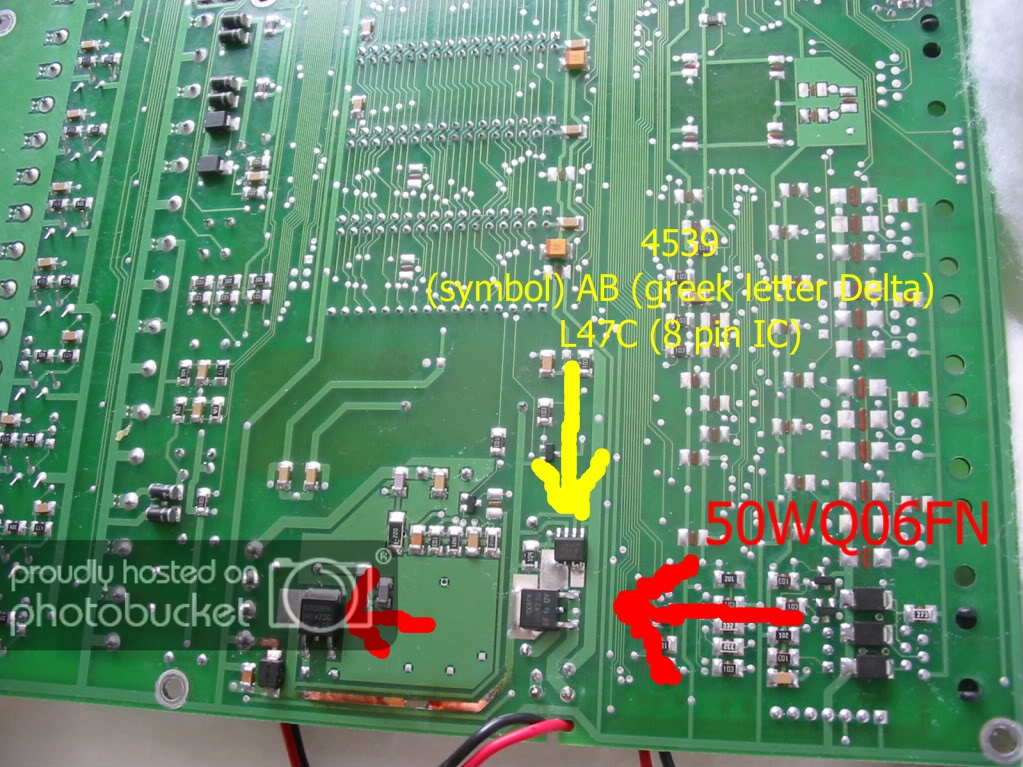

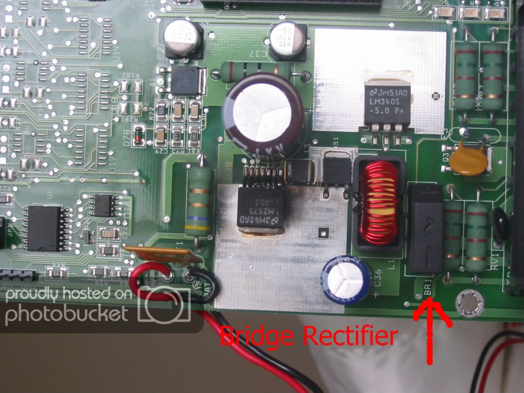

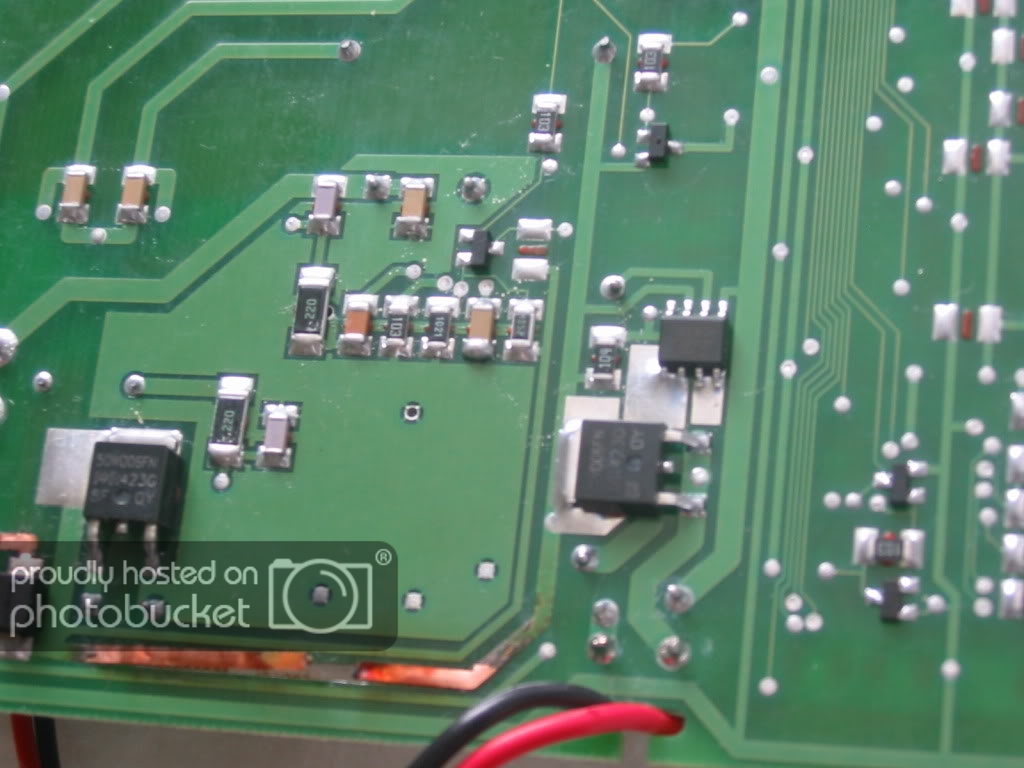

Back side of board with description of chips
closeup of backside
Front side of board around power regulator ic LM2673, LM340 is above coil.

I had to both chew & sleep on this one..
I doubt that a small sounder would overload the regulator, and that thin wiring could be blamed also.
Thin wiring & its resistance would only serve to decrease the current draw.
The charging of the battery places a much more variable load on the LM2673.
Unless you dropped some wire clippings on the LM2673 shorting it out, I lean more towards static discharge damage or just coincidence. It's supposed to be very overload & short circuit proof. It's good for 3A dc out, and the datasheet suggest a 4.5A peak limit whereas this circuit sets it to 3.7A peak.
Nevertheless, whatever made the LM2673 fail, it shorted out and delivered the full raw voltage to the battery which absorbed most of the current - even if protected by F1. Then the track failed and the poor little transient diode got the full voltage, releasing its magic smoke quickly.
Did you check out D51 btw.?

How did you determine that this circuit was limiting the lm2673 to 3.7A? Is it by one of the other components value?
What part is F1 referring to? I see it on the pcb near the wires that charge the battery, but I am not sure what it refers to.
D51 is shot - 4k ohm reading on tab (cathode) and each leg, forward and reverse (its a 50WQ06FN)
The back of the board has another 50WQ06FN that is shot as well, its the one with the smaller red arrow pointing to it. 4k ohm readings forward and reverse.
The good 50WQ06FN on the back side of the board with the large red arrow shows 125k ohm forward on both legs and 5k reverse
Also between the lm2673 and d51 is a part marked "13" any idea what this is? A continuity test of both sides goes to 0 on the meter, and I get a reading of 0.3 ohm forward and reverse.

The resistor under the LM2673 marked 103, connected to pin 5, determines that. The datasheet suggests using 8.2k instead of the 10k used here.
If you tell me the numbers on the last resistor in that row I can tell you the output voltage.
F1 is the yellow device, a PTC self-resetting thermal fuse.The markings on it will reveal the rating.
If D51 were the first thing to go, then the pulse current could have risen too fast for the protection circuits to shut it down in time. The output transistor would short out and dump the primary energy, overpowering D51 & the transient diode. Then battery current could flow back through the now shorted transient diode, finishing off the track.
Beware that some suspect components might still be ok. The measurements can be a result of other components in connection to the one in question, so you'll need to do some desoldering to tell for sure. Sometimes I use a lab-supply set for low voltage & high current in parallell to the suspect component to see if it heats up or not.
The LM2673 is going to need a big, powerful, & temperature controlled soldering iron to de- & resolder safely. Snip off its legs first before desoldering the body.
The part "13" is just a ferrite core. It's probably just 1 microHenry and should measure 0 ohms. The task of it is presumably to reduce ringing & risetime of the switching current.

The last resistor under the lm2673 was marked 1052. The yellow thermistor? is marked:
Line 1: B
Line 2: R400
Line 3: 5021S

The raw charging voltage from the regulator is ((1.25V/1020)*10500)+1.25V=14.12V
Subtract then a little drop through the 4.7 Ohm resistor and the 4539 dual N/P MosFet (8 pin "IC") and you get about 13.8V at the battery.
The B on The PTC is the Bourns trademark.
The R400 is the part number and also indicates that it's a 4A unit.
The 5 and 021 indicates it was made in 2005, day 21, and the S means it was made in China.
It'll stand 8A for quite some time, and it can take up to 12 seconds (usually 5) at 20A before it trips, so it's no wonder the track could burn before the fuse tripped.
