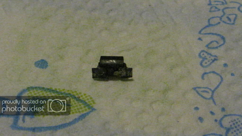

I powered the unit using a 9 volt, however, the unit was drawing 2A and was not lighting up, the puffed diode was getting hot and I disconnected. I did notice that the diode was loose and of it came! I don't know if the heat lifted the trace or if it was loose from the first go.
There is continuity at the fringe of each pad with the negative battery terminal. I guess when I can get a replacement part I can solder it back on and try again. I don't have any bidirectional diodes on hand so I will have to wait a bit and ask a friend who tends to have a bunch of parts on hand.

Ho-ho, that's a deep-fried diode allright..
You can always try to power the panel w/o that diode, it's only there to protect against overvoltage. Just to see if there's something more wrong with the panel.
The pads came off with the diode, and I'd rather replace it with a higher-powered leaded device anyway - hooking it directly to the power pins on the plug on the board.

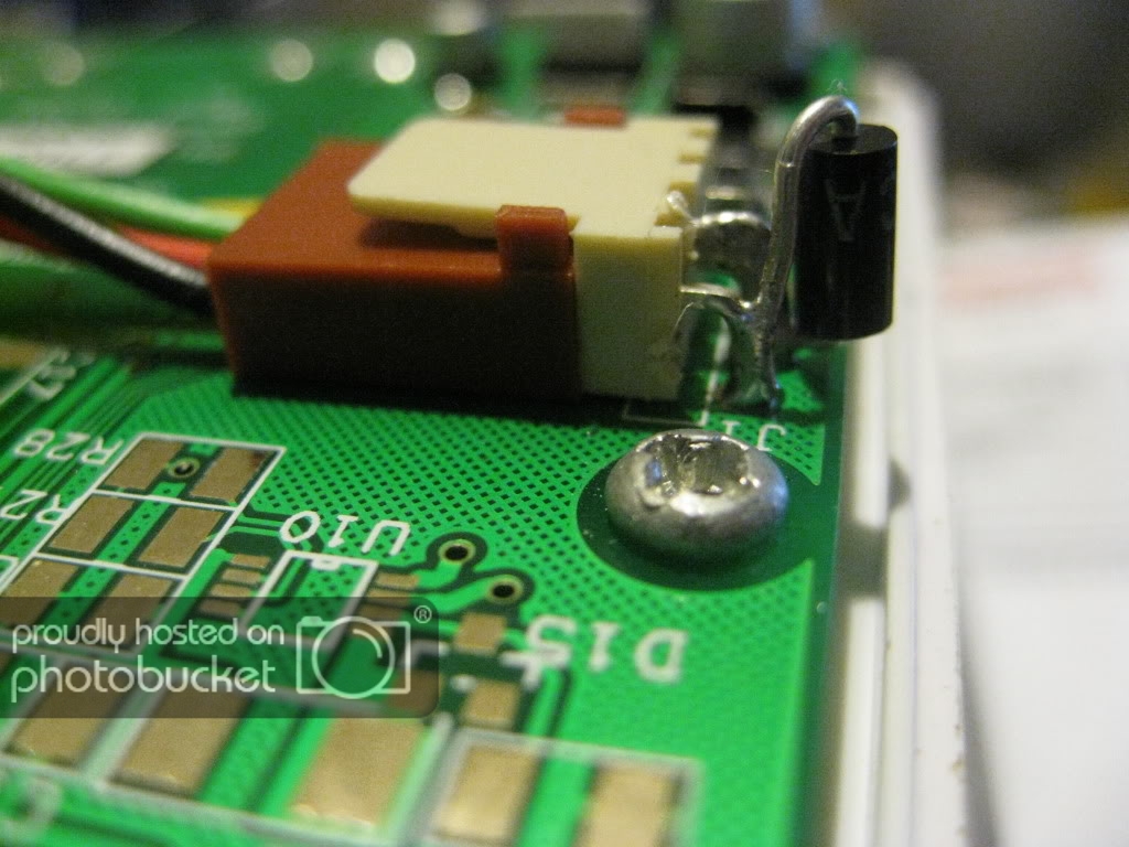

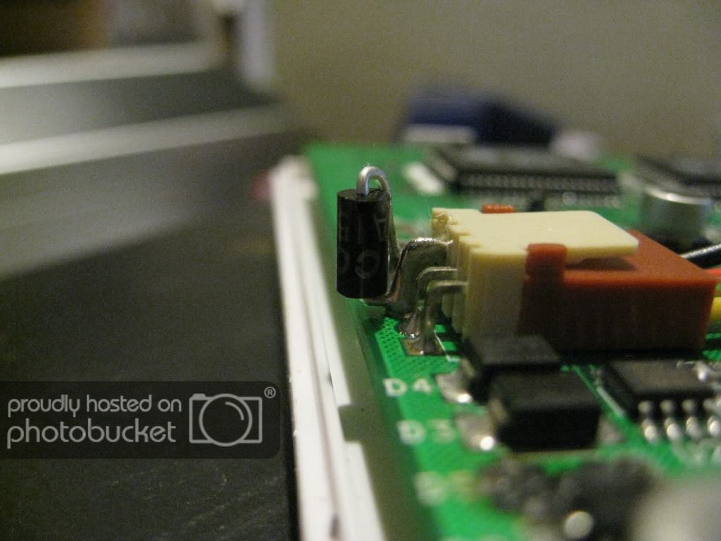

No forgiveness necessary I didnt give you enough information! :) It's a bidirectional diode, so as far as I know, there is no polarity. I also did a search via google for the schematics of a bidirectional diode, trying to learn a little more about what happens in that "black box" but I wasn't able to find anything. Does anyone know how exactly a bidirectional diode works? To me, it would seem that no voltage would pass in either direction because there are two diodes wired in series but they are each in reverse to each other.
Here are some pics of the mess. This was accomplished with a fat tip on a radio shack iron so forgive the crudeness...I didn't even have my pliers handy...eek. FYI toe nail clippers work fine for cutting leads ;0 I verified with magnification that there are no shorts electrically, no solder bridging, the leads are not even touching the diode packaging.

Oooh,. sorry, been a while since I read through this thread. (I guess I should've looked up that part number.)
A TVS diode, treat it almost like a zener. That guy should read as an open until you apply >= 15V to it. Then it will start to conduct. What kind of voltage are we talking about on those pins?
Edit: And hey, those joints don't look bad at all for a cheap iron! :) Nicely done.
And it's not exactly two diodes in series, reverse of eachother... it's two zener diodes in series, reverse of eachother. While one is forward biased, and passes current normally, the other goes into avalanche mode at a certain voltage and passes current.

Mitch got it right there.
I can't say why the panel would stop working with that diode in place.
Try to measure some ohms and voltages on the connectors, see if there's any breaks or shorts somewhere.
