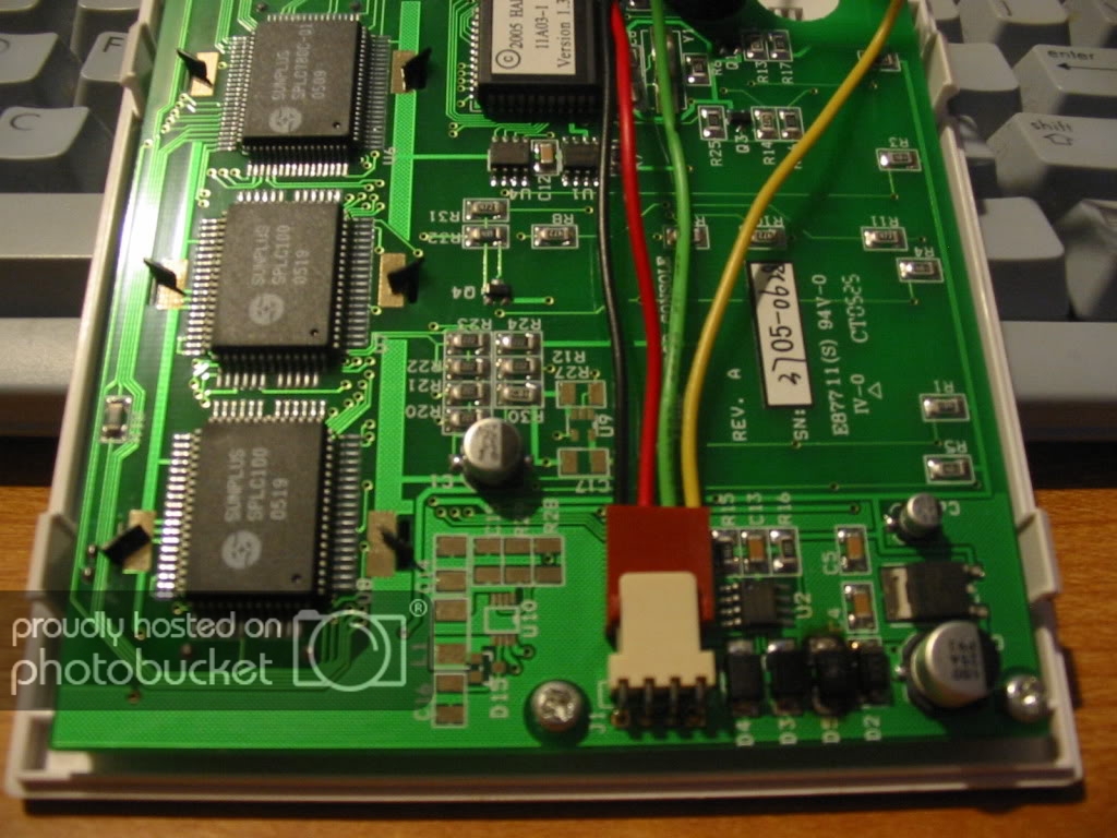

The plot thickens....

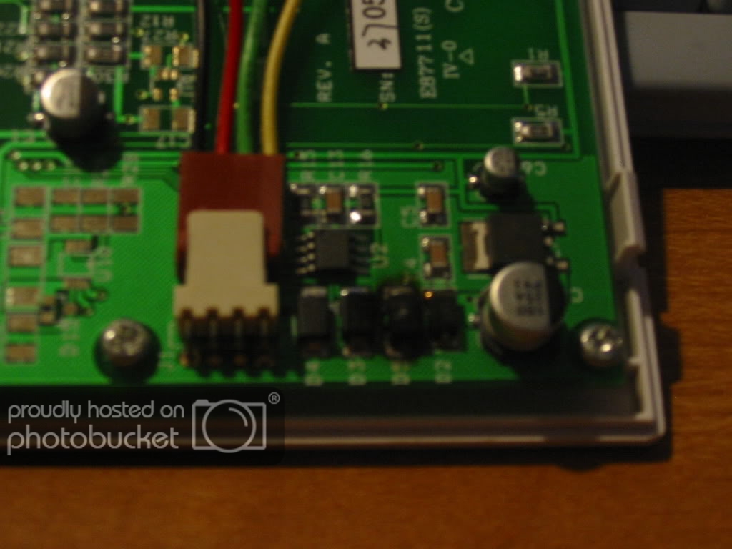

So, the F3 cap gets warm only with one specific keypad and not the other. I removed the affected keypad from wall, checked continuity on wiring (looped 2 pairs of wire, each had about 3.4 ohms resistance per leg) - ok. Backside of keypad shows a burnt diode! So that is why I am getting the F3 hot. It must have burnt out at the same time the mainboard blew out. The question is now, how they worked together to kind of see why that occured and to prevent it from happening again. This was not the keypad that I was using when the board blew so it wasn't like it was actively being used to draw more current. It is about 30ft longer of a wiring run than the other keypad. The diode that blew on the keypad is a smc made by General Semiconductor with markings of BM then directly underneath that 45 and the General Semi logo. I have asked DigiKey to id the component for me because I couldn't find any more info on it as far as what would replace it.
Here is a photo of the keypad
A close up of the damaged area, I couldn't get it clearer but its D5 that is burn out.
One side of D5 has continuity with the red lead. The black lead has continuity with D4,3,5 on the side closest to the edge of the board.

Always nice to find the reason behind problems. :)
I find that it's practically the same transient protection diode as on the main board.
SMBJ15A = SMBJ15CA = SMB = LM = BM
Being connected across the power (?) confirms this function.
You say you looped 2 pairs of wire for measuring, each having about 3.4 ohms resistance per leg. Does that mean the panel in normal use sees 3.4 ohms worth of wiring for its power supply? This would give a short-circuit current of 13.8V/3.4=4A.
But if the diode is shorted how could the panel work? (Or did it?)
I don't see any switchmode regulator on the panel btw., only a linear one if that's what it is.

I am with you on converting the part number from the smbj15 until you get to the last step. I see it referenced in the datasheets to LM, but how did you make the last leap to BM. Also I couldn't see a marking to tell me where the cathode is, does that mean that the part is actually bi-directional?
Yes, D5 has continuity with the red lead on the interior side of the board while the black lead has continuity with the side closest to the edge of the board.
There where 2 pairs of wires coming in, so I looped them to create continuity and tested back at the main panel. There was continuity and the total reading per pair was 3.4 ohms or 1.7 ohms per leg. (i.e. red lead would have 1.7ohms resistance and so would the black lead)
The diode is toast, but the odd thing was that the keypad still lit up and display looked as if it was receiving data from the main board! There was an alarm from the keypad when the unit was powered on whereas the other keypad did not set off an alarm, I assume to warn the user of a fault.
Yes, below C4 is a LM78MOS cdt. What are your thoughts on why you are asking about whether there was a switchmode regulator on the keypad or not? Were you thinking if there was one then the full power would not have been drawn onto the board?

As for the diode on the keypad it shows that it was shorted somewhat:
D4, D3, D5 the three diodes closest to the pin/wiring harness connector show the following on VOM set to 20k resistance check:
D4
6.09k forward 6.09k reverse
D3
7.15k forward 7.15k reverse
D5 - burnt diode
5.20k forward 2.24k reverse
All the diodes have the same marking of BM 45 (and apparently they are bi directional).
