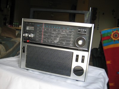

I found this radio and have been fixing it up because I think it it kind of unusual. It is a sony tfm 1600W
I have it all together and working but there is one thing wrong with it. It should be able to run off of either batteries, or plug into the wall. It only works with the batteries, when I try to run it off of the wall current it does not turn on
I have taken it apart again and it is divided up into nice sections. I found the circuit board that changes the voltage down to what it needs to be, and have removed it from the radio.
the thing that worries me is there are several very big capacities on it, and I do not want to get killed or any thing. what I am looking for here is two things.
First of all, is it safe to work on this thing or what should I do?
Second thing is actually fixing it. I am good at soldering and De-soldering, I just need to know what to replace and were to get it.

Pictures would be good.
From the look of this, the large capacitors will be low voltage (ou can confirm this by looking at the voltage rating) and will be mostly harmless.
Check that the correct mains voltage has been selected and also any fuse that may be present.
The fault is almost certainly with the power supply, althouhgh if there is a switch to select between batteries and mains power, that may be worth looking at too.
Do you have a multimeter, and do you know how to use it?

Well I took a look at it today. I have now am pretty sure that it is either the coil or the power cord (It looks kind of bad.)
there is the complication, the wires for the battery connection go through part of that board too. One of the things on the board that the batteries do not go through is the coil. I also see no visible damage to other components except the cord that looks kind of tired. I can not get the board that far out of the radio because it is connected with a few wires. Once I cut the wires it will not work with the batteries either until I put it back in. I can not get to any of the terminals for the cord, the coil, or any thing else until I get it all the way out.
there is no switch for going from ac to batteries.

I could not get at the power supply part of the circuit diagram.
Normally, the change over switch from AC to DC is built into the socket into which the power leads fits.
Start by measuring the resistance between the power connections at the plug with the lead plugged in.
If no connection, unplug the lead and check each wire in the lead for resistance.
Check the resistance between the two input terminals on the set.
If no connection, you will need to switch the set on or find your jemmy!

here are some pictures. I did get it all of the way out and labeled the wires on one of these pictures.
I have replaced the power cord (old on is still on in the pictures) because while it was still sort of connecting, it was not a very good connection. I have not put it back in the radio and tested it.

Measure (on the power cord) the transformer primary resistance.
Is there a mains voltage range switch?

I have a friend that bought it from me. They were able to fix it and really seem to like it so I don't think that they would sell it.
